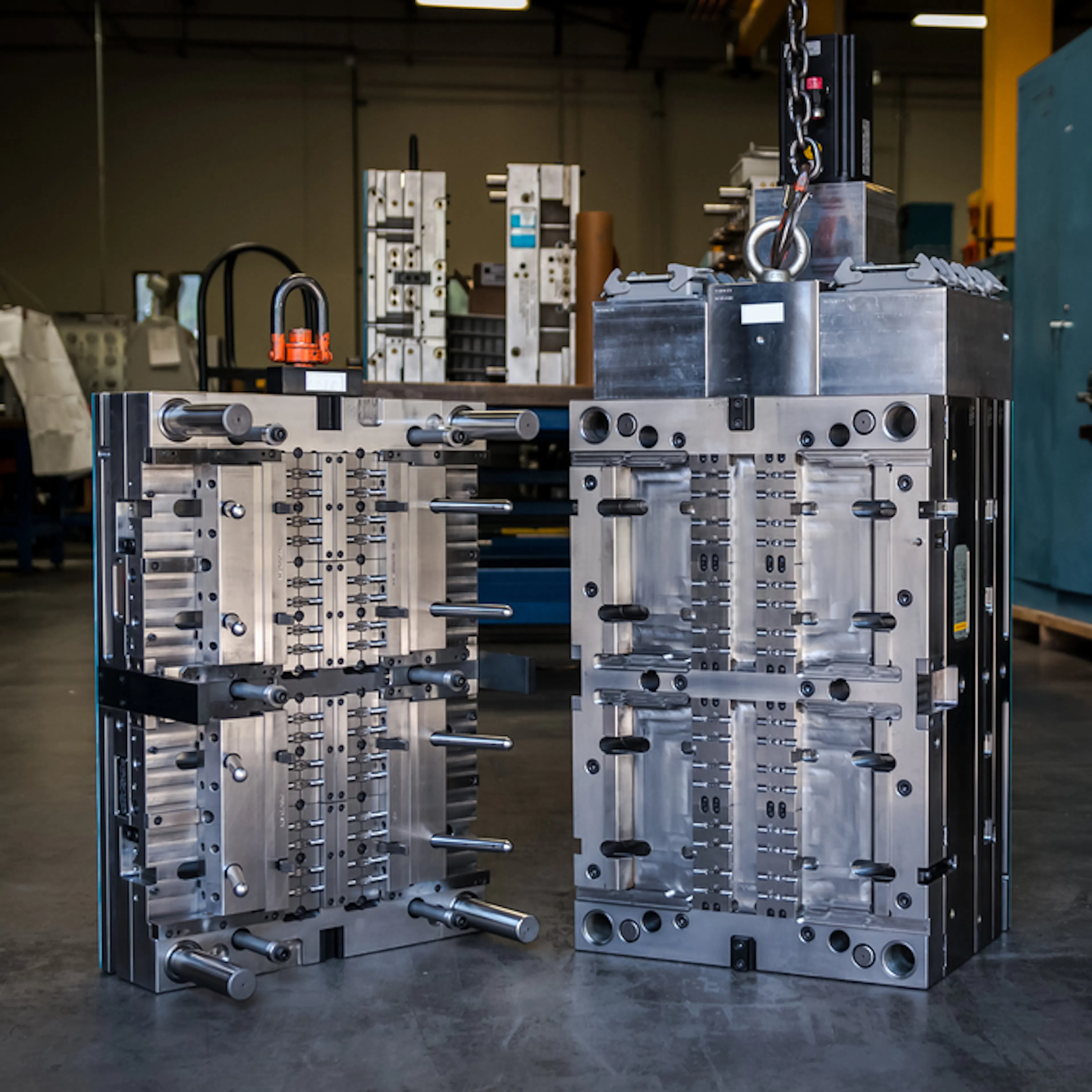

Hot runner mold. Image Credit: Shutterstock.com/Rogue Ace Photography
The hot runner system is one of the most recent advancements in plastic injection molding, and has pretty much taken over from cold running systems. Let’s look at exactly what these systems are, how they work, and where and what they’re used for.

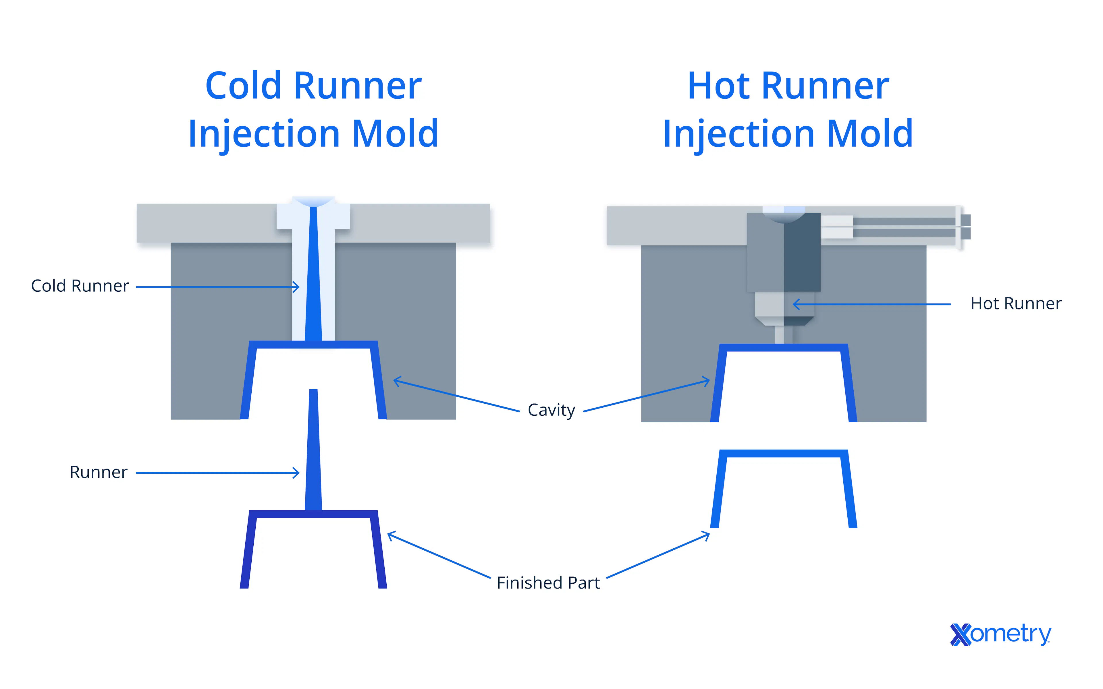

The main difference between hot and cold running systems is that hot runners keep the plastic molten inside the system, so there’s no need for extra material like runners, but cold runners let the plastic cool and harden, which means they need to be removed later (read: more waste). These differences can be seen in the image below.
cold runner vs hot runner mold diagram
Cold runner vs. hot runner molds diagram
