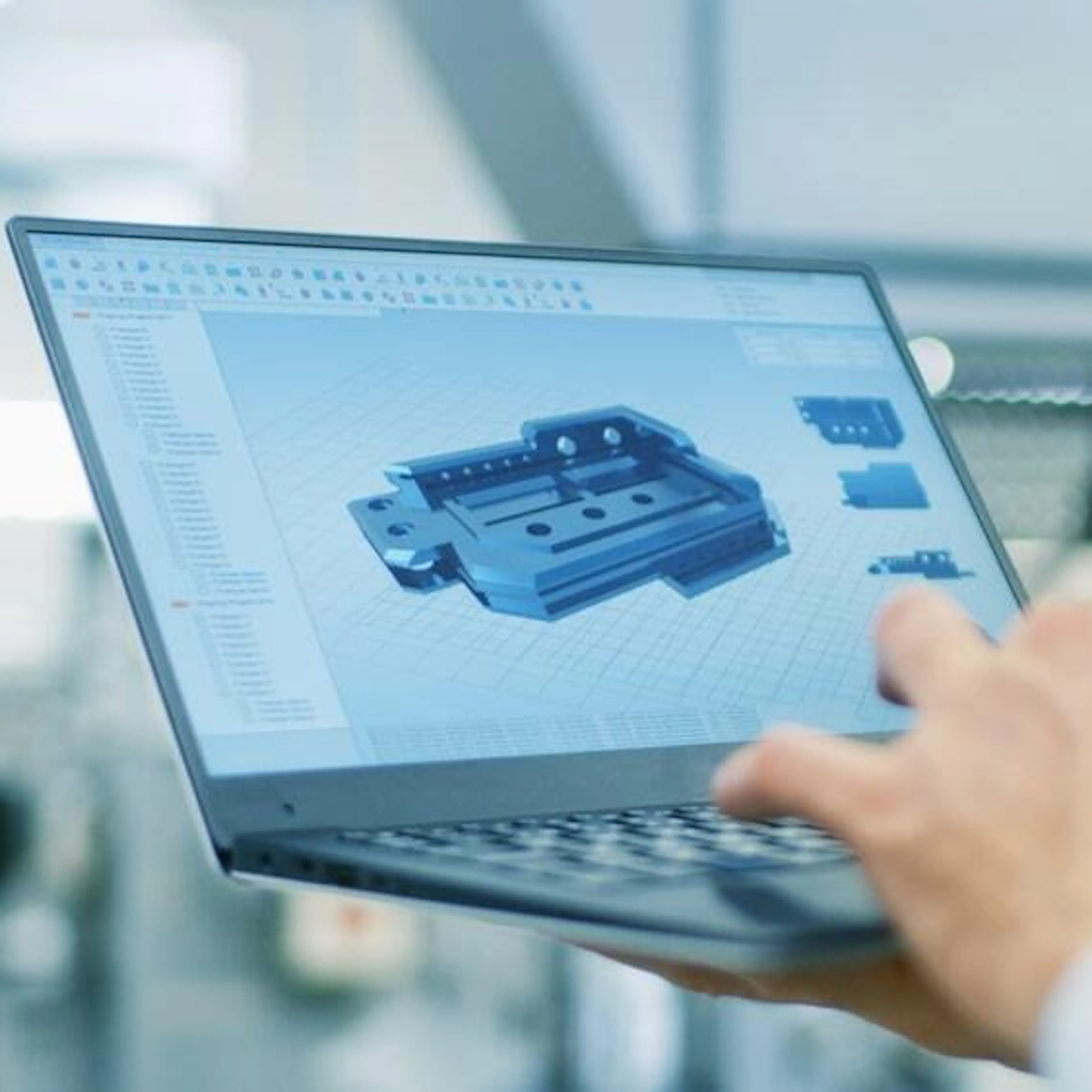

Engineer looking at a CAD design on a laptop. Image Credit: Shutterstock.com/Gorodenkoff
The design process for CNC machining requires precision and accuracy to produce quality designs. This is why there are recommended general design rules that apply to the most common features of CNC machined parts.
