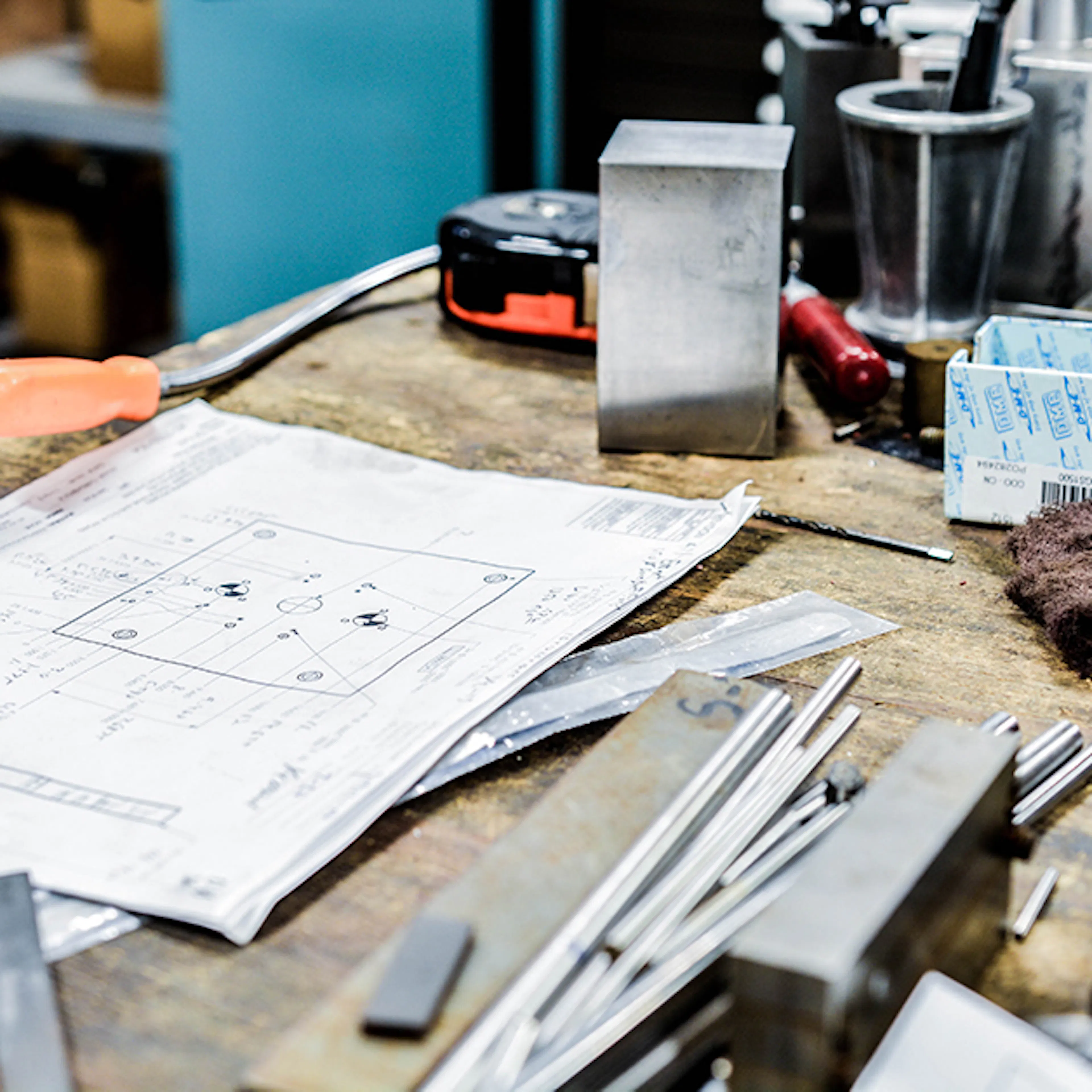

Clear 2D
A DFM ready part starts with a clear 2D three-view drawing. What makes it clear? It needs to provide all the details and information your average machinist would need to make the part, including:
  • Material type
  • Tolerance range
  • Surface finish requirements
  • Plain and tapped hole sizes
  • Clear dimensions
Sometimes, designs are particularly complicated and require more detail. If your part fits that bill, be sure to tell all. Extra tight tolerances, specific features — whatever it is, note it and explain it. It’s better to overstate than pay for a batch of parts that look just like the design you provided but nothing like the design in your head.
Crystal Clear
Clear dimensions don’t happen by accident. All features of the part should be measured from a common point to guarantee every one of its critical features is properly placed. When a 3D part file’s measurements haven’t been taken from a common point — e.g. one feature is measured from the left top corner and another is measured from the right — tolerance “build-up” can occur so that the parts that make up your overall assembly no longer fit together.
