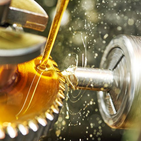

Milling a gear wheel. Image Credit: Shutterstock.com/Dmitry Kalinovsky
The term “gear cutting” refers to the various methods that are used to make gears out of gear blanks (a block that looks like the final gear shape). In this article, we’ll explain exactly how it’s done, the various processes, and also the different types of gears you can make.
What is Gear Cutting?
Gear cutting is a process used to make gears. It works with a cutting tool that’s mounted onto a milling machine and cuts one tooth at a time. There are many different types of gear-cutting processes used in manufacturing to make various gear types, and they all work on the same basic principle: giving a gear blank some teeth so that the gears can lock with one another to transmit a rotational force that makes them go round and round. Despite being limited when it comes to certain features and sizes, gear cutting is a fast, precise, and cost-effective way to make a gear, and allows you to make many gear types. Sometimes, though, you’ll need special tools or machines. It also produces quite a bit of waste.
How Does Gear Cutting Work?
Gear cutting has a few different methods, but they all work on a similar principle. A gear blank, which is a block shape resembling the final shape of the gear, is given gear teeth using either cutting or abrasion. Cutting uses a special cutting tool mounted on a milling machine which cuts one tooth at a time, whereas the abrasion method uses a shaped grinding disc to abrade away material.

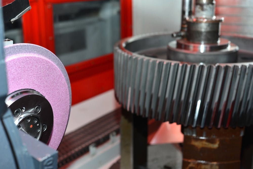

1. Gear Grinding
This method uses a rotating abrasive wheel to remove material from a gear blank; when the wheel makes contact with the blank, it transfers its profile into the gear. It’s a generally slower method and can be quite expensive, but it’s extremely precise. The image below shows you what gear grinding looks like. The pink wheel is the grinding disc, and the gear blank is on the right:

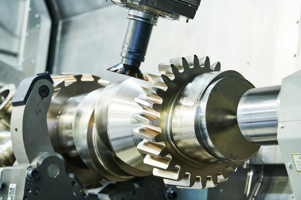

6. Gear Milling
Gear milling is done using a milling machine and a form-cutting tool, which spins to cut each tooth individually. After cutting each tooth, the cutter will move away, allow the gear blank to rotate, and then move back in for the next cut. You can probably tell that this type of gear cutting isn’t very fast, and so it’s best for smaller production runs. It’s also not very precise. It’s very appealing, though, when you need to make one-off, low-production custom parts without having to get special tools. The following image is what gear milling looks like, and the form tool is in the upper middle:

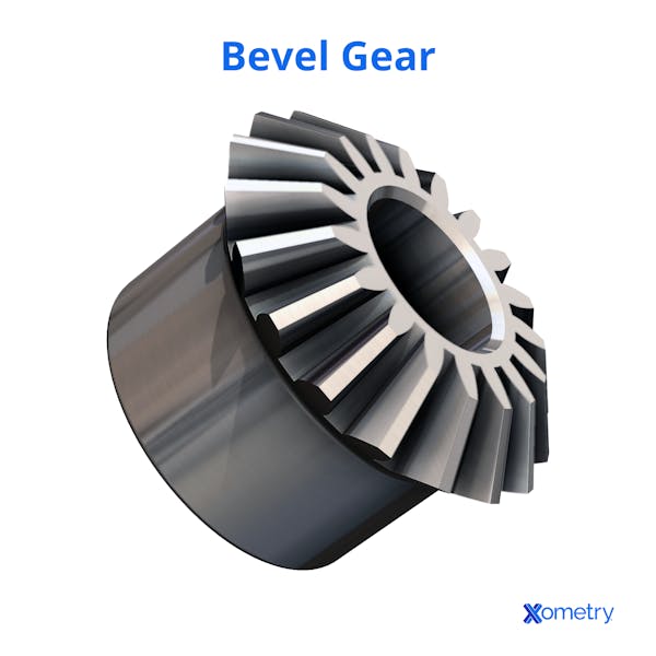

2. Bevel Gear
Bevel gears are designed to transmit power between two shafts with intersecting axes. Although bevel gears count as a single category, there are some subtypes including straight, spiral, zerol, hypoid, and mitre. They have a large surface and aren’t cheap to make. That’s why they’re often used in applications like power plants, transmissions, helicopter power transmissions, and vehicle differential gears. Here’s what they look like:

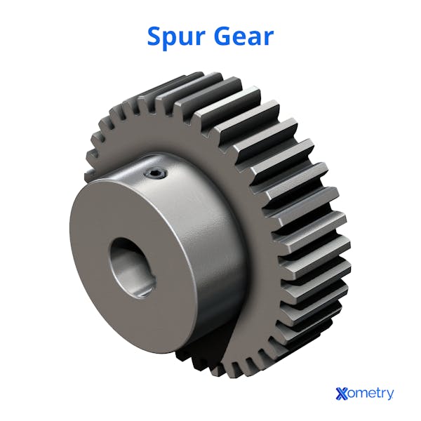

3. Spur Gear
Spur gears have pitched surfaces around their circumference. As you’ll notice in the image below, they also have shafts and teeth lines that are parallel to the axis of rotation. They’re the most common type of gear and relatively easy to make. They don’t have an axial load and are therefore commonly used in things like motors, transmissions, and machine tools. Here’s how they look:

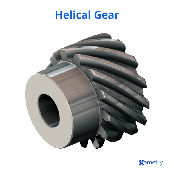

4. Helical Gear
Helical gears are somewhat similar to spur gears in terms of having pitched teeth around their circumference. The main difference is that helical gear teeth are not parallel to the axis of rotation, but wrap around the circumference. This helps helical gears transmit higher loads with less noise, which is why a lot of Xometry customers choose it for their high-speed applications. You’ll need to use thrust bearings with this method because the teeth are slanted and push sideways when they spin, creating an extra force (axial load). This type of gear is often used in elevators, conveyor belts, and earth-moving equipment. This is what it looks like:
