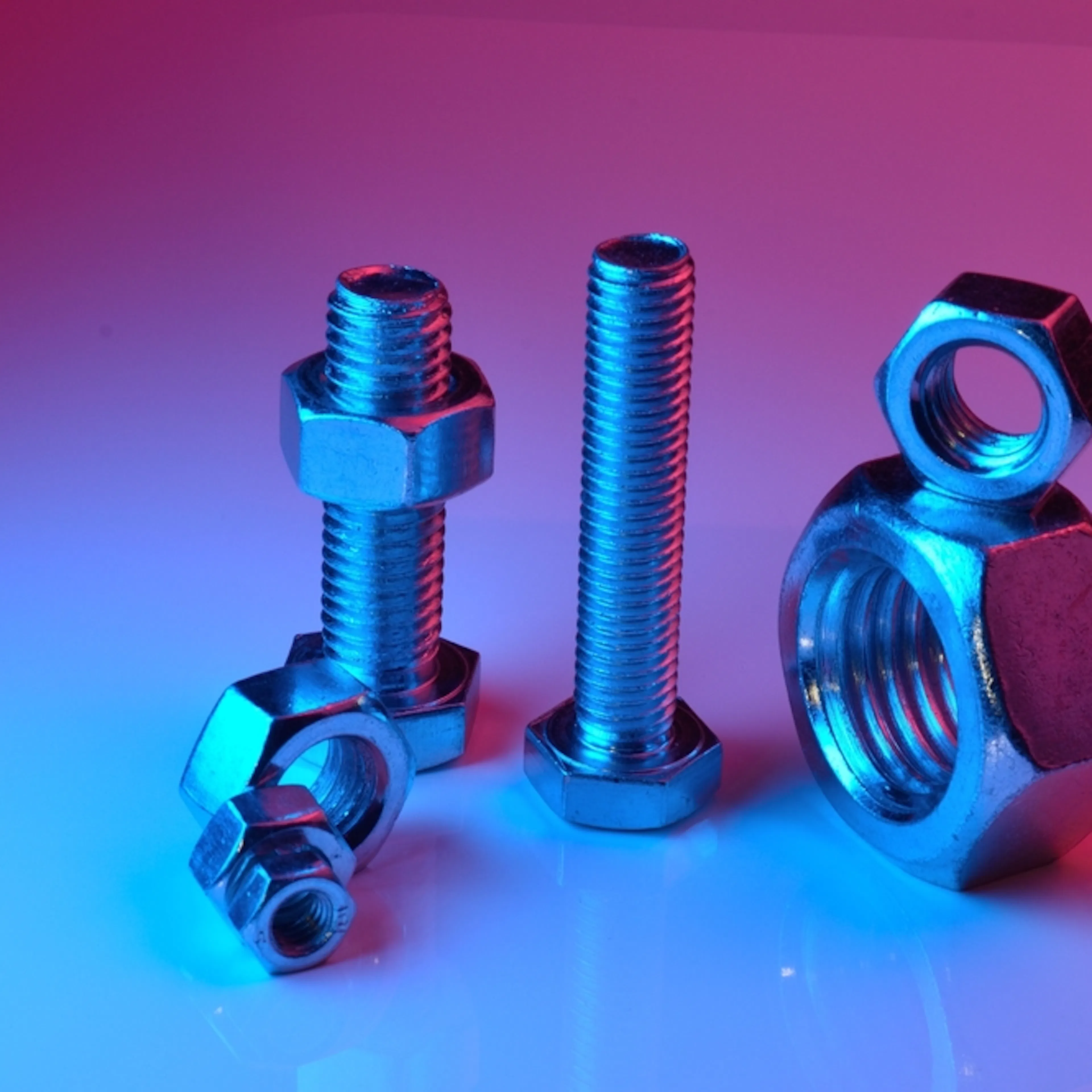

Titanium anodized nuts and bolts. Image Credit: Shutterstock.com/L-51
Titanium is a strong and hard-wearing metal with wide applications. Aside from this, titanium can be anodized to take on vibrant colors that won’t fade. This process, called Type III titanium anodizing, is capable of imparting a variety of monochromatic finishes to the titanium, ranging from bronze to blue, and even magenta and green.

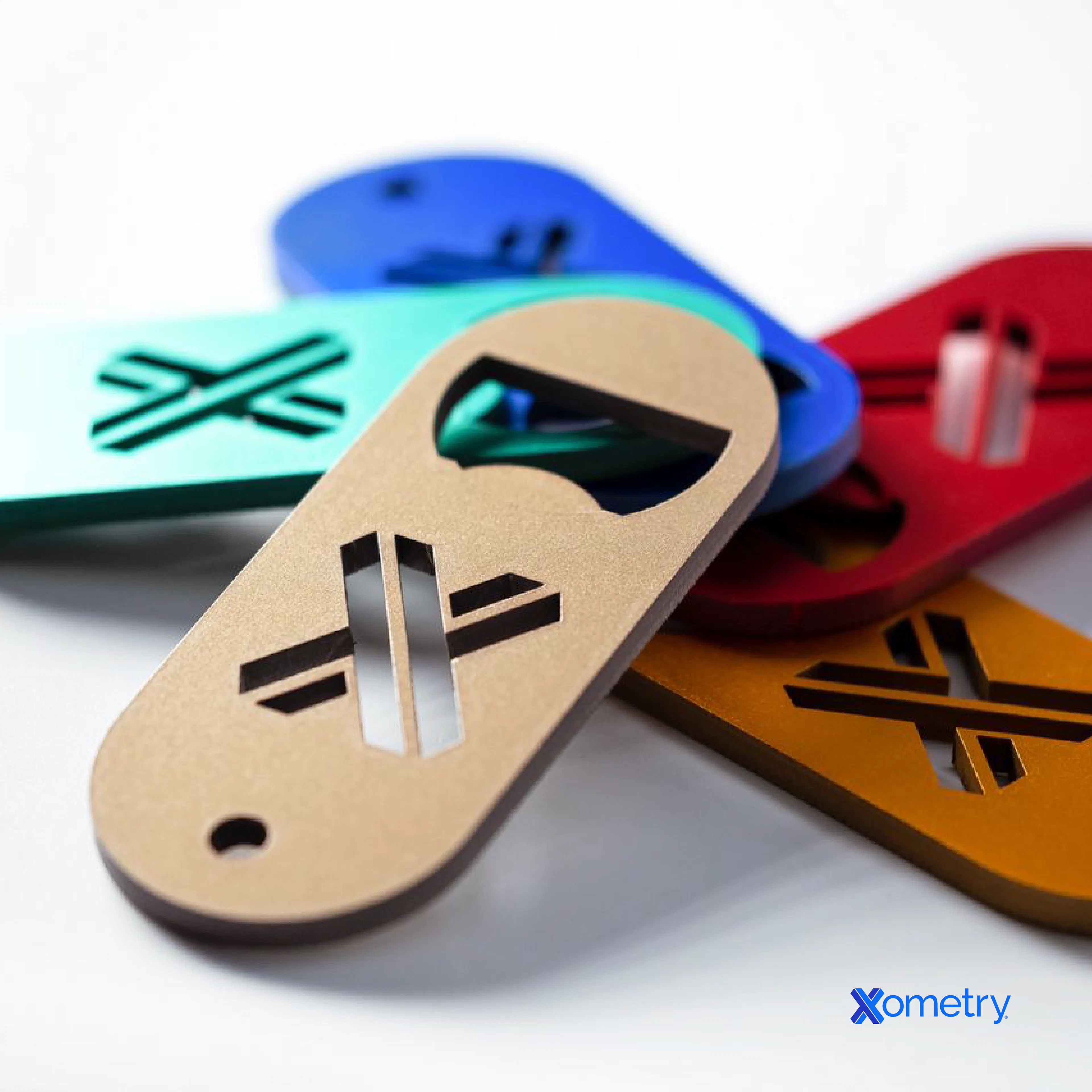

The available colors for anodized titanium are bronze, blue, yellow, magenta (pink/purple), cyan (teal), and green. The color of the anodized titanium depends on the thickness of the oxidized layer created on the surface of the titanium. Therefore, a range of colors is possible depending on the exact thickness of the oxidized layer created.
Colored anodized parts
