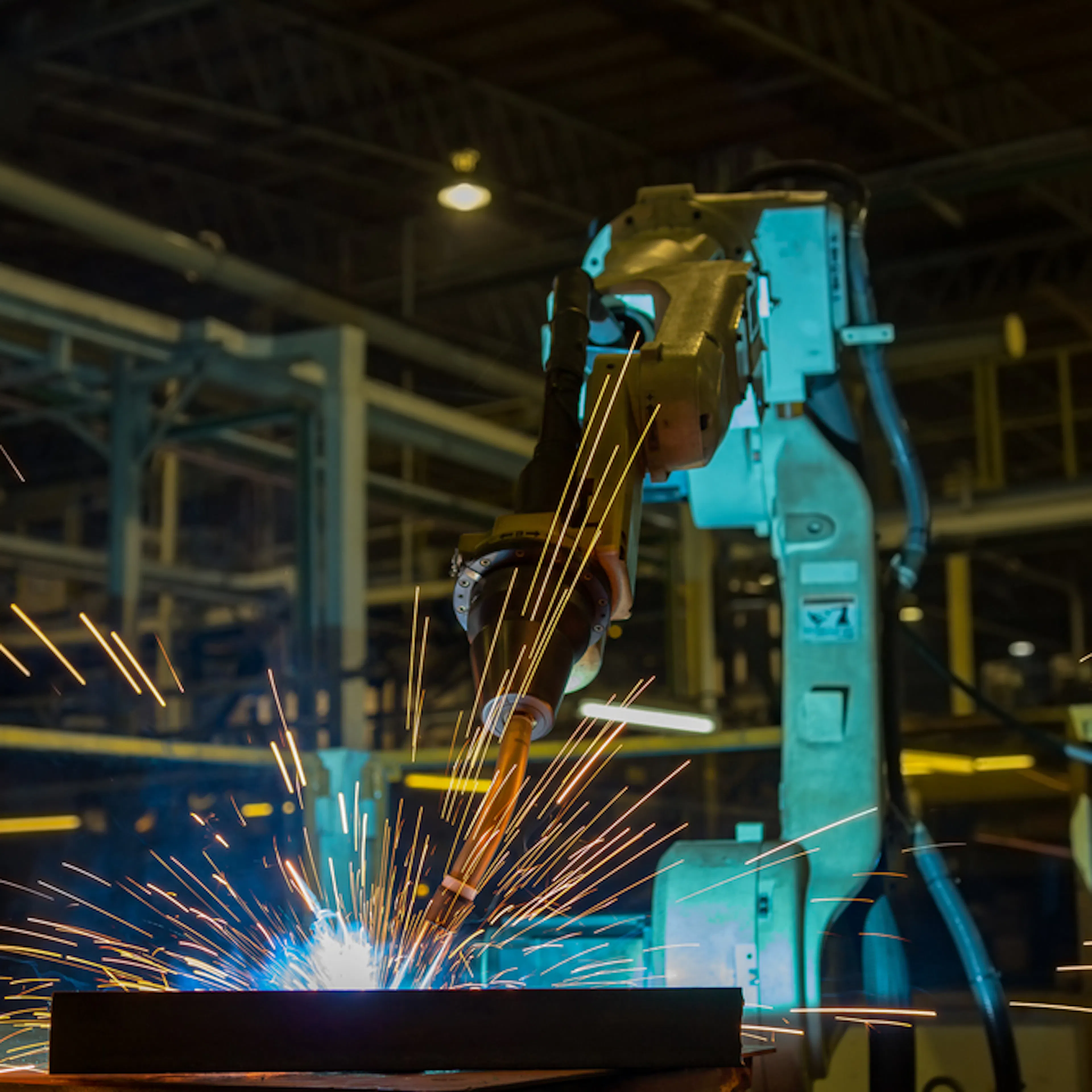

Laser welding. Image Credit: Shutterstock.com/Factory_Easy
Arc welding and laser welding are two prominent welding methods used in many industries for joining metal components. While both techniques create strong, durable welds, they vary significantly in heat source, equipment, speed, and power, all of which impact performance.
