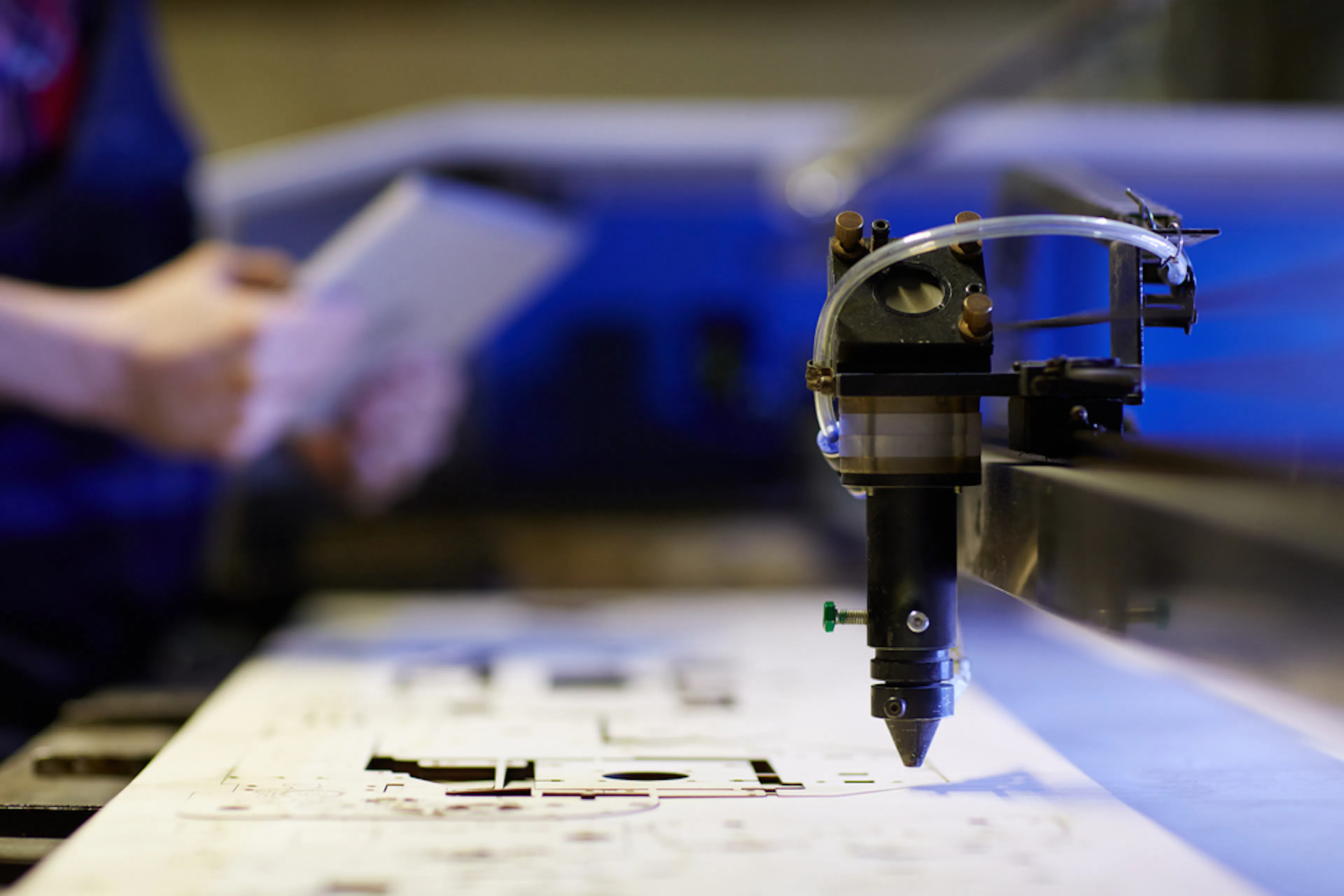

How To Laser Cut Stencils With Mylar
After you’ve designed the stencil and are ready to make it, the next step—and arguably the most important— is adjusting the machine’s settings.
"For really thin films, sandwiching the flimsier material between two pieces of more rigid (and less reflective) type of material can be beneficial by holding the pieces in place and usually benefitting with a better edge condition as well when done right."
Matt TopeliusDirector, DFM Engineering
Recommended Settings
The best laser cutter power and speed settings for Mylar depend on the specific machine you’re working with, as well as the material’s thickness. You’ll also need to consider the machine’s focus height (although most of them offer automatic settings), and how many times you need to go over it for a complete cut.
Below you’ll find the general recommended settings for cutting Mylar sheets with a CO₂ laser cutter. The last row provides specific settings for the Glowforge Pro, which, while also a CO₂ laser, has its own built-in software that automatically adjusts the settings.
Recommended Settings for Cutting Mylar
Process Steps
Once you’ve got your settings in check, the process entails the following three simple steps:
  • Converting the design image into vector format, which can be done with free software, i.e., Inkscape (you could also use designs that already come in vector format, like SVG, DXF, or AI, as these extensions make it easier to convert the edges into paths for the laser cutter to follow).
  • Securing the Mylar sheet to the base of the machine's cutting bed completely flat (any raised areas can mess up the edges).
  • Once it’s cut, you can take the stencil off the cutter and put it to use!

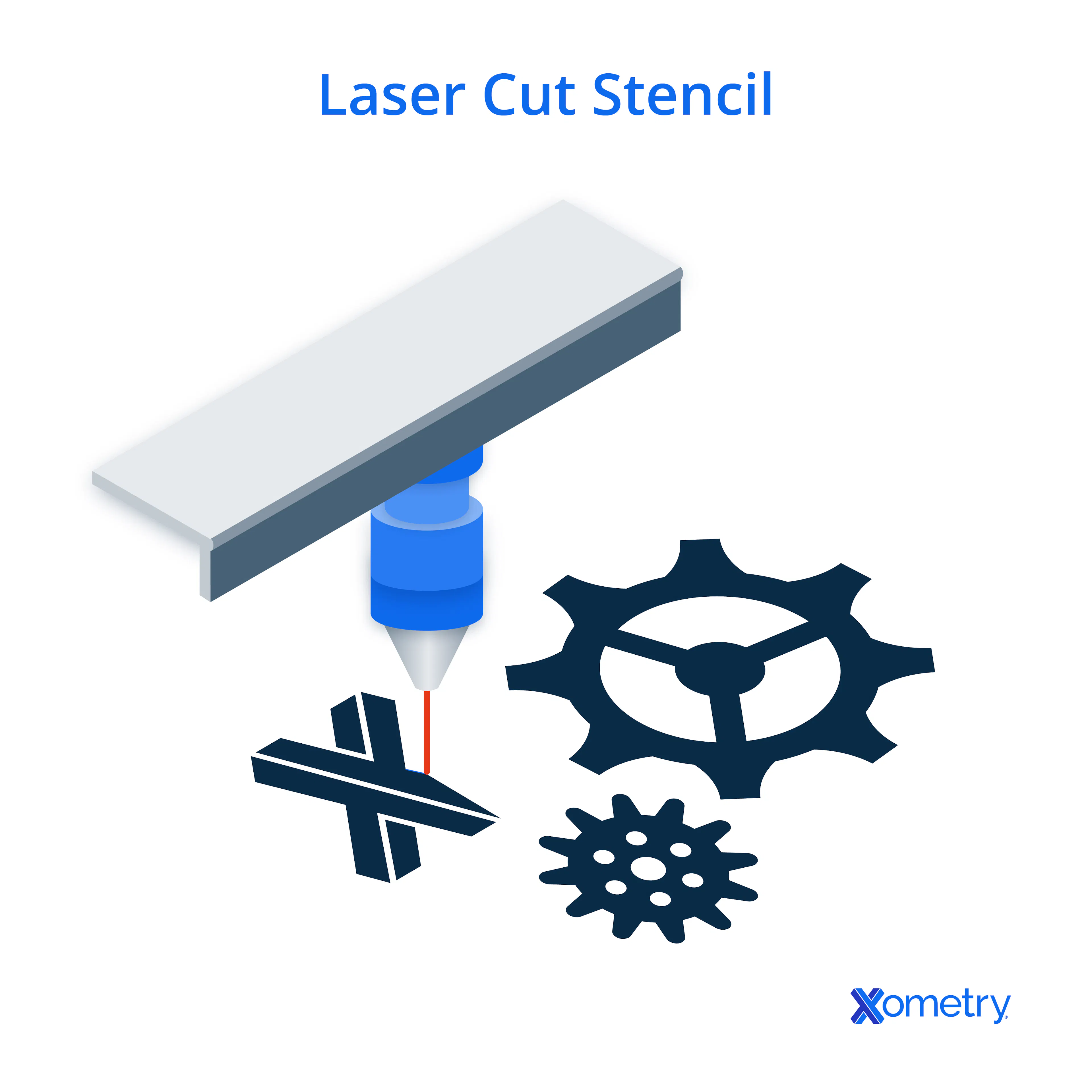

What Are Custom Laser-Cut Stencils?
A stencil is a template for reproducing multiple exact replicas of a shape or pattern onto a target surface. Stencils are usually made of flexible materials, such as cardboard, plastic sheet, or thin metals. The cut-out parts of a stencil are the design, while the remaining material acts as a mask. The ink or paint applied to the stencil creates the desired image on the target surface. Stencils are often created using a laser cutter, because a laser cutter produces the cleanest possible design edges, resulting in the best possible quality stencil and, ultimately, the final artwork.
