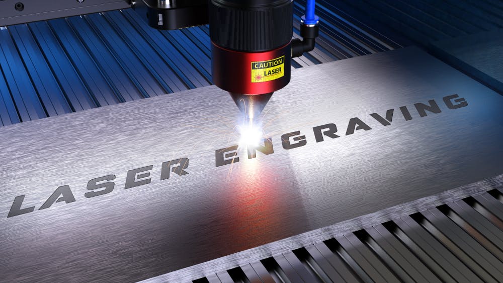

Laser cutter working on metal sheet. Image Credit: Shutterstock.com/Zyabich
