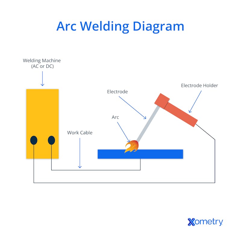

What is Arc Welding?
diagram of arc welding
Arc welding diagram

How Does an Arc Welding Process Work?
The arc welding process works by using an electrical arc to melt metal. An arc is created by applying a voltage across two separated conductive electrodes (one of which is the workpiece) until an electrical path is created through the air gap between them. One conductive electrode is the base metal workpiece; the other electrode is movable, either manually or automatically. The electric arc passing through the air between the two electrodes has a high temperature of over 3000 °C. This arc, therefore, heats the metal to be welded past its melting point, making a pool of molten metal at the termination of the arc. The edges of the two metals are melted, usually together with filler material from a consumable electrode, and they combine to form a single molten mixture. As the arc moves on, the melt pool cools and the metal hardens into a strong weld.
