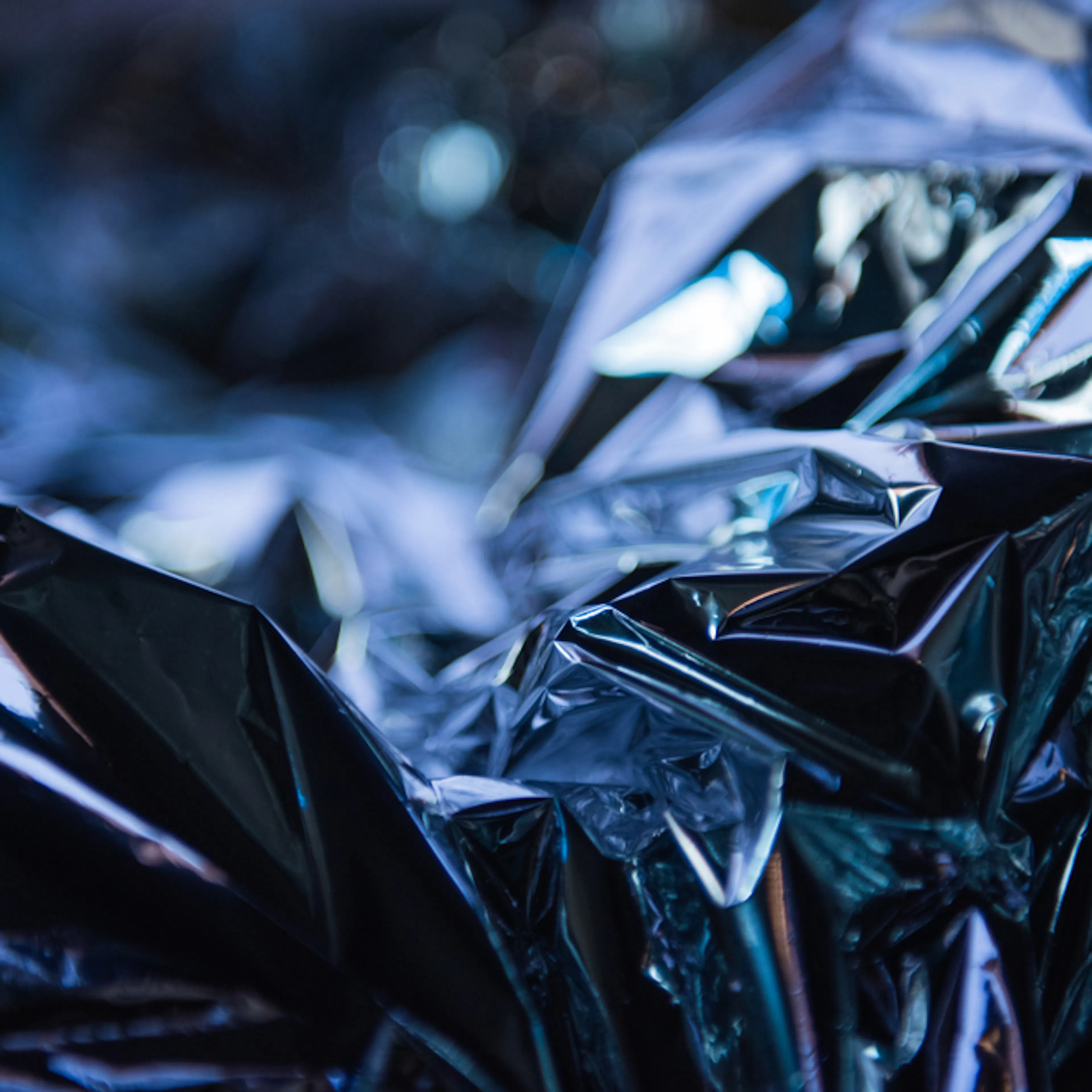

Mylar thermal blanket. Image Credit: Shutterstock.com/Alexander Sobol
Mylar® is a polyester film that is widely used due to its exceptional mechanical and chemical properties. It is so popular that it has become nearly synonymous with any plastic film. Mylar is used in numerous applications, from helium-filled balloons and food packaging to electrical and thermal insulators. Mylar was developed by DuPont in the early 1950s, building on PET research originally conducted by Imperial Chemical Industries (ICI). It is a registered trademark of DuPont Teijin Films. This article will define Mylar film, describe how it’s made, discuss its properties, and give examples of Mylar applications.
