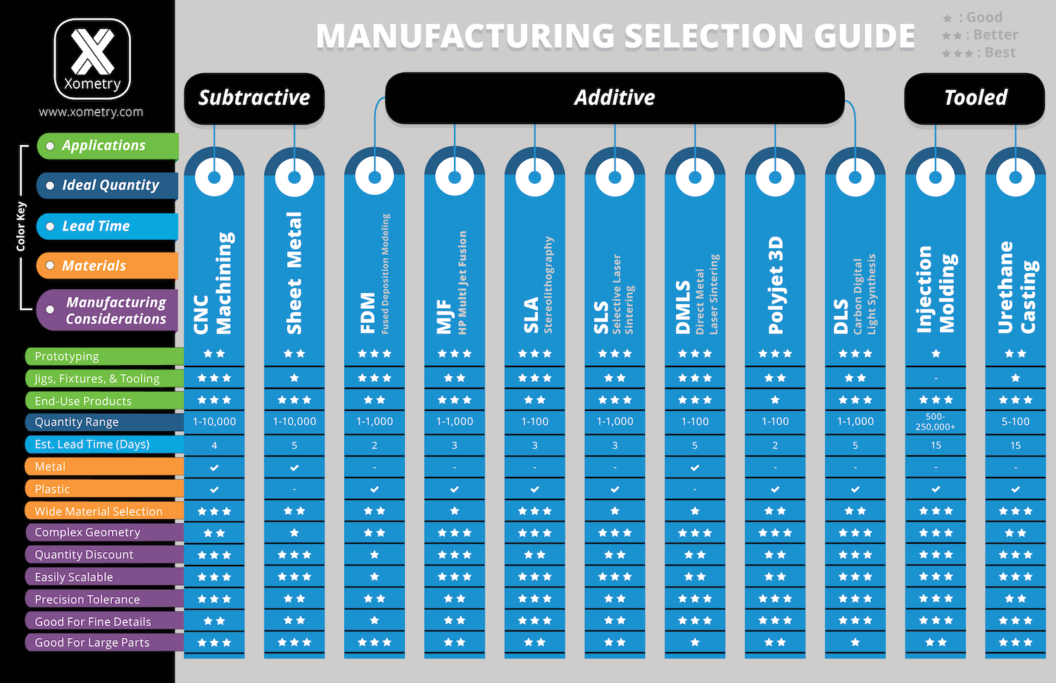

For engineers whose designs undergo a rigorous multi-stage engineering validation process, we have created a general guide to choosing the best manufacturing services to utilize at each product development stage. Note that this is only a general guide and the best process and material for a given project are highly dependent on the goals and specifications of a project.

These 3D printing processes can build parts that cost as little as $5 per part but be careful to choose general-purpose materials versus specialty materials, which can dramatically increase costs early on. When 3D printing is not an option and proof of concept prototypes must be created in the end material to validate physical properties like weight, surface finish, and some basic functions, manufacturing processes like CNC machining, sheet metal fabrication, and injection molding can be set-up and shipped quickly. However, typically even the simplest machine and tool set-ups will cost more than 3D printing.
