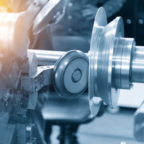

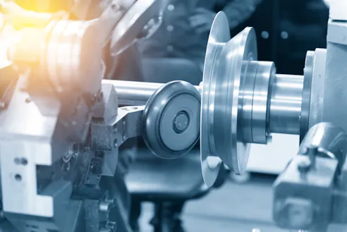

Metal spinning is the process of forming a circular sheet of metal into an axially symmetric final product. It is typically performed on a lathe by clamping the metal plate to one end of a pattern (or mandrel), then spinning the plate while applying tools against the metal to gradually form it around the pattern.
The first step in metal spinning is to make a pattern or form. Forms are usually machined from either metal or hardwood. The form is fixed to the headstock of the lathe. A flat metal blank is then securely clamped to the form with a pressure pad, which is mounted to the tailstock.
During the actual forming process, the metal blank is spun at high speed, and a set of tools progressively applies pressure to the plate to incrementally form it around the pattern. The many different available types of shaping tools are each designed to create particular features in the part. The spinning process may either be manual or automated with CNC equipment, making it suitable for either low or high-volume production.
