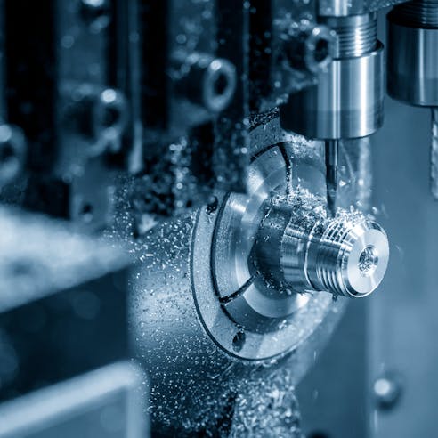

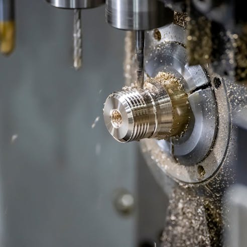

    Swiss machining is a material-removal process that uses advanced CNC-controlled sliding-head lathes to perform cutting operations along and perpendicular to the workpiece axis. Unlike traditional setups, in which much of the bar stock is exposed, Swiss-type machines use a guide bushing that exposes only the section being machined. This minimal stick-out drastically reduces vibration and deflection, enabling simultaneous machining processes that deliver higher stability and superior precision.

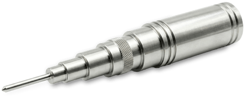

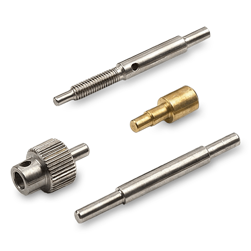

    Example of a swiss turned part.
    Due to this efficiency, Swiss-type machining is the premier fabrication method for complex, small-diameter components in the automotive, medical, and aerospace industries. Xometry’s capabilities are compatible with a vast range of materials, supporting applications from surgical and dental instruments to fuel injection components and hydraulic valve spools. Our extensive network of manufacturing partners enables us to supply these high-quality Swiss-machined parts globally, meeting your project needs wherever you are.

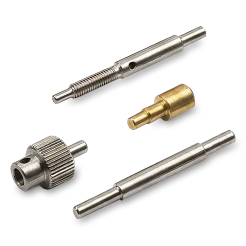

    Various Swiss-machined components in different materials.

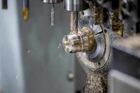

    Swiss machining. Image Credit: Shutterstock.com/Pixel B
    High Precision & Tight Tolerances
    Swiss machining uses a guide bushing to support the workpiece near the cutting tool, minimizing deflection and vibration. This stability allows for exceptional accuracy on long, slender parts, routinely achieving tolerances as tight as ±0.001” or better.

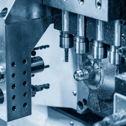

    Swiss-type machines can perform cutting operations both axially and perpendicularly to the workpiece in a single setup. This versatility eliminates the need for secondary operations, enabling the efficient production of intricate parts such as orthopedic implants, watch gears, and aerospace fasteners.
