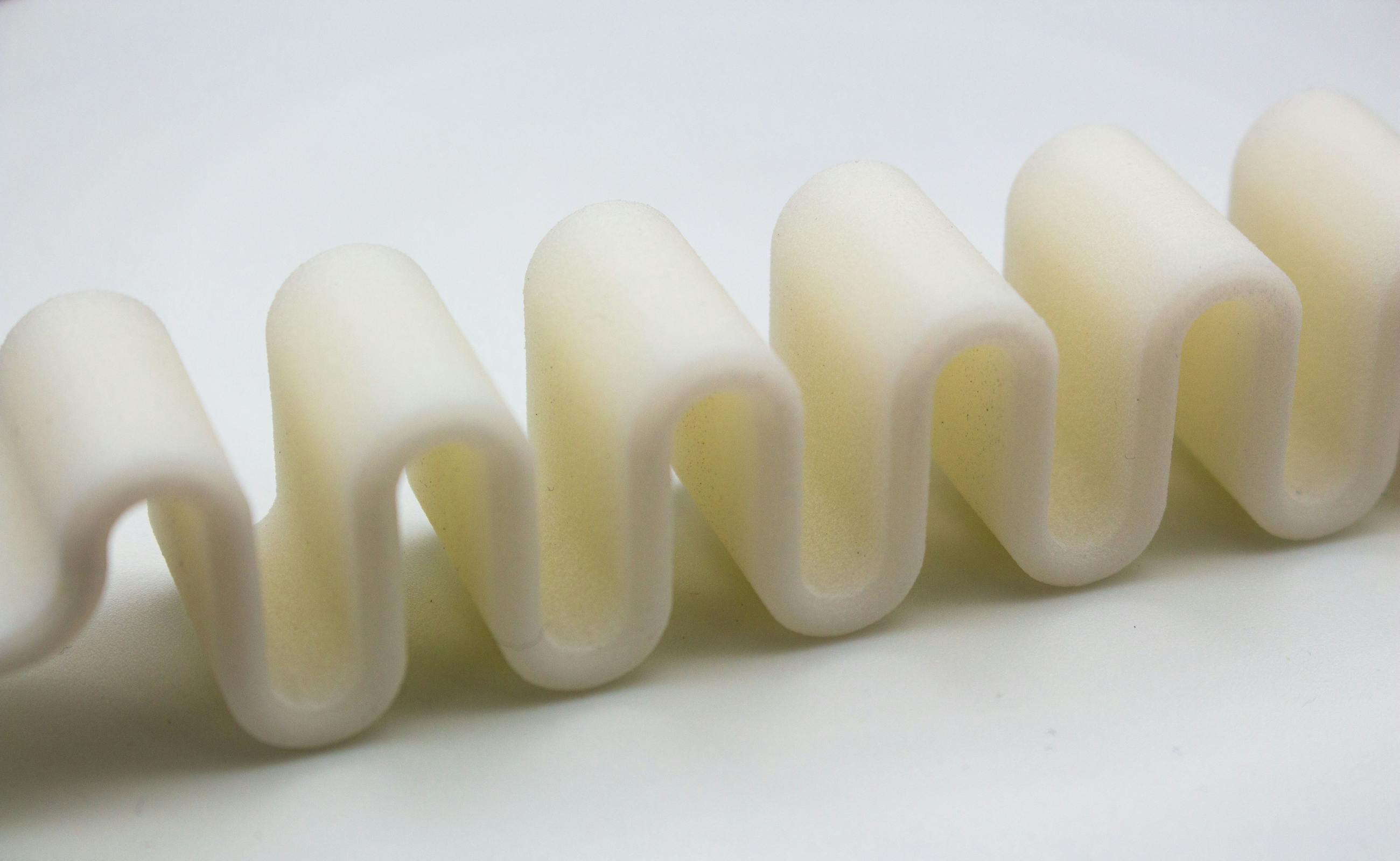

Close-up of glass filed SLS PA12.

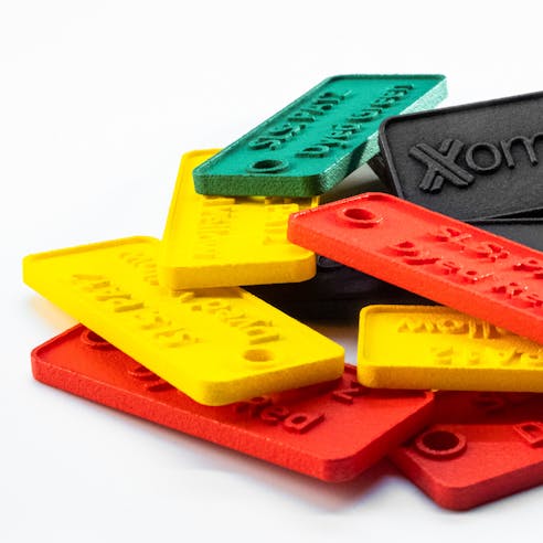

    Color Dyeing: Parts are submerged in a dye solution that penetrates roughly ~0.010” into the surface, altering the surface’s color. Coloration may vary slightly from batch to batch. Available for SLS and MJF nylon parts.

      Samples of SLS PA12 dyed in various colors.

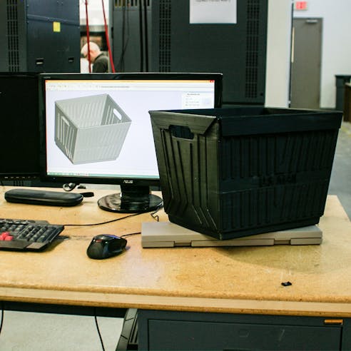

      Drone part 3D printed in Nylon 6 CF via FDM.

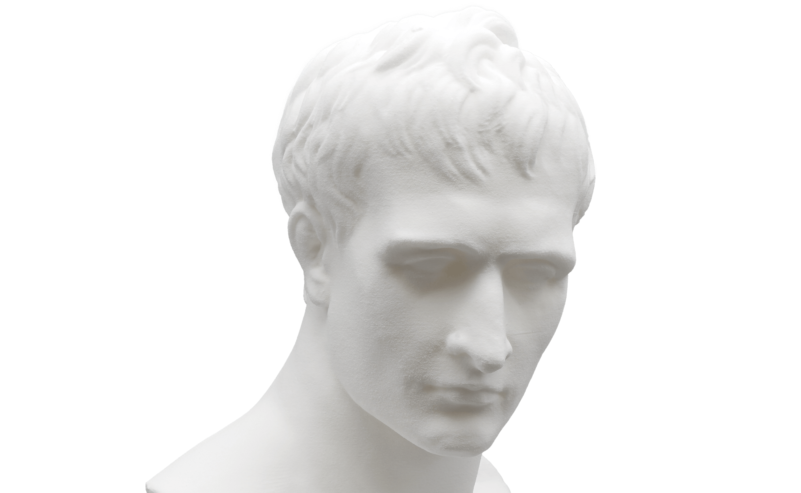

      Bust 3D printed in Nylon 12 via SLS.

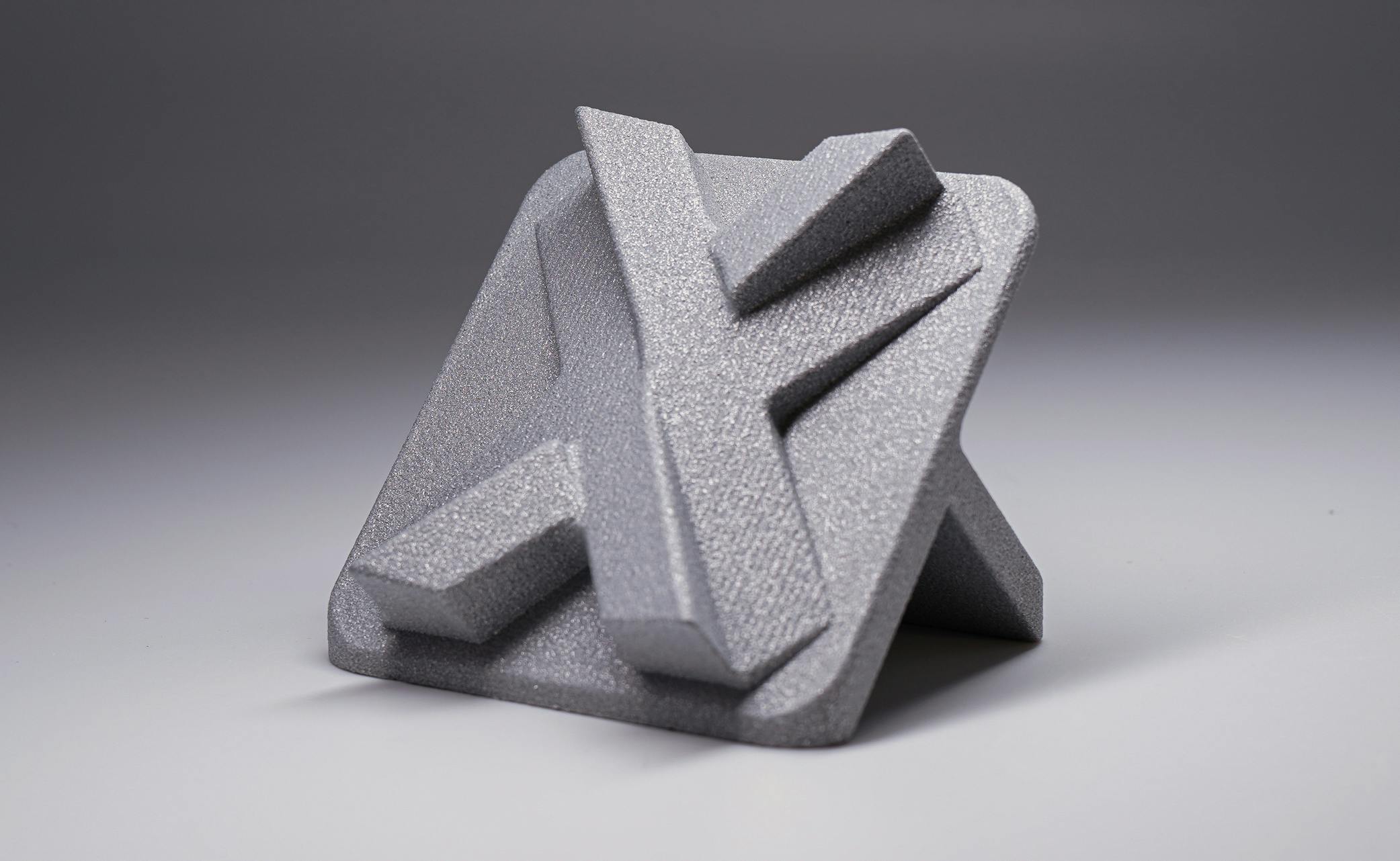

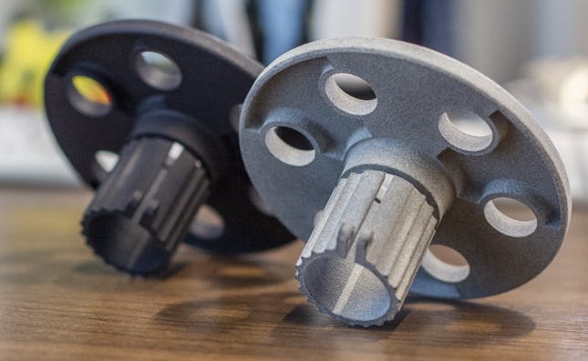

      SLS Nylon 12 Aluminum-Filled (AF) with Polyshot Finish
