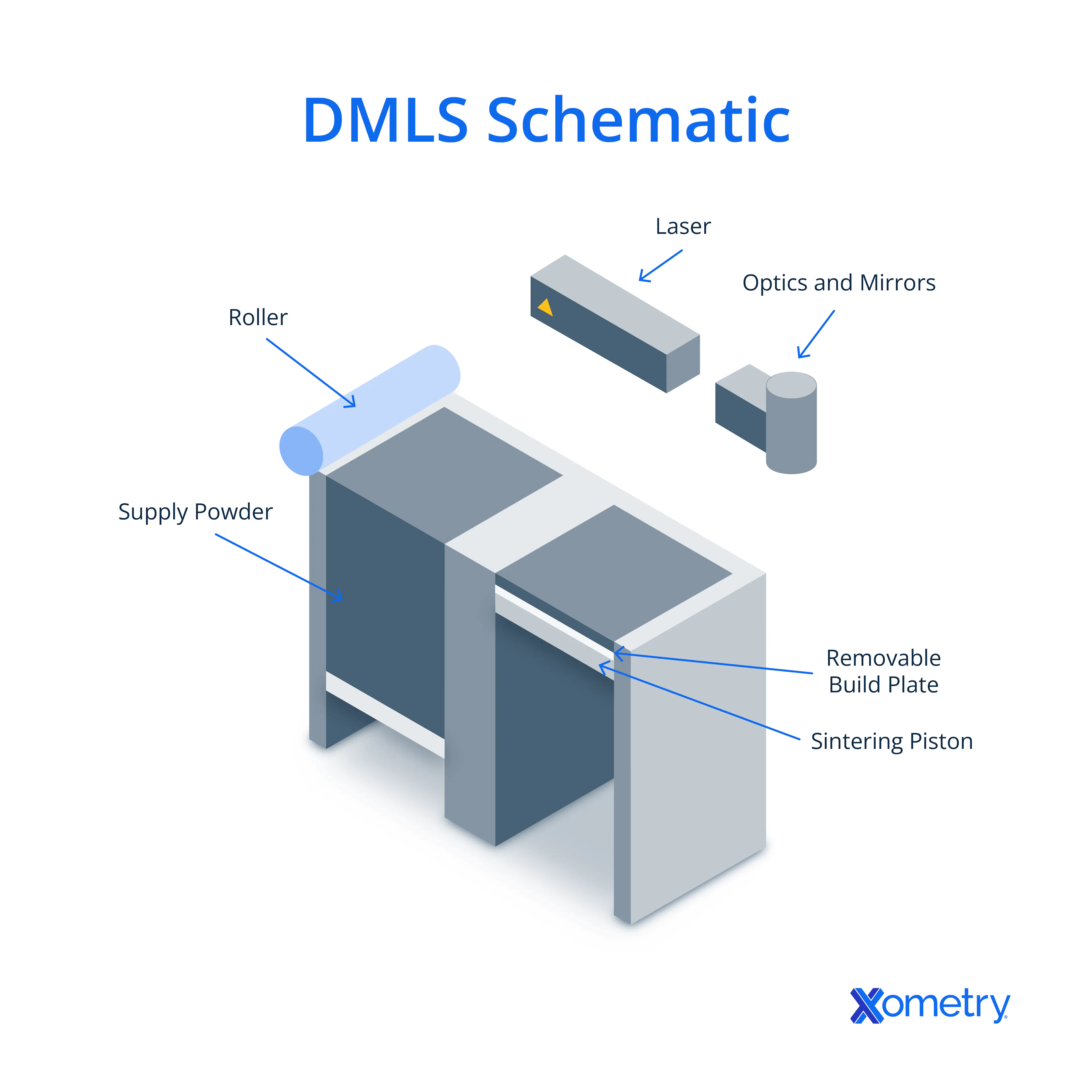

Now that you get the gist, we’re going to get more into the nitty gritty of the DMLS process. The start of the process involves the fiber laser beam, which can have up to 1,000 W of power. It begins scanning the cross-section of a part layer and starts melting the powder particles together.
While there is often one laser beam, some machines have the capacity to shoot out four beams at a time, which quadruples how quickly the process moves along. Usually, a DMLS printer will scan and laser at a speed of around 7 m/s.
Once the first layer is finished, the bed moves down, and another layer of metal powder is put down. Then, the system will fill the printing chamber with an inert gas to prevent the part from oxidizing during the rest of the printing process. After this takes place, the melting of the next layer occurs until the part is complete.
The quality and accuracy of the print comes down to how good the laser and optical components of the printer are. Normally the focal point is between 40 to 100 microns in diameter—which means the smallest feature you can get is 40 microns.
In the picture below, you can get a good idea of how a DMLS printer looks and what components are featured.
DMLS Schematic
DMLS Schematic

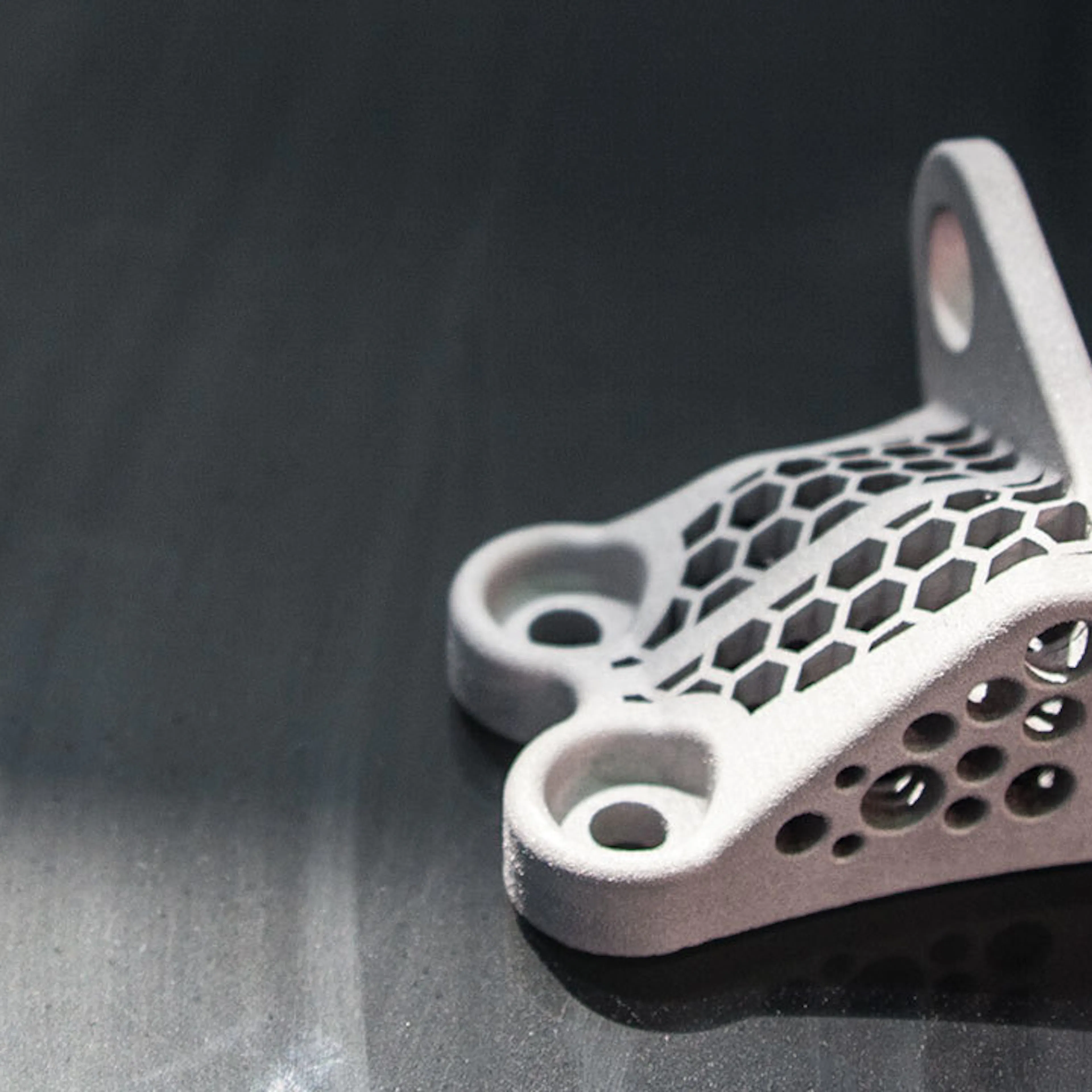

The following image shows a stainless steel part we printed through DMLS.
Stainless steel part made by Xometry with DMLS 3D printing.
