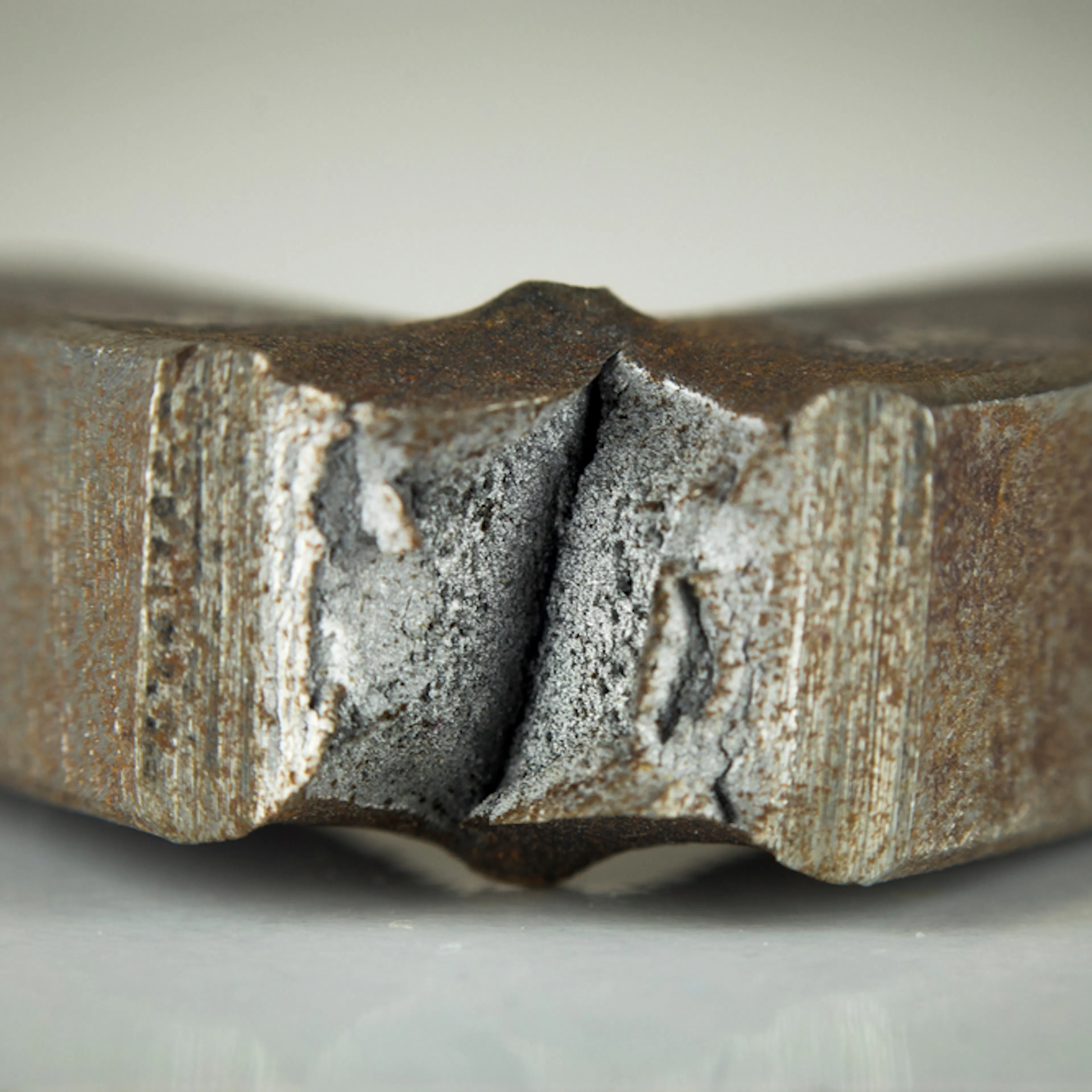

Low carbon steel that has been applied fracture test. Image Credit: Shutterstock.com/bartu

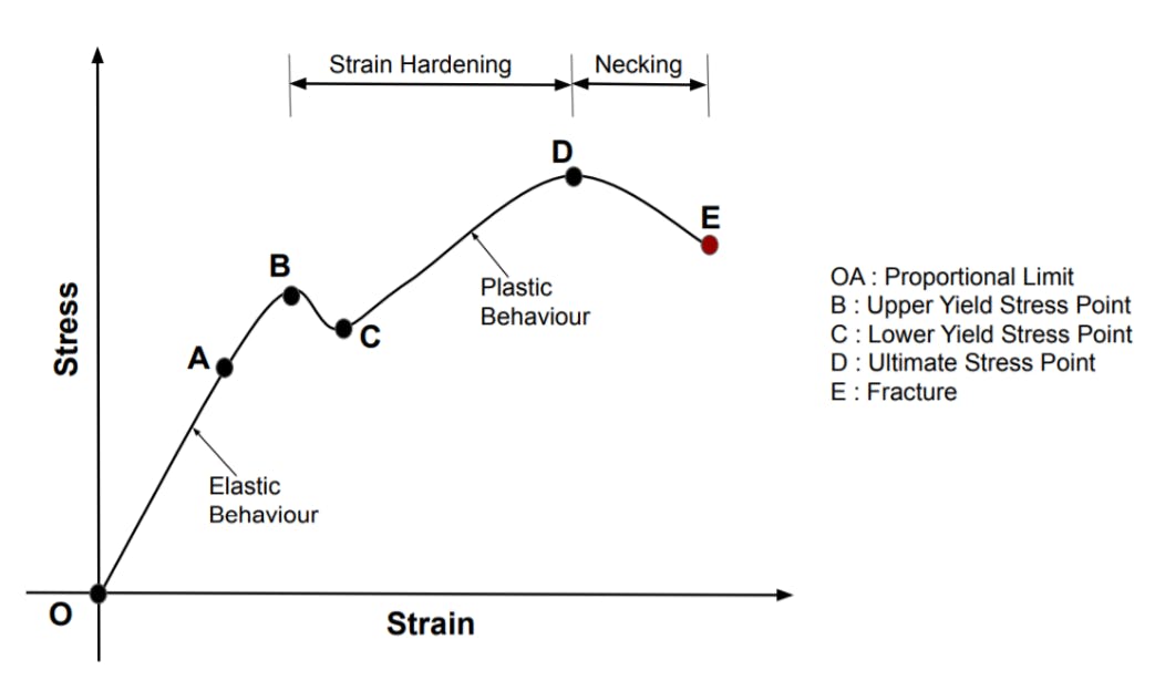

In a typical stress-strain curve, once stress increases beyond this limit to the material’s yield point, it begins to deform plastically. In some materials, a distinct upper and lower yield point may be observed; the lower yield point marks the onset of uniform plastic deformation. From A to B, the material undergoes strain hardening, where it can withstand increasing stress due to dislocation interactions despite continued plastic deformation. The maximum stress at Point B is the ultimate tensile strength (UTS). Beyond Point B, localized reduction in cross-sectional area occurs, a phenomenon called necking, and the stress the material can sustain decreases until fracture occurs at Point C.
It should be noted that necking typically develops after uniform plastic deformation and is not present during the early stages of ductile failure. A higher degree of elongation before failure means the material is more ductile. However, some degree of strain hardening occurs in most metals before they reach the necking stage.

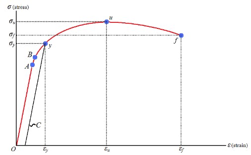

Highly ductile materials often lack a sharply defined yield point. For these materials, yield strength is commonly determined using the 0.2% offset method, in which a line parallel to the elastic region of the curve is drawn from a strain value of 0.2% until it intersects the curve. This intersection marks the yield point.

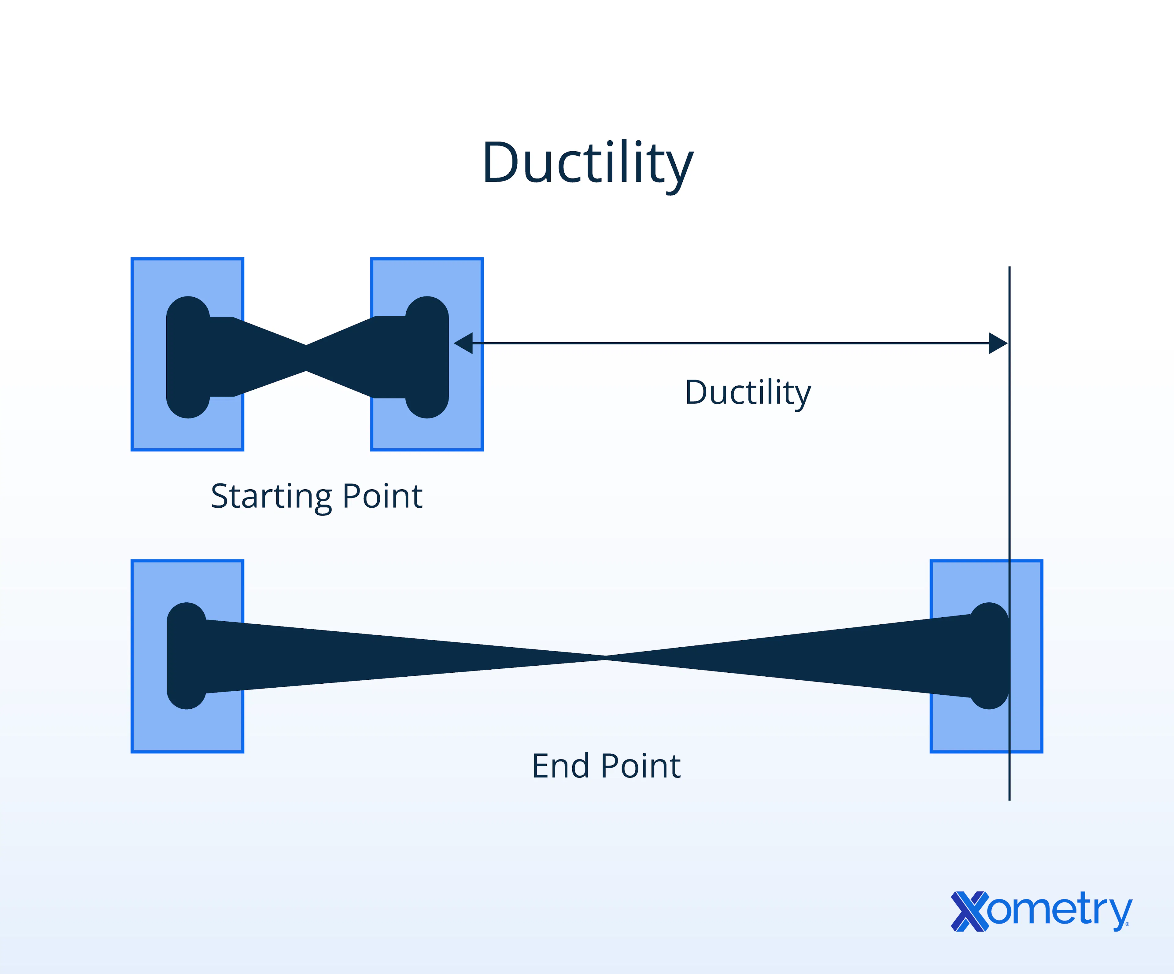

A material’s level of ductility can be determined by the proportional reduction in cross-sectional area at the fracture plane after failure. Materials such as aluminum and gold, which exhibit a large reduction in area before breaking, are considered highly ductile.
What Does “Ductile” Mean?
The word ductile originates from the Latin ductilis, meaning "malleable," "flexible," or "capable of being led." In materials science, ductility refers to a material's ability to undergo significant plastic deformation before fracturing. This property allows materials to be drawn into wires, formed into complex shapes, or absorb energy under load without failing suddenly.
For more information, see our guide on Ductility.
An illustration of ductility

What Does Ductile Failure Look Like?
Ductile fracture is characterized by a noticeable reduction in the cross-sectional area of the part near the fracture plane, a result of localized plastic deformation. This narrowing, known as necking, creates a distinctive profile in the failure region. In highly ductile materials, the necking zone often tapers to a sharper point before fracture, while in less ductile materials, the transition is more gradual.
