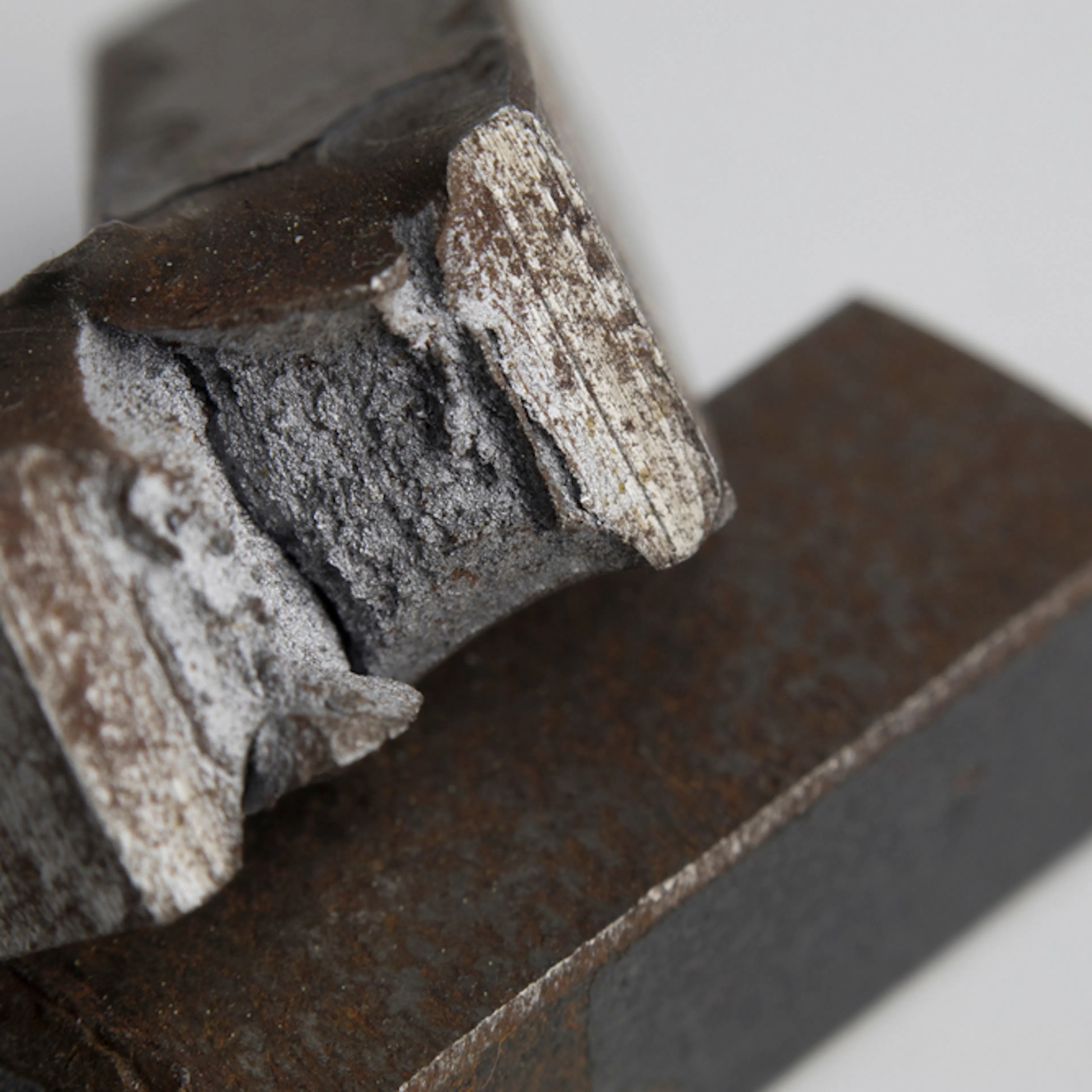

Low carbon steel that has been applied fracture test. Image Credit: Shutterstock.com/bartu
