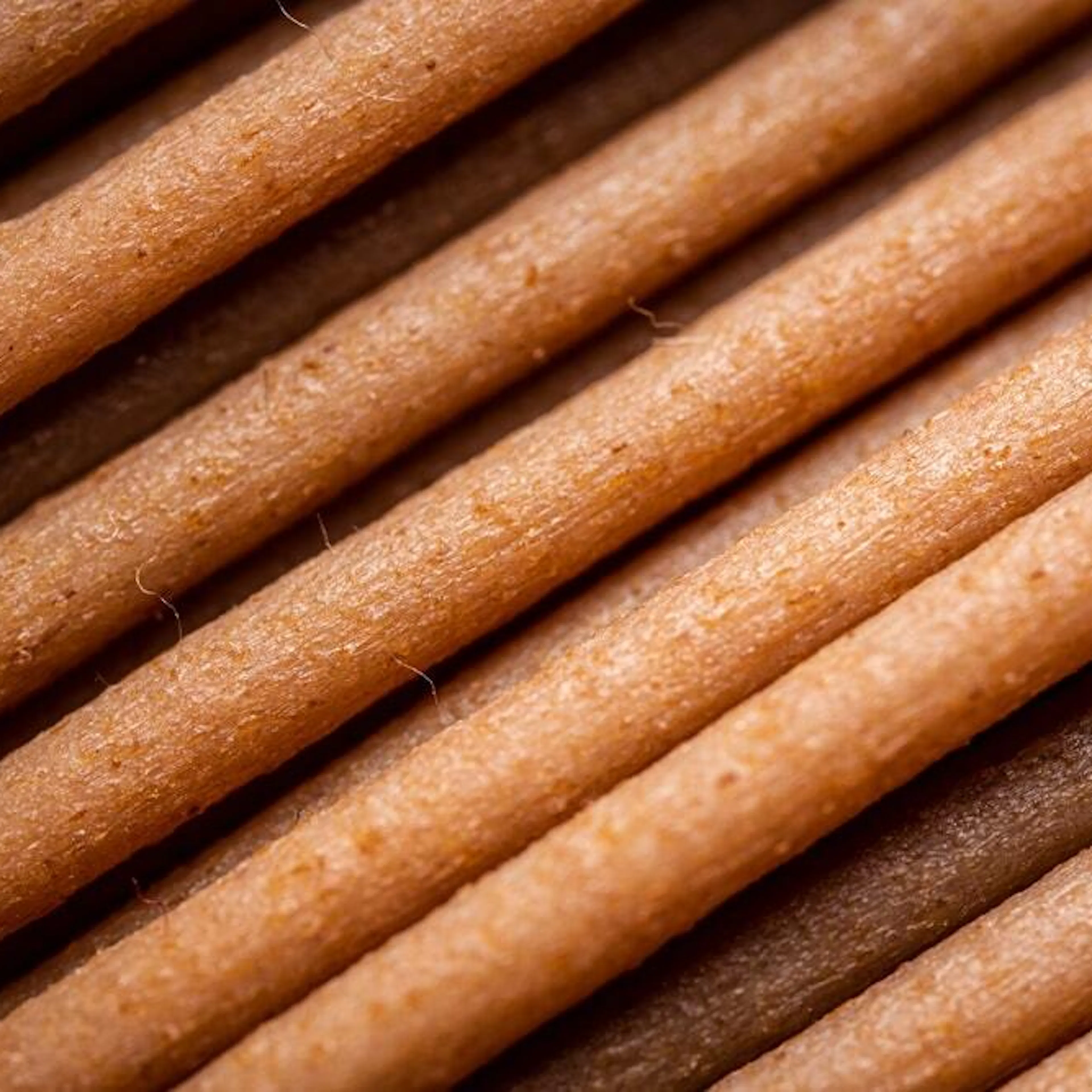

Macro photo of wood 3D printing filament. Image Credit: Shutterstock.com/Jack Soldano
Wood 3D printing filaments hit the market in 2012. The first was invented by German inventor, Kai Parthy, the founder of Lay Filaments. Wood filaments are unique in that they lend wood-like surface finishes to complex printed designs. Their compositions are usually 20-40% waste wood materials and 60-80% polymer. PLA (Polylactic Acid) is generally used as the polymer material and the wood component can be a selection of wood derivatives, including cork or wood shavings/sawdust.
