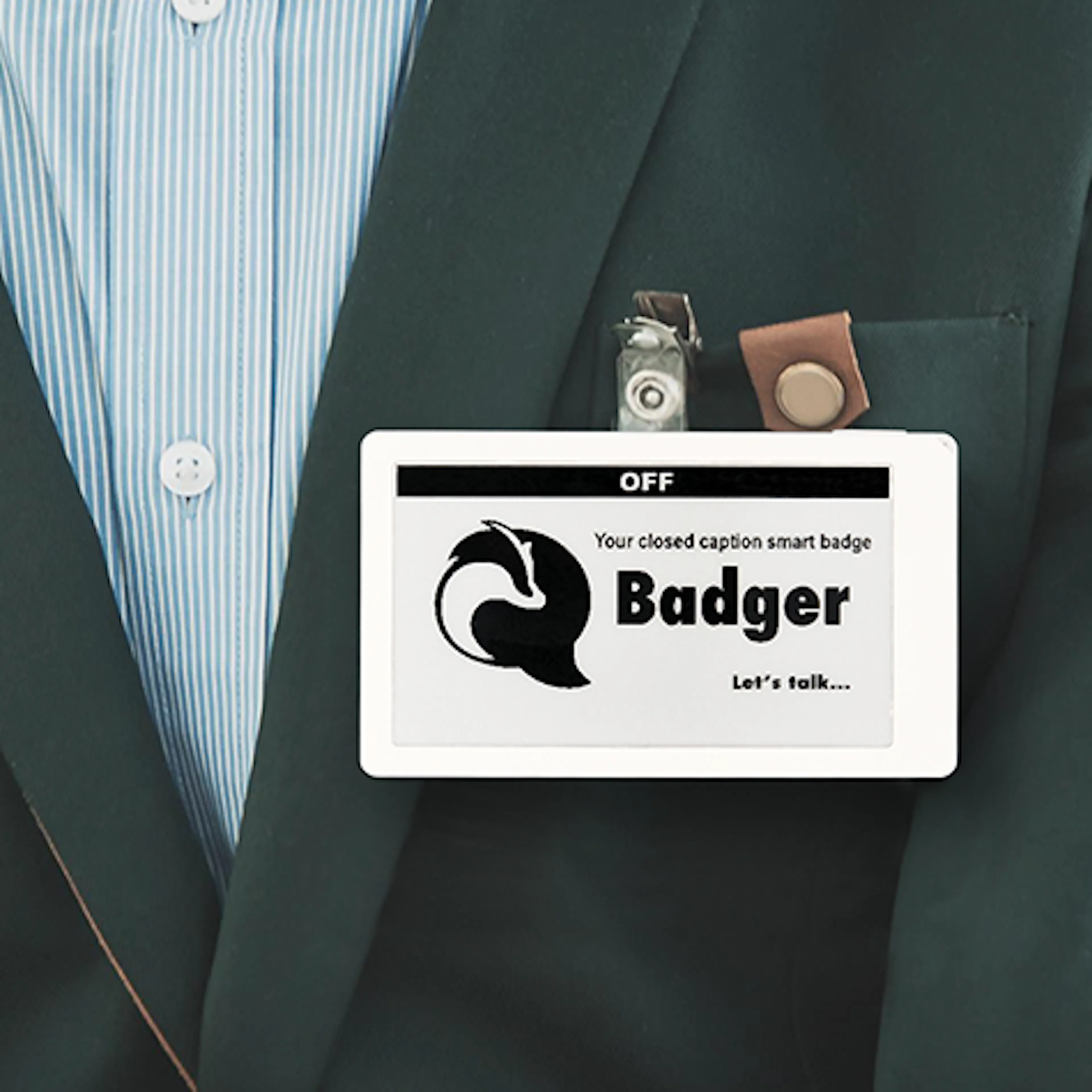

The smart badge product, aptly named Badger by Satellite Displays, is a wearable device for seamless integration into everyday life; most professionals wear one as a part of their daily uniform. The badge is a source of communication away from the face, so others can read what you are saying with live closed captions. This circumvents the issue of muffled speech or facial expressions and lip movements that are covered by an opaque face mask.
Satellite Displays created a sophisticated device to satisfy several requirements. The ID badge continuously displays a person’s face to confirm the wearer’s identity and affiliation with an organization or at an event. The badges also incorporate RFID capabilities to allow a person’s safe entrance and passage via badge scanning. Williston and his team combined RFID technology with an efficient e-ink display that, even after 40 hours of speech translation, shows a person’s ID without battery power.
For the badge’s main technology, the company uses a superior speech-to-text phone application—similar to the likes of Alexa or Siri—combined with a microphone that can pinpoint and isolate the speaker’s voice from above. Badger uses Bluetooth to connect to your smartphone, transmitting speech to the phone app, and then receiving text back at high speed. To use the badge, users simply press a button or use a voice activation cue. Users can also use the phone app for easy software and firmware updates.

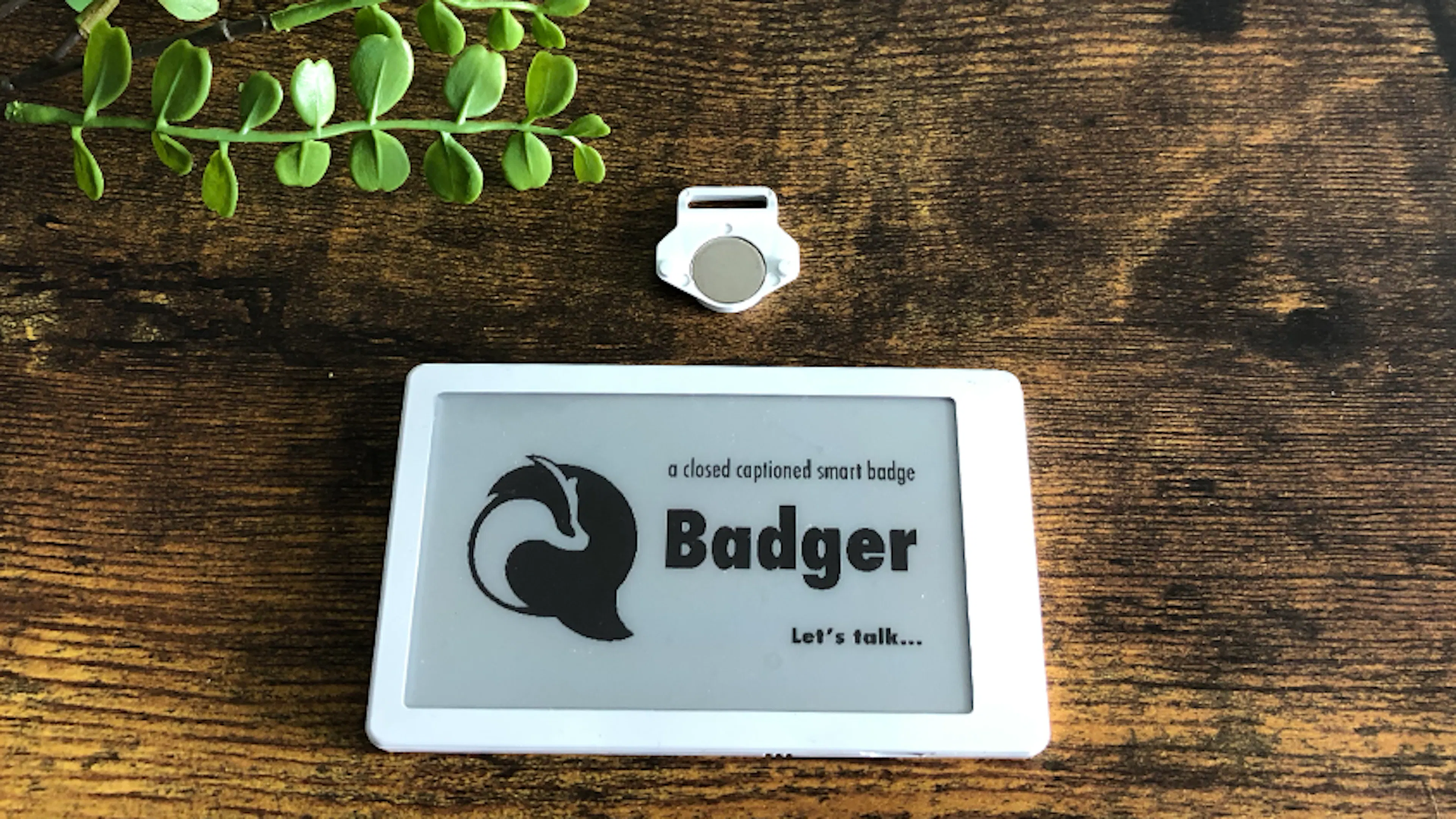

Satellite Displays had a few major considerations at the manufacturing stage. The company needed its badges to come in at a maximum weight of 2 oz (57 g) or less to ensure user comfort. To do this, the five components of the badge’s housing and joining parts had to be as thin and lightweight as possible. The magical number for the team was 0.5 mm (0.020”) wall thickness—a task that every company except Xometry turned down. Lucas Taylor, the mechanical engineer for Satellite Displays, said, “Our project with Xometry had some very challenging parts for any molder, and they got it done without requiring us to compromise the design intent. Other rapid tooling shops seem to only accept the very simplest part geometries.”
At this size, the case pushed the boundaries of what even industrial 3D printing could do since the parts had various small mating features. However, Xometry found within its huge Manufacturing Supplier Network an overseas manufacturer who could guarantee the parts at the right dimensions for the right price. “I didn’t have the connection to the right manufacturer and Xometry gave us that connection,” says Williston.
Before scaling up, the team needed to validate the fit and function of the product with a prototype. They desired greater confidence in the parts before making the investment in an injection mold tool. Since Xometry offers eight types of 3D printing, the Xometry team recommended high-resolution stereolithography for the prototype. The SLA prototype was printed and shipped out within a week, and the team gained the confidence they needed to move ahead with a steel injection mold.

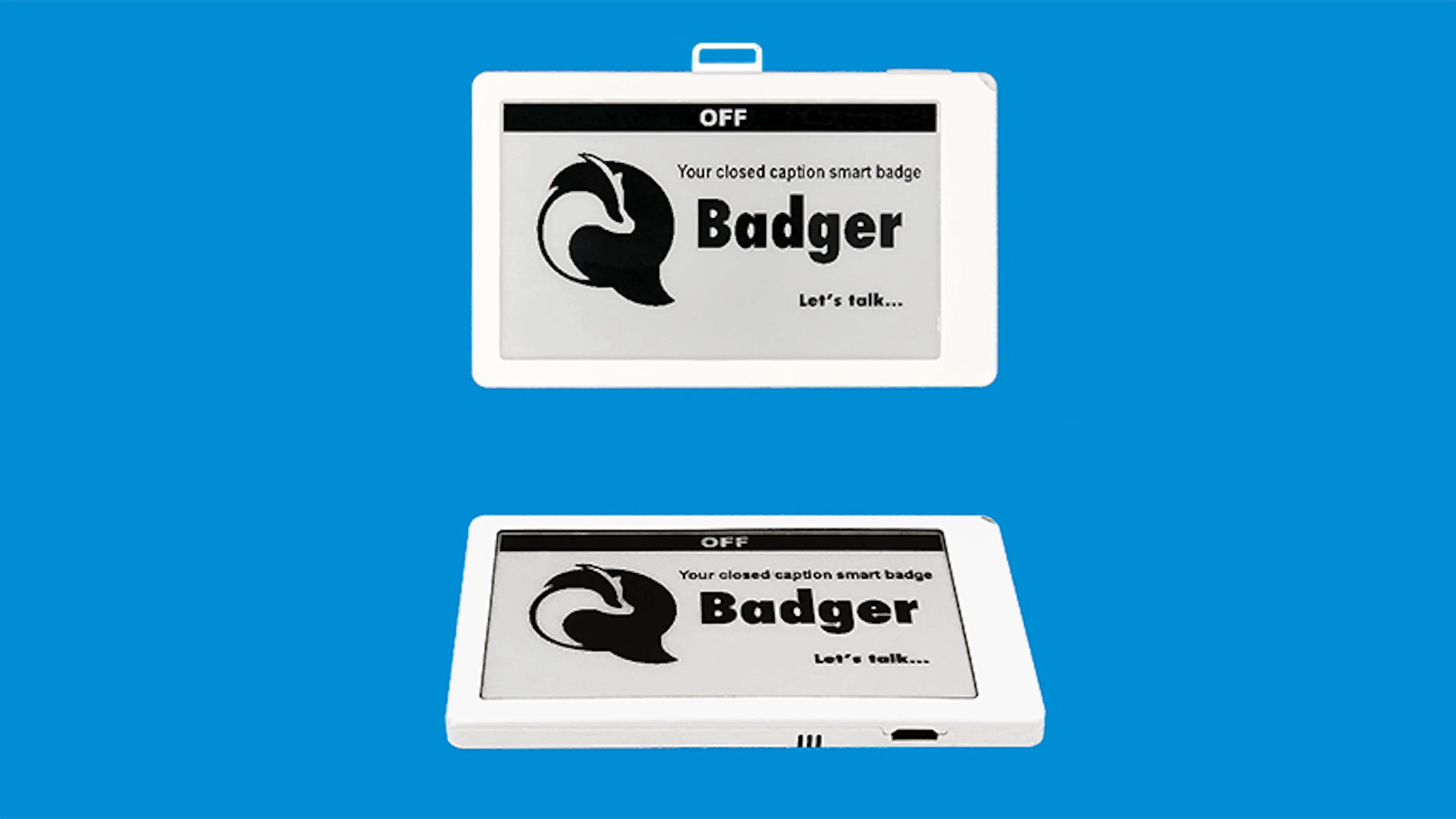

At the molding stage, Xometry’s molding supplier was able to adapt the mold to accommodate a novel friction pin closure system in the badge design. “One of the manufacturing challenges was making the clamshell housing optimized for manufacturing, assembly, and industrial design. We wanted iPhone looks on a startup budget and there were a hundred ways for our strategy to fail. Xometry worked with us to make the first run parts with steel-safe features so that we could fine-tune the fit after the tooling was made. In the end, we achieved an excellent final result that checked all of our boxes on our critical-to-quality metrics. I have worked with many molders, and I can say that Xometry deftly handled our technical challenges,” said Taylor.
Once the T1 samples from the mold tool were approved, Xometry manufactured five connecting components out of ABS with finishes ranging from an SPI-A1 to SPI-D3. These components are sleek yet protective of the advanced internal components. The final assembly allows users to press a button at the top to cue the live speech captioning. You can also say, “Hey Badger, caption, ...” then sit back and chat with your patient, client, colleague, or friend in over 50 languages.
