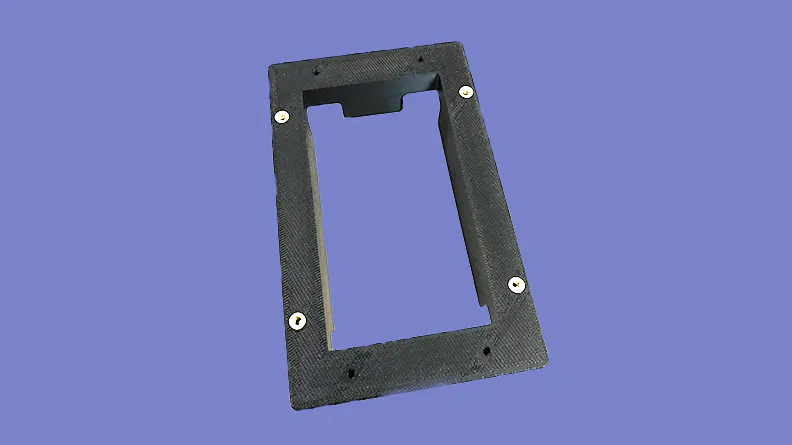

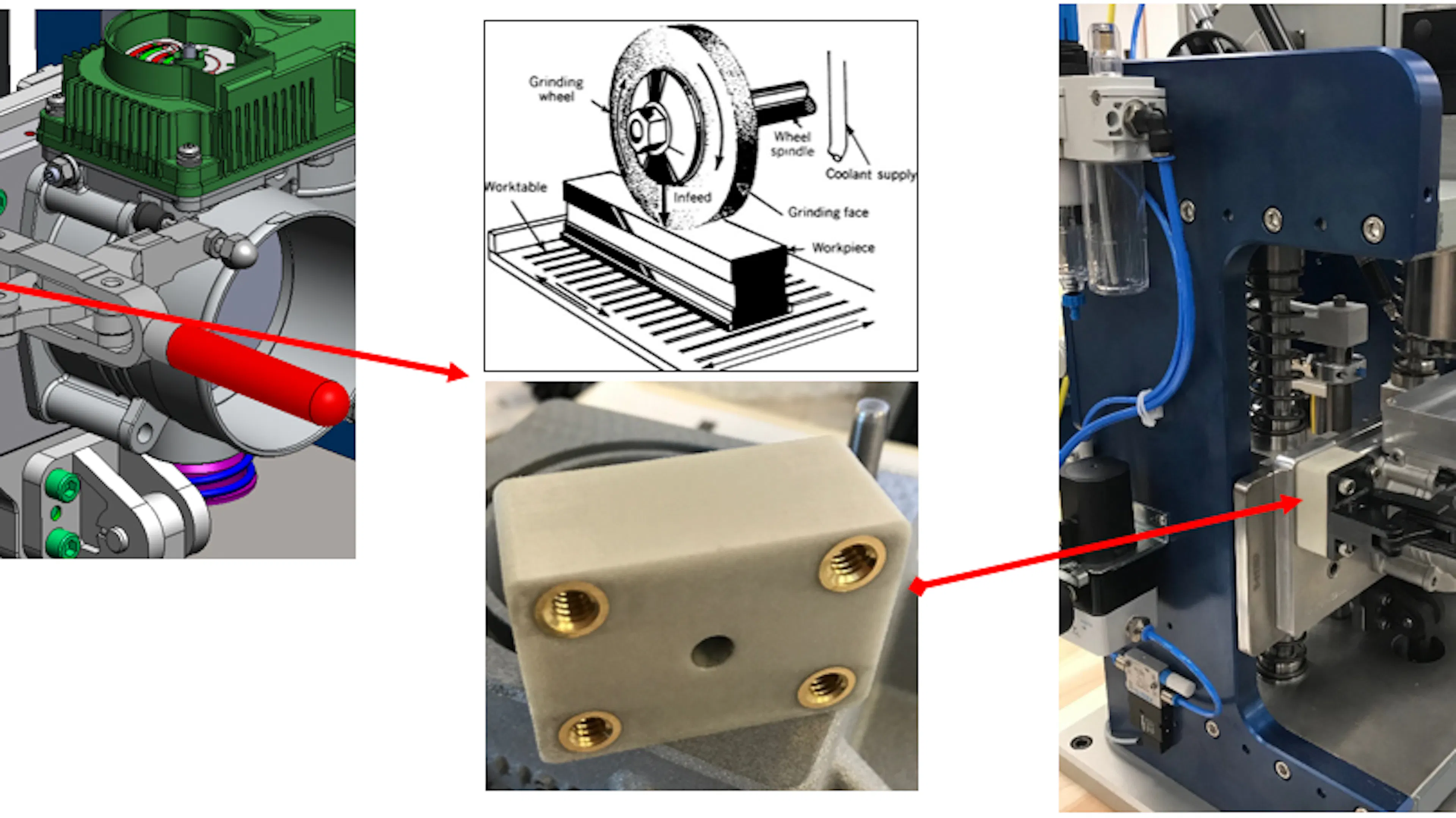

The company’s transition to additive manufacturing began with one project when they were curious to see how a 3D printed part would look and perform on the production floor. The part tested was a small fused deposition modeling (FDM) connector, which to this day is still performing as desired.

Soon the company began producing a wide range of small parts, usually 30-40 at a time, for use across a multitude of running projects. Their typical process begins by evaluating the end-use of the part to determine its custom design and which process to manufacture it in. They design the part, mainly within SOLIDWORKS®️, to get a 3D model which they then quote at Xometry. Gianluca noted that his favorite aspect of Xometry is the customer service and credible engineering knowledge.

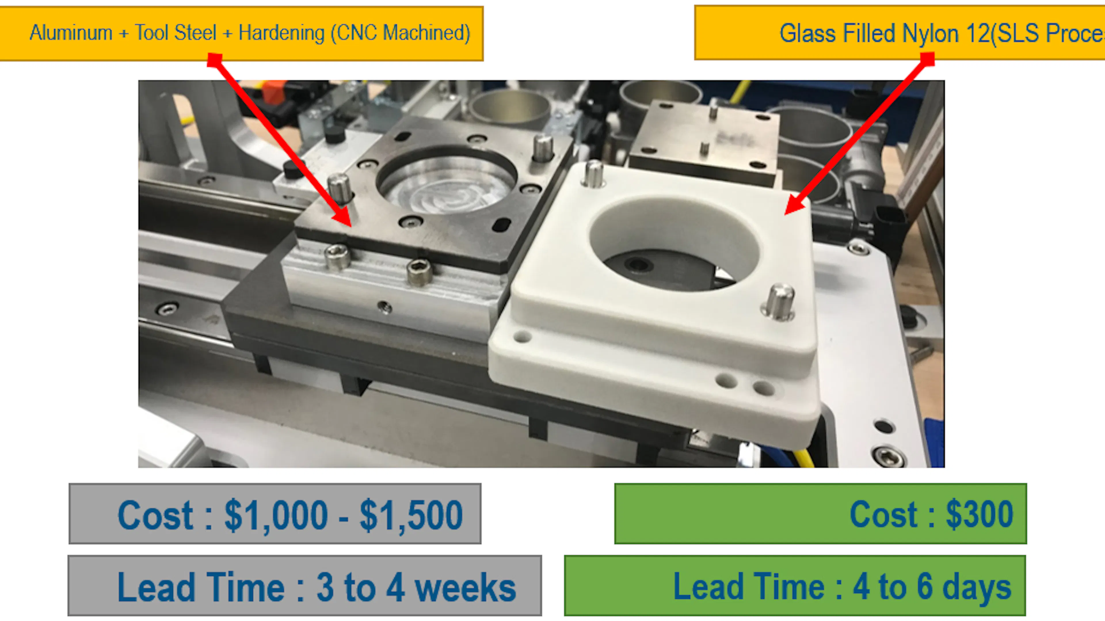

A majority of their parts tend to be selective laser sintered (SLS), a 3D printing process that builds bottom-to-top with a laser that fuses powdered material in cross-sections for highly accurate and durable parts. They keep in mind the benefits and drawbacks of each material - for example, Gianluca will select an ABS material when he knows the tool needs to have wear and impact resistance.

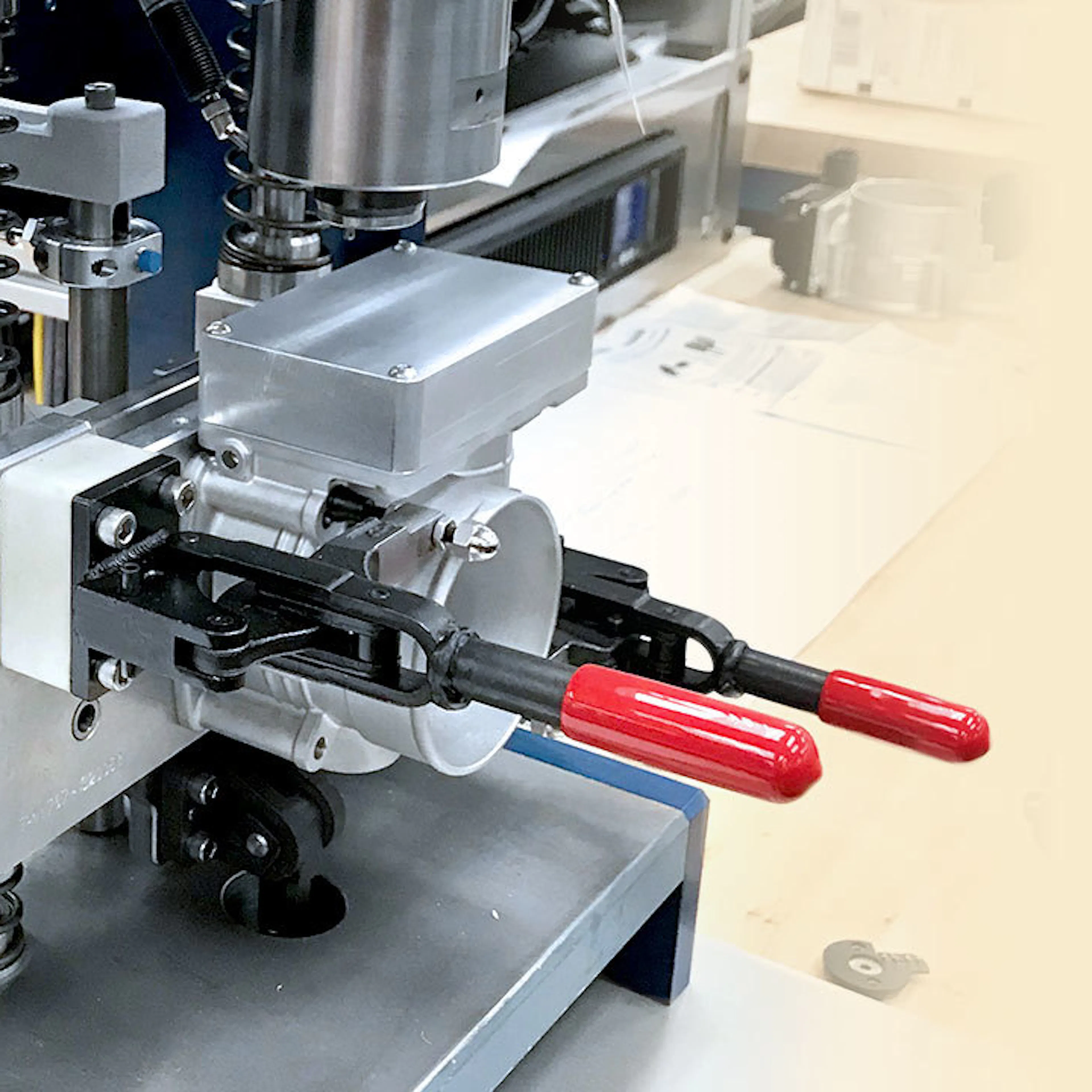

Gianluca has noted that their biggest breakthrough is the fact that additive manufacturing gives them the freedom to design innovative, ergonomic and highly customized jigs and fixtures for a variety of uses. He then leverages Topology Optimization and simulation software to explore new geometries within the design space to ultimately increase part performance while reducing its cost and lead time.
“Additive manufacturing is not just for prototyping. These tools are used on a busy and demanding automotive production floor and last 3+ years while being used over 200 times a day. It’s a beautiful scenario.”
Gianluca MattarocciaEngineer at SMP

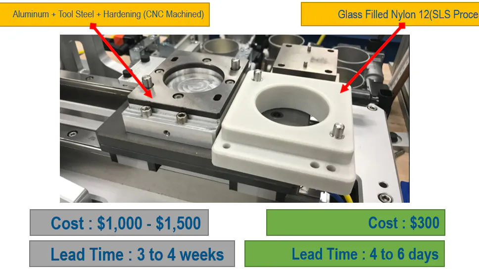

The company previously relied on in-house CNC Machining which could cost upwards of $1,500 per unit. With additive manufacturing, they can reduce the cost to $200 per unit and within 10 days it can be quoted, ordered, delivered, and on their shop floor. The cost of each part is reduced by 50-85% after switching from CNC Machining to additive manufacturing, and the lead time of their parts by 60-80%.

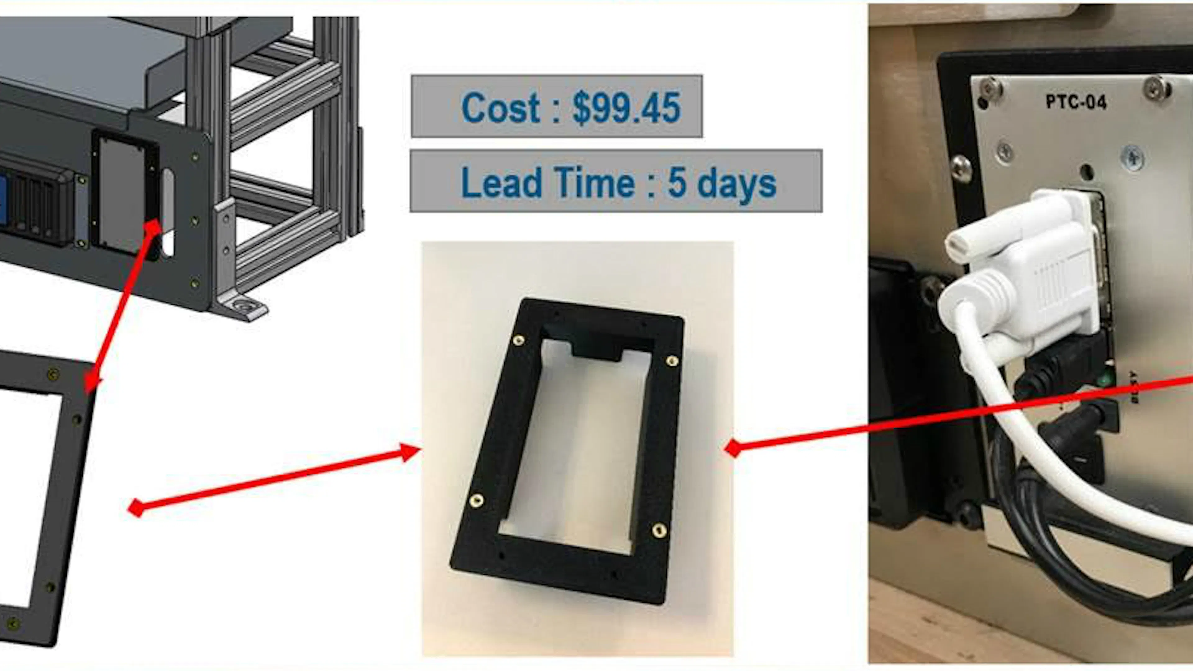

Gianluca has been thrilled with how additive manufacturing is transforming his work at Standard Motor Products. Many customized jigs and fixtures that were previously traditionally machined are now a fraction of the cost, and received much faster, which has had a dramatic effect on their business. The once-difficult process of adapting new tools and fixtures to an existing production setup is greatly streamlined through the use of additive manufacturing.
