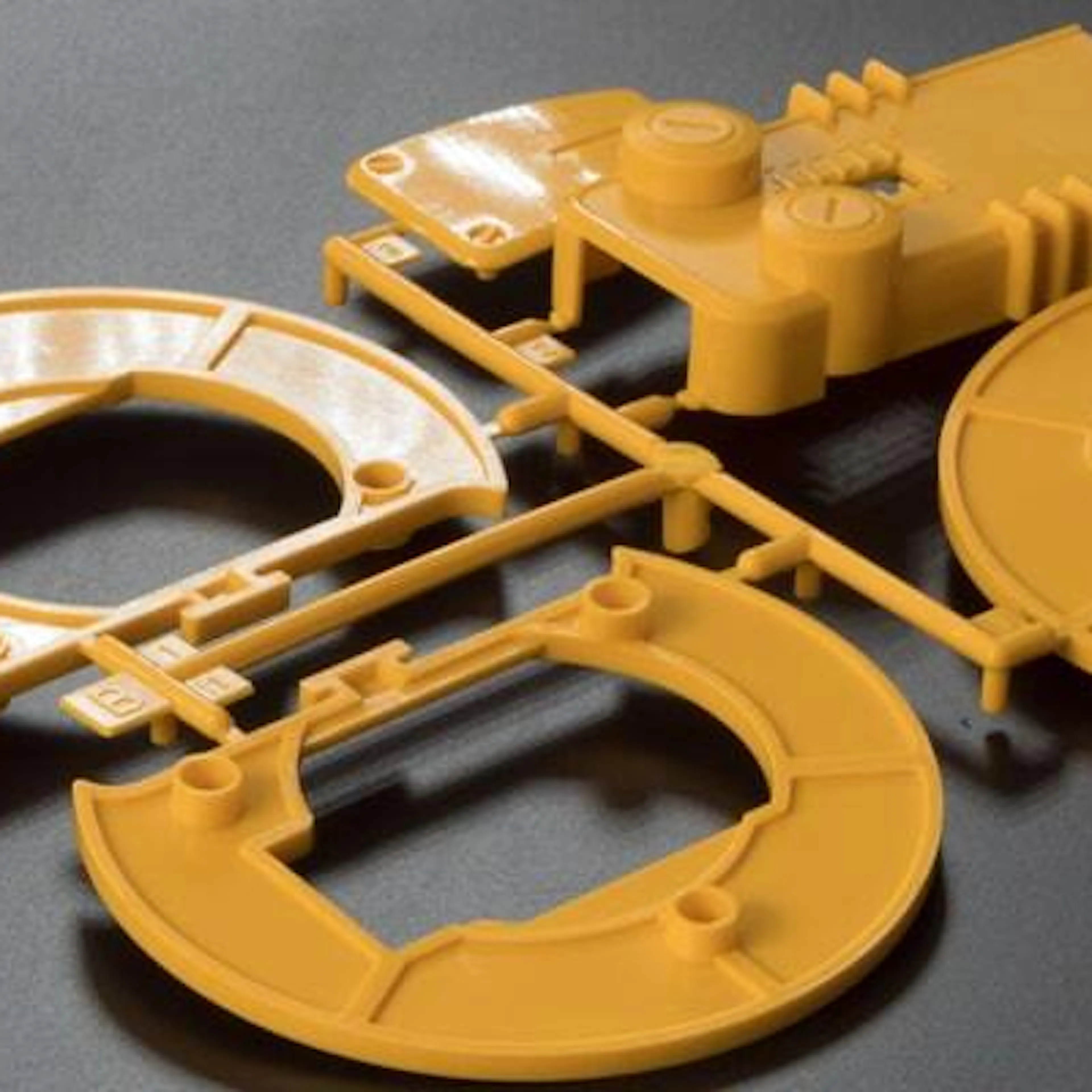

Industrial injection molded plastic part. Image Credit: Shutterstock.com/luchschenF
ABS injection molding is a common manufacturing process that involves injecting molten plastic into a mold cavity under high pressure and temperature. This technique is used in the automotive, consumer products, and construction industries for producing various components and products. We’ll cover the definition, uses, process, and techniques involved with ABS injection molding below, but for a brief recap, take a look at our short video below:

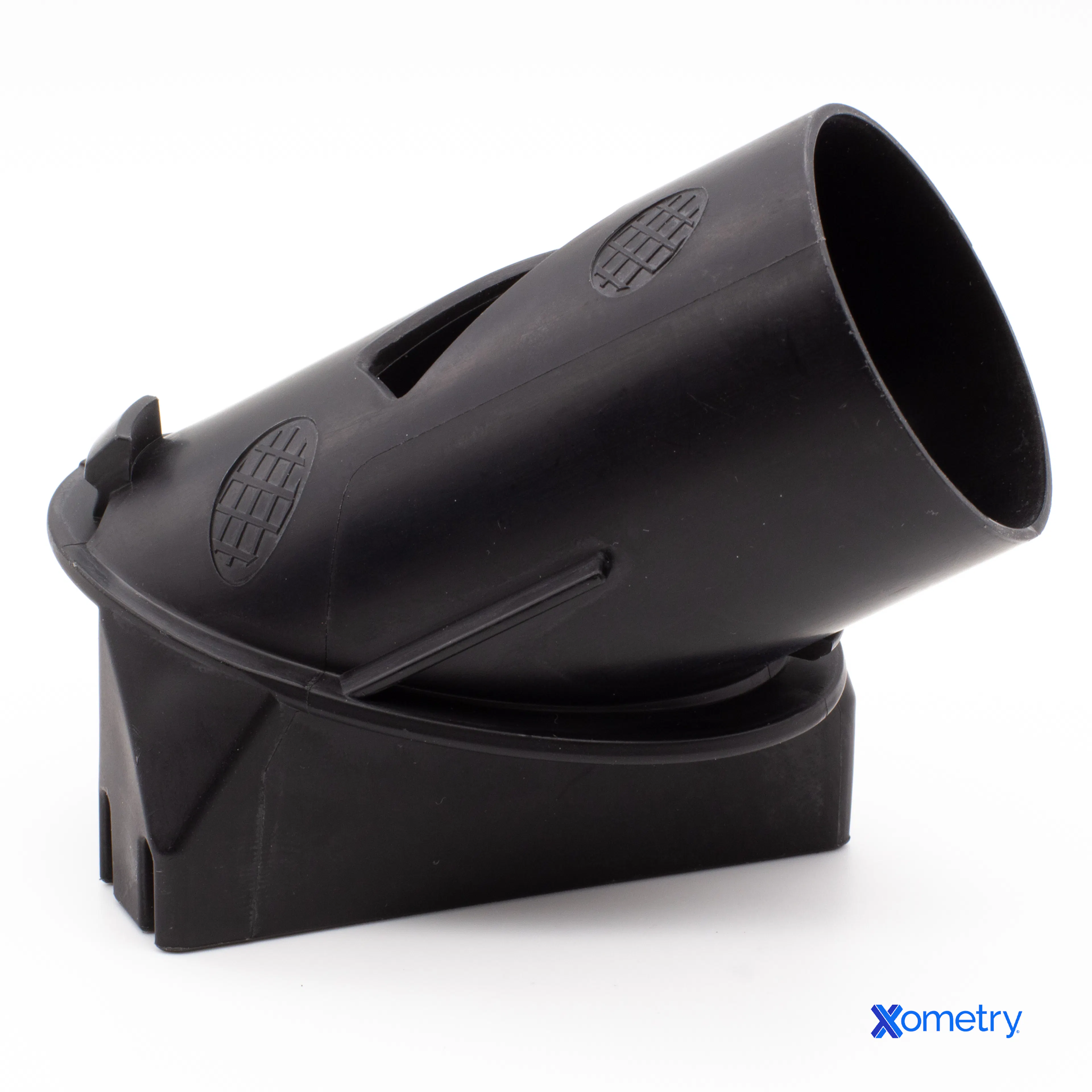

Black ABS Molded Part
A black ABS molded part
