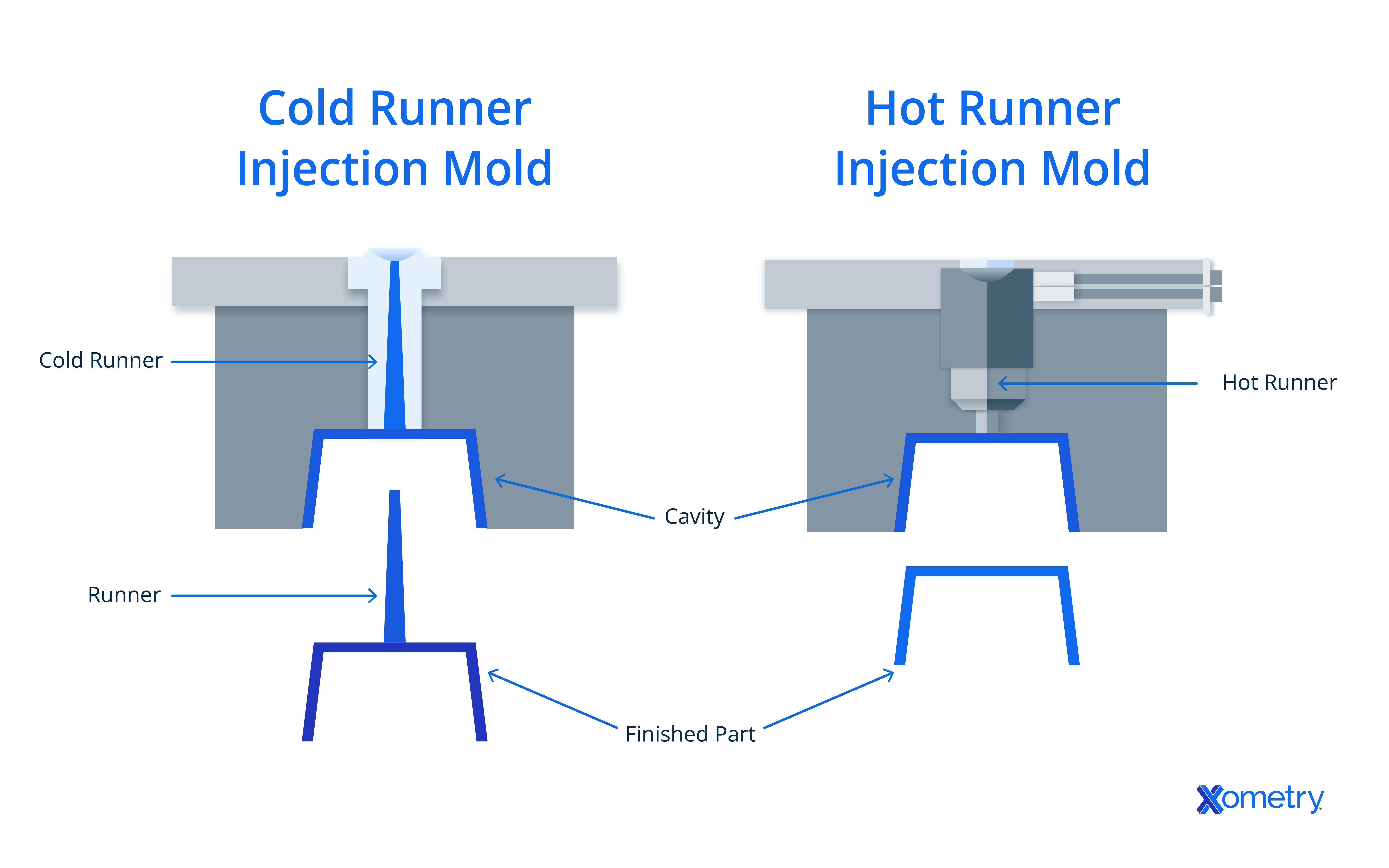

Injection molding is a manufacturing process that produces plastic components. It is a popular method for low-volume production, pilot-run, and prototyping of designs. Injection molding has two main types of mold designs: hot runner and cold runner. A hot runner mold uses a heated runner to transfer molten thermoplastic or polymer to the mold cavity where the final product takes on its shape. A cold runner mold uses an unheated runner channel to transfer the molten material from the machine nozzle to the mold cavity.
While these two methods both produce plastic parts, hot runner mold and cold runner mold systems differ in terms of cost, speed, and accuracy of the molded parts. Hot runner molds are more expensive to set up and maintain than their cold runner counterparts. But, hot runner molds produce parts with a higher degree of tolerance and have a shorter lead time. A cold runner mold, on the other hand, is more affordable and works with a vast array of thermoplastic materials including heat-sensitive types.
This article will compare hot runner vs. cold runner, examine their advantages and disadvantages, as well as discuss the alternatives to both. Both setups are shown in the figure below:
hot runner cold runner mold diagram
Cold runner vs. hot runner diagram

Cold Running Molds Definition and Comparison to Hot Runner
Cold running molds use unheated runners to convey molten thermoplastic material from the nozzle to the mold or cavities. These are made up of two or three plates, depending on the design. When the process is complete, the runner comes out attached to the molded part. A cold running mold is sometimes preferred over a hot runner mold because of the low setup and maintenance cost.

The hot runner mold produces parts with a higher degree of tolerance than those of a cold runner mold. However, when changes in design or color are required – a cold runner mold is the best option.
