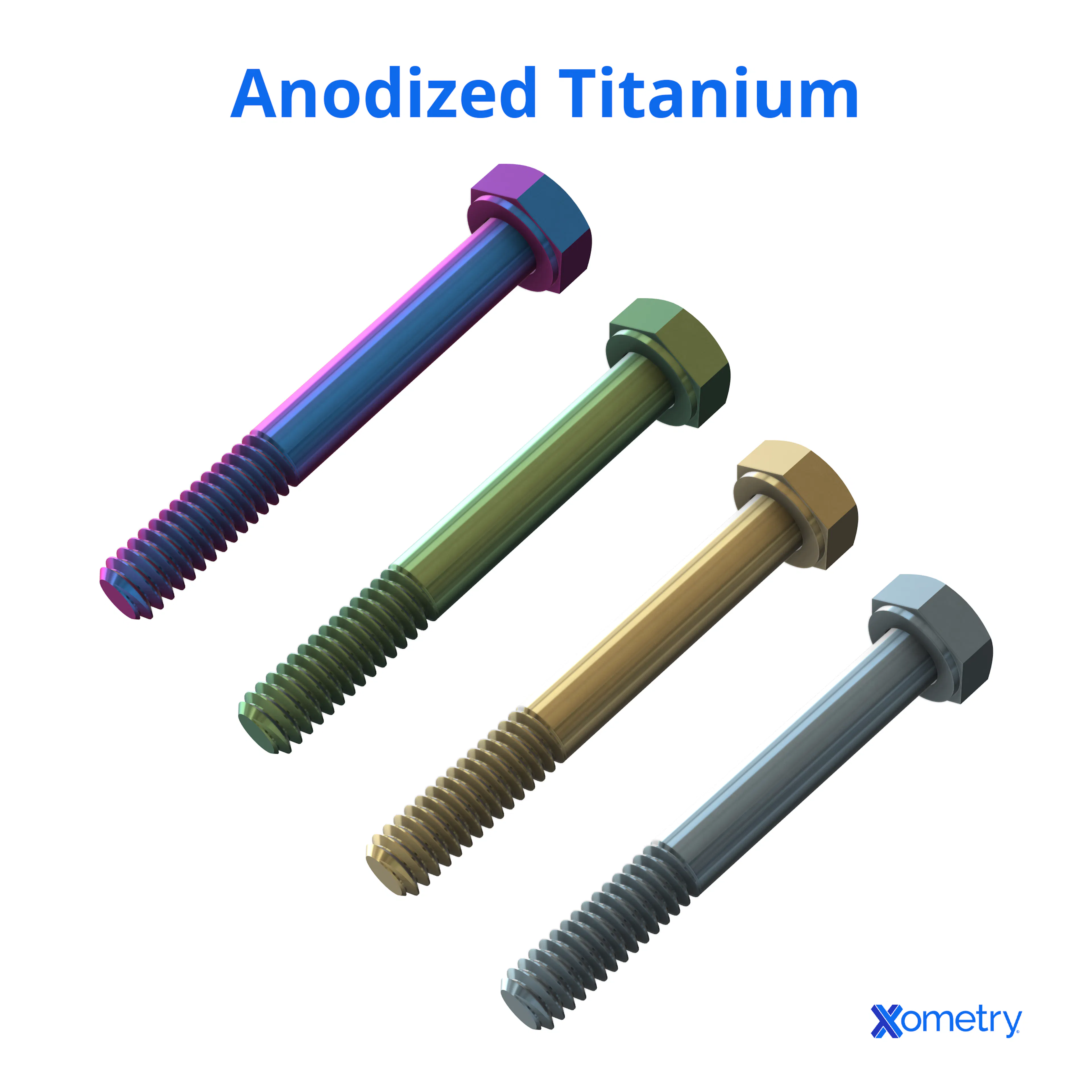

Anodizing titanium is an electrochemical process that grows a controlled titanium dioxide (TiO₂) layer directly on the metal's surface. The process alters the optical properties of the surface, producing vivid colors without dyes or pigments. Anodized titanium works by submerging the metal in an electrolyte solution, distilled water mixed with trisodium phosphate, while applying a direct current. The titanium acts as the anode, drawing oxygen ions from the solution onto the surface. Voltage determines the thickness of the oxide layer, which ranges from 10 to 300 nanometers, and that thickness dictates the color visible to the eye through thin-film light interference. Voltage control defines the final appearance by adjusting oxide growth at the atomic level. Lower voltage produces thinner oxide layers that reflect warm tones like gold and yellow. Higher voltage produces thicker layers that shift the reflection toward blue, green, and violet through interference effects. The oxide layer forms directly from titanium atoms, which creates strong bonding between the surface and the metal substrate. No external coating enters the process, which keeps the finish stable under wear, heat, and chemical exposure.
The steps covered in the guide walk through each phase of the process, from surface preparation to electrochemical circuit setup. Cleaning removes oils and oxidation that interfere with uniform oxide growth. Voltage selection, circuit configuration, and color monitoring are addressed in dedicated steps. Material and tool requirements are outlined to ensure safe and accurate results. The guide covers post-process care, including rinsing, drying, and optional sealing, to preserve the finished oxide layer.

Gold appears near 15 to 20 volts due to thin oxide formation and shorter optical path differences. Purple forms near 35 to 45 volts as the oxide layer thickens and shifts interference toward shorter wavelengths. Blue emerges near 50 to 60 volts under mid-range thickness conditions. Teal and green appear beyond 70 volts as oxide growth continues and longer interference cycles dominate reflection. Violet and secondary gold tones occur near 90 to 120 volts as additional interference transitions occur. Voltage stability within a narrow range maintains color repeatability, while minor deviations produce visible shifts across adjacent hues.

  • Bronze: Bronze appears at the earliest stage of anodizing, where voltage stays low, and oxide thickness remains minimal. Bronze reflects a warm metallic tone with slight brown and gold undertones. Surface polish strongly affects how bronze appears, with mirror finishes producing a brighter metallic shine while matte surfaces create a softer look.
  • Purple: Purple forms as voltage increases and the oxide layer grows thicker, which shifts reflected light toward shorter wavelengths. Purple displays a deep and rich tone that stands out clearly against untreated titanium. Voltage stability plays a key role in keeping the purple shade uniform across the surface.
  • Dark Blue: Dark blue develops when oxide thickness reaches a level that reflects specific visible wavelengths more intensely. Dark blue produces a dense and saturated appearance with strong visual depth. Fine voltage adjustments separate dark blue from adjacent shades like purple and light blue.
  • Light Blue: Light blue appears when the oxide thickness slightly differs from dark blue, allowing more brightness to reflect. Light blue shows a clearer and more vibrant tone that responds strongly to lighting conditions. Smooth surface preparation helps maintain a consistent light blue finish.
  • Yellow: Yellow forms at a specific oxide thickness where mid-spectrum wavelengths dominate reflection. Yellow creates a bright and reflective metallic color that stands out in natural light. Minor voltage changes shift yellow quickly toward gold or bronze, which makes precise control essential.
  • Gold: Gold develops near the yellow range with a slightly adjusted oxide thickness that shifts the tone warmer. Gold presents a richer metallic look compared to yellow, with a deeper hue and stronger visual warmth. Consistent electrolyte conditions help maintain the gold tone across larger surfaces.
  • Pink: Pink emerges as oxide thickness increases further and red wavelengths begin to dominate reflection. Pink shows a soft and noticeable tone that contrasts with cooler colors like blue and green. Controlled voltage increments prevent uneven transitions between pink and magenta.
  • Magenta: Magenta appears when oxide thickness supports strong interference between red and blue wavelengths. Magenta produces a bold and vivid finish with high saturation. Surface cleanliness influences how sharp and even the magenta color appears.
  • Teal: Teal forms at a thickness where blue and green wavelengths combine through interference. Teal displays a balanced cool tone with a smooth transition between blue and green hues. Uniform current distribution ensures consistent teal coloring across edges and flat areas.
  • Green: Green develops as oxide thickness increases and mid-spectrum wavelengths dominate reflection. Green presents a clean and natural metallic color with moderate brightness. Thickness consistency across the surface determines whether green appears even or shifts into teal or yellow tones.

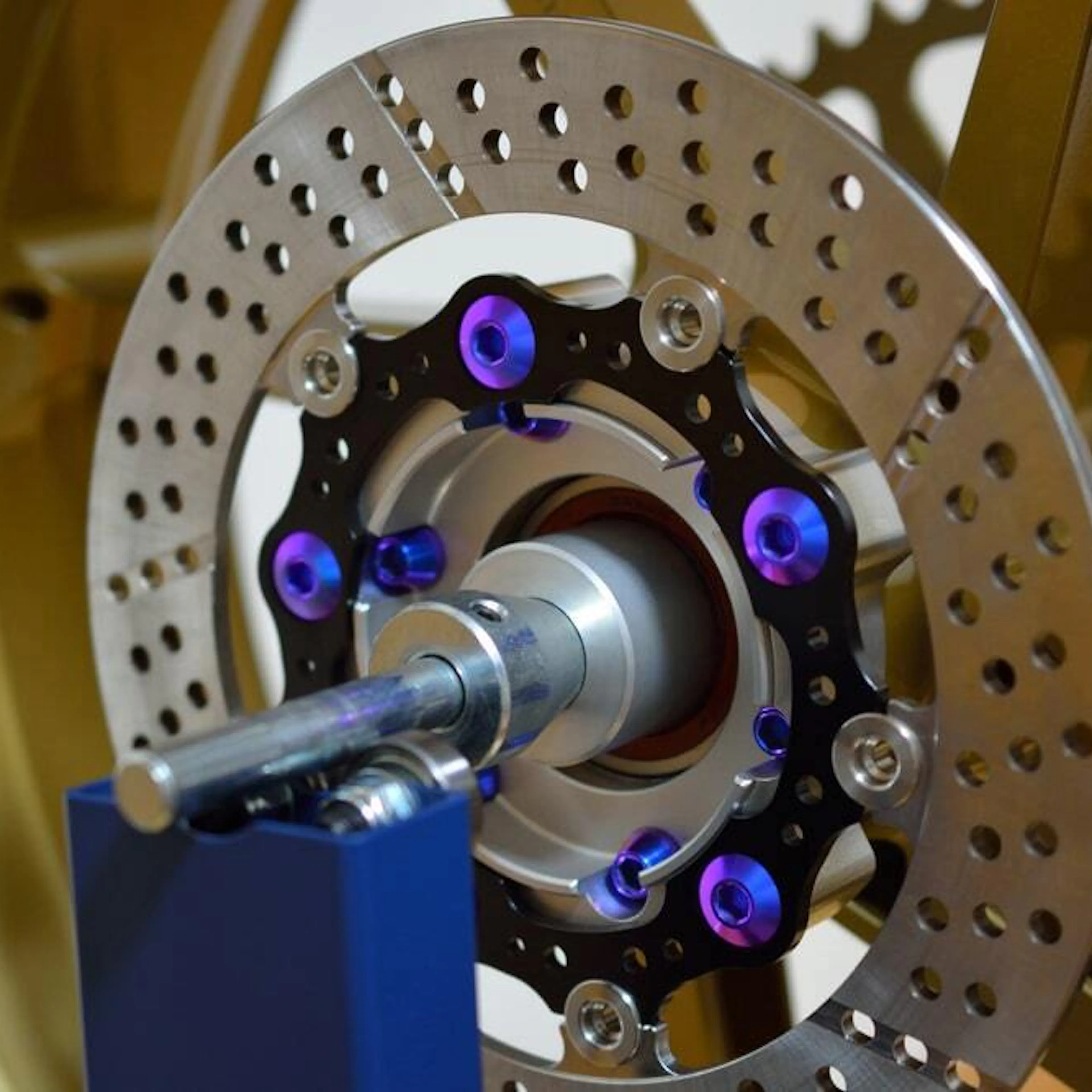

Anodized titanium is used for a broad range of industries where corrosion resistance, biocompatibility, surface hardness, and precise color control are required simultaneously. Medical and surgical applications represent one of the primary use categories, as the oxide layer grown through anodizing is biologically inert and integrates safely with human tissue. Aerospace and aviation rely on anodized titanium fasteners, structural brackets, and housings because the material resists oxidation at elevated temperatures and in oxygen-rich environments. Industrial equipment exposed to chemical processing environments uses anodized titanium components for their resistance to acids, alkalis, and saltwater. Marine hardware, including propeller shafts, fittings, and hull fasteners, benefits from the corrosion resistance of the oxide layer in continuous seawater exposure. Decorative and consumer goods applications take advantage of the vivid, dye-free colors achievable through voltage-controlled anodizing. Jewelry, watch components, eyeglass frames, and sporting goods use anodized titanium for its combination of light weight, durability, and permanent color. The range from medical implants to consumer products reflects the flexibility of the anodizing process in adapting to different performance requirements across industries without altering the underlying titanium alloy composition.
Used in Medical Implants and Surgical Instruments
Anodized titanium in medical implants and surgical instruments creates a biocompatible TiO₂ surface that supports osseointegration when combined with specific surface textures. The oxide layer promotes stable fixation in orthopedic screws, dental implants, and joint components under long-term load. Surgeons apply voltage-based color coding to identify implant diameters, lengths, and tool sizes during time-sensitive procedures. Repeated autoclave sterilization does not degrade the oxide layer, which preserves surface integrity and reduces contamination risk.
Used in Aerospace Components and Aircraft Fasteners
Anodized titanium in aerospace components and aircraft fasteners maintains structural performance under cyclic thermal expansion and contraction. The oxide layer reduces adhesive wear at threaded interfaces and sliding contact zones, which limits surface damage during assembly and disassembly. Engineers select anodized titanium for airframe joints, turbine housings, and critical fasteners exposed to vibration and heat. The combination of low density and high tensile strength improves fuel efficiency while maintaining mechanical reliability.
Used in Industrial Equipment and Chemical Processing Parts
Anodized titanium in industrial equipment and chemical processing parts withstands aggressive chemical exposure without surface breakdown. The oxide layer acts as a barrier against ion exchange, which prevents corrosion in reactors, piping systems, and heat exchangers handling reactive substances. Process industries rely on anodized titanium for handling oxidizing environments, chlorine-based solutions, and specific concentrations of hydrochloric and sulfuric acid. Equipment life extends due to reduced material loss and lower maintenance frequency in harsh processing environments.
Used in Marine Hardware and Corrosion-Resistant Components
Anodized titanium in marine hardware and corrosion-resistant components resists electrochemical reactions in saltwater, where dissimilar metals create galvanic currents. The oxide layer isolates the base metal from electrolytic interaction, which prevents surface degradation over extended exposure periods. Marine applications include propeller shafts, fasteners, anchor systems, and submerged structural fittings operating under constant moisture and pressure. Long-term immersion does not compromise adhesion of the oxide layer, which supports durability in deep-sea conditions.
