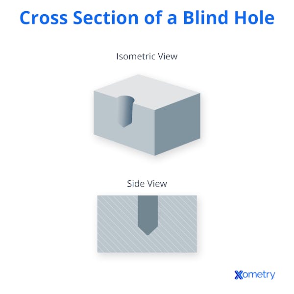

A blind hole is a hole that does not pass completely through a part, meaning it terminates before reaching the opposite surface, regardless of the fraction of total thickness. The depth of a blind hole depends on its function: for threaded holes, it is determined by the required thread engagement and tap clearance; for unthreaded holes, by the intended fit or feature geometry.

views of blind hole
Isometric and side views of a blind hole

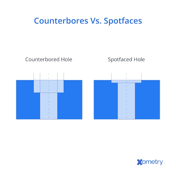

  • Counterbore: A counterbore is a standard hole with a larger, flat-bottomed recess above it. This hole has a flat bottom so that a socket cap fastener will not stick out above the surface of the part.
  • Spotface: A spotface hole is essentially a shallow counterbore hole used to provide a flat mating surface between the underside of the fastener and the material being joined that is perpendicular to the hole’s central axis.
Spotface vs. Counterbore Holes
  • Countersunk: A countersunk hole is similar to a counterbore hole, but has a conical hole above the standard hole. A flat-head socket screw is used in these types of holes.
