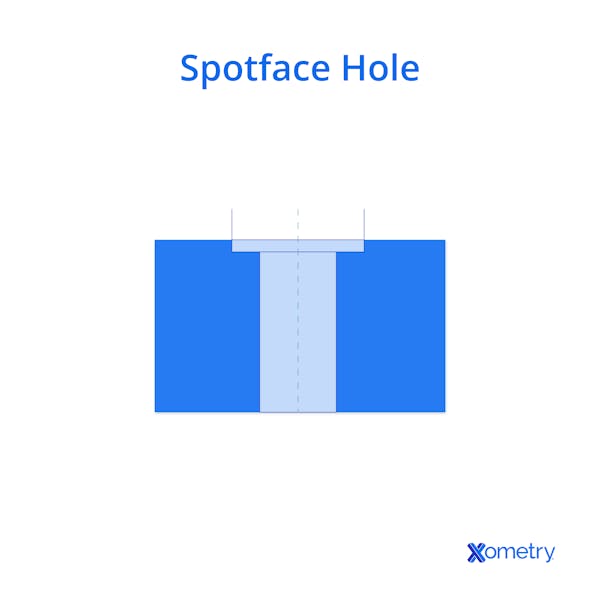

A spotface is a flat-faced, shallow cylindrical recess that is larger in diameter than the hole it is concentric with. It is cut to impose a flat landing surface for contacting/mating parts, such as washers or fastener heads. The primary reasons for spot-facing holes are:
  1. To provide a stable, flat surface for fasteners or washers on an otherwise rough or uneven part.
  2. To provide the same flat landing surface on an otherwise curved surface of a part.
Spotfacing and counterboring use similar tooling, but a spotface is a shallow flat seat, while a counterbore is deeper to recess the fastener head. This article will further discuss spotface holes, how to drill one, how to choose the right tap, as well as the applications and uses of a spotface hole.
An illustration of a spotface hole

There is no single universal chart that governs spotface sizing across industries. Designers and machinists size the diameter and depth per application, and some organizations or fastener standards provide reference tables that may inform sizing.
In general, spot-facing is sized to be larger than the part that is designed to land upon it. It should have sufficient depth to ensure a fully annular flat surface, removing all curvature or roughness from the landing surface.
Some corporate manuals, such as Boeing’s BDM-1327, specify the nominal spotface diameter as the cutter size, defined as the flat seat diameter plus twice the cutter corner radius. ASME Y14.5-2009 defines the drawing callout for a spotface. The specified diameter refers to the flat seat size, and the standard does not include a universal allowance for tool radii.
