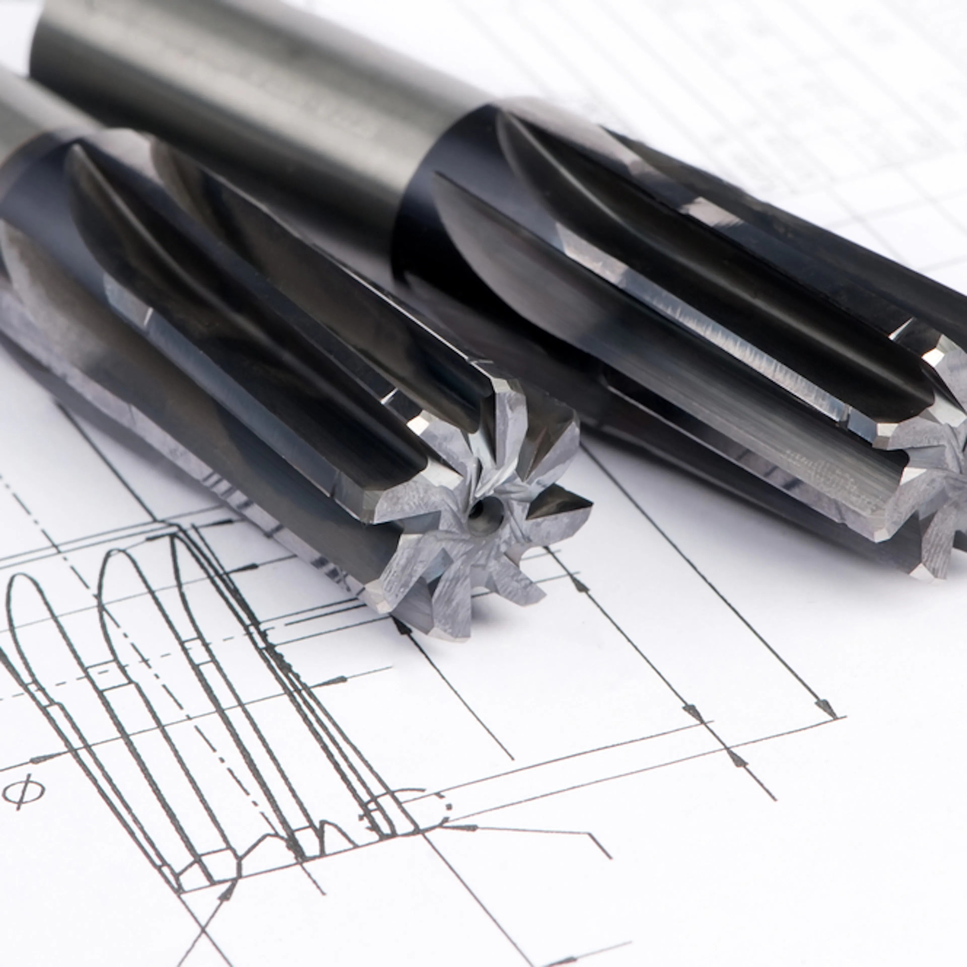

Reamers. Image Credit: Shutterstock.com/Sugrit Jiranarak
