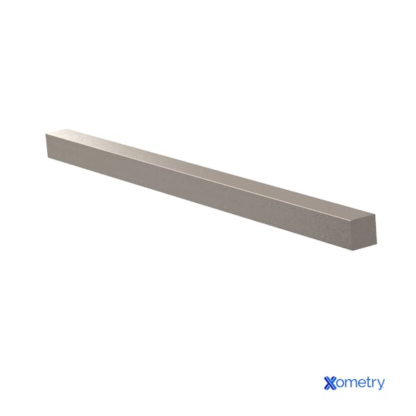

1. Bars and Rods
Bars and rods are long, cylindrical shapes of 4140 alloy steel. The forms are used in machining and manufacturing, where they are processed into shafts, bolts, and other cylindrical components that require high strength and precision. Bars and rods are preferred in applications where high tensile strength and toughness are needed to withstand mechanical stress. The forms are used in industries such as automotive, aerospace, and machinery, where strong and durable components are crucial for performance.
