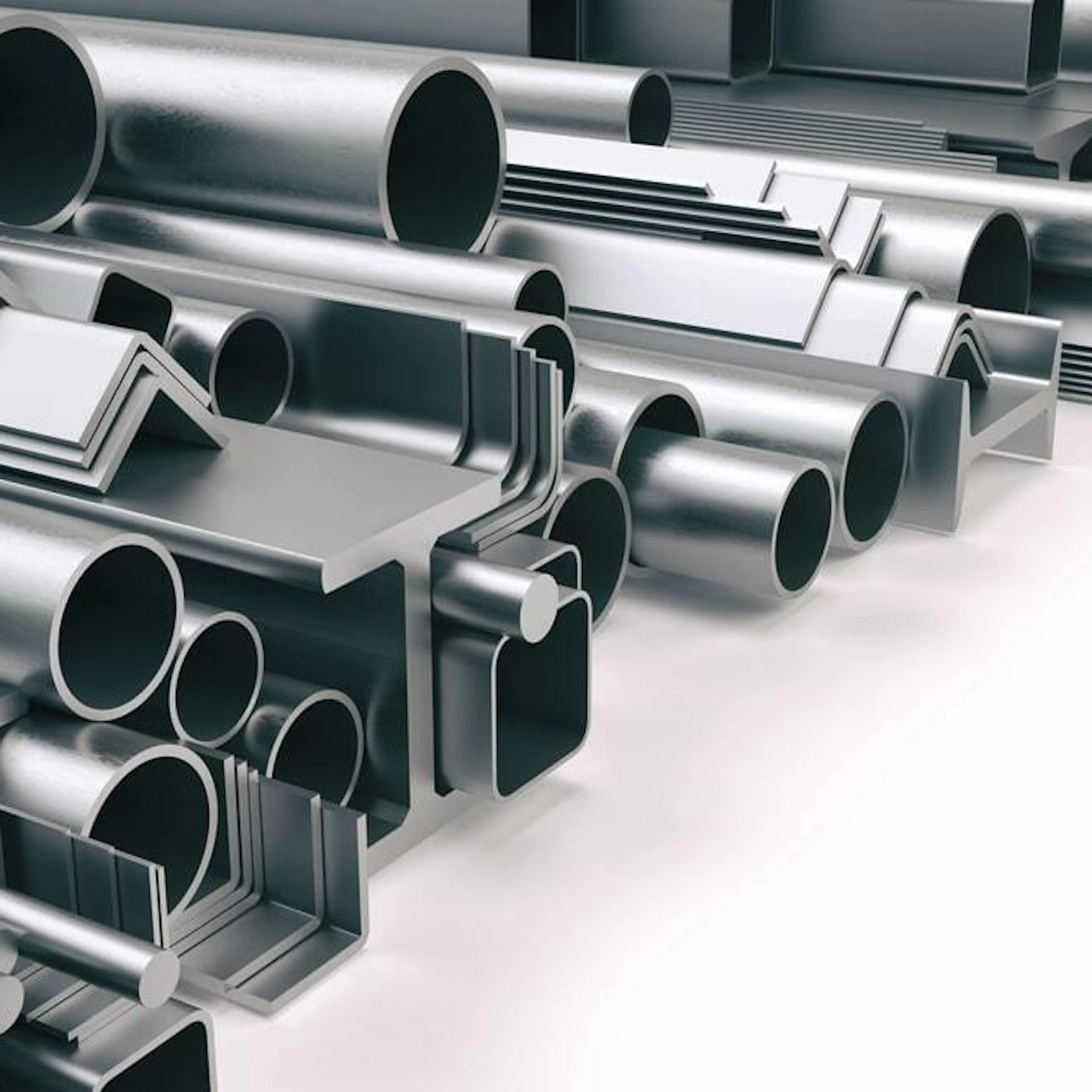

Various types of metal on a white background. Image Credit: Shutterstock.com/Maxx-Studio

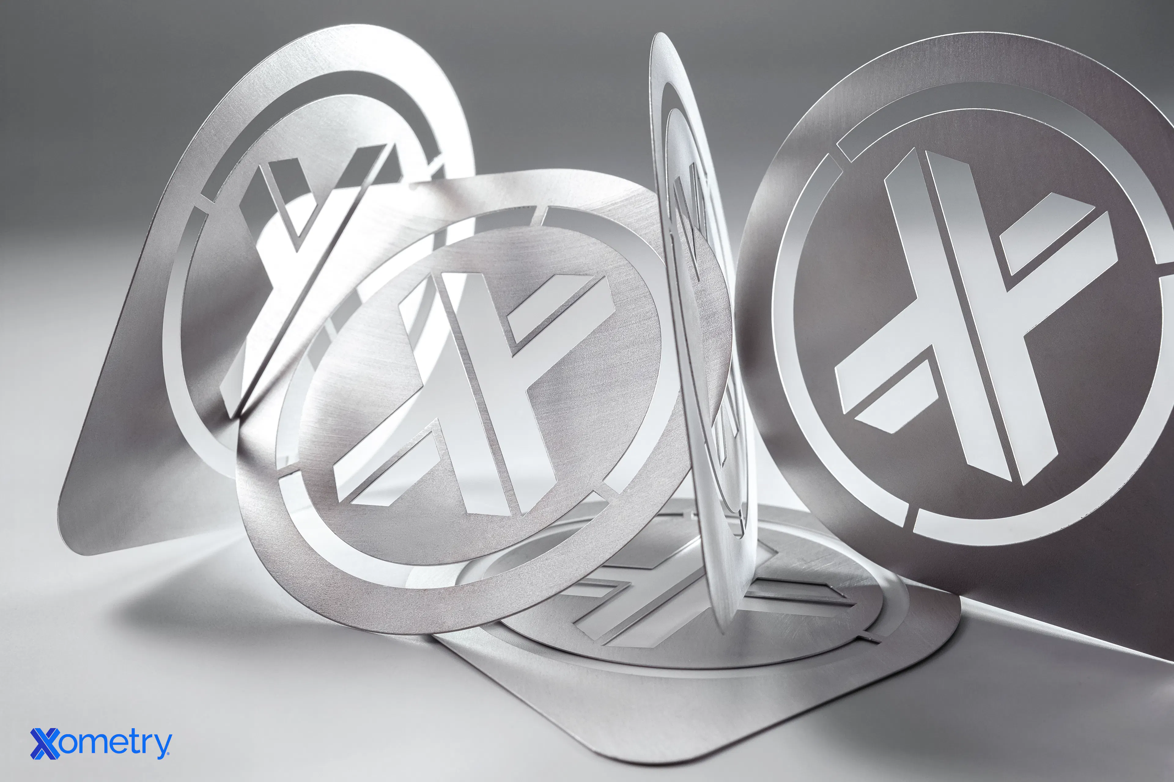

Aluminum sheet metal manufactured by Xometry
