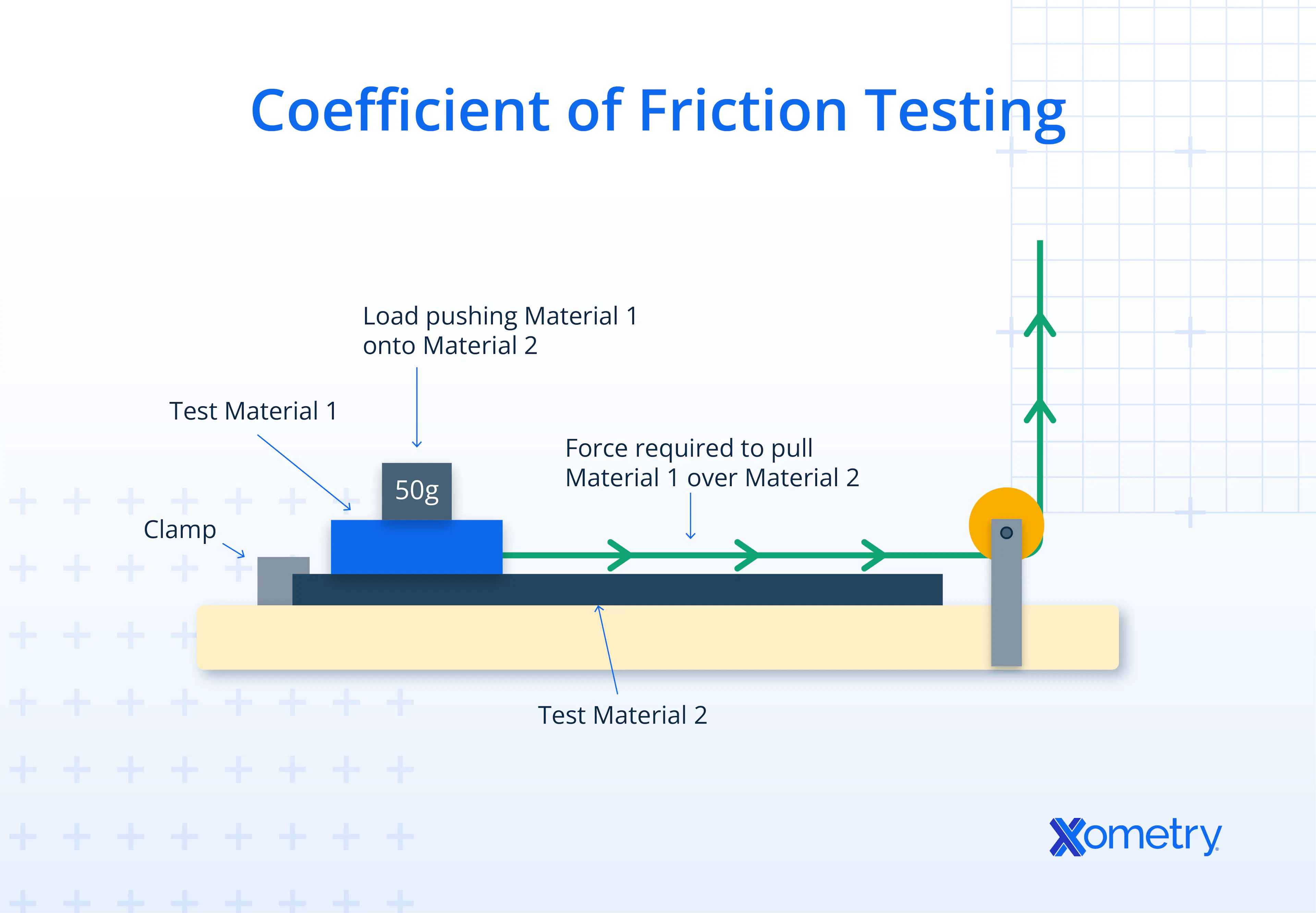

How Does Coefficient of Friction Testing Work?
Coefficient of friction testing measures both static and kinetic friction. The test essentially works by causing a weight (sled) to slide over a flat surface (plane) and measuring either the force needed to initiate movement (static) or during continuous movement (kinetic).
Different geometric arrangements can be used to create this movement. The most widely used is a horizontal plane, which can be performed with a dedicated friction testing machine or a universal testing machine. The plane can be stationary with a moving sled, or the sled can be stationary against a moving plane. The material to be tested is typically used to cover the surfaces of both the sled and the plane. As they are caused to move relative to each other, the horizontal force on the sled is measured accurately.
Another arrangement for testing the coefficient of friction is the inclined plane method. This uses a plane that can be tilted, with a stationary sled that rests on top of it. The angle of the plane is increased until it is steep enough that the sled moves. The critical angle is used to calculate the static coefficient of friction.

A diagram of coefficient of friction testing.

What Is the Coefficient of Friction Testing Procedure?
To test the kinetic coefficient of friction, the following procedure is followed:
  1. Select the material that is to be tested. Depending on the details of the standardized test, you may need to prepare two pieces — one for the sled and another for the plane. The material should be clean and without creases or blemishes.
  2. Prepare the testing equipment. The CoF tester must be on a flat, completely level surface. The various test parameters will need to be entered into the tester, such as sliding speed and applied load.
  3. Run the test with the sled moving relative to the flat plane while the frictional force required to move the sled is recorded.
  4. Measure the normal force. It is important to confirm the normal force, the force acting perpendicular to the moving surface. This is essentially the weight of the sled.
  5. Calculate the coefficient of friction. The CoF is simply the drag force (frictional force) divided by the normal force. Typically, the average drag force over the test required to keep the sled moving is used in the calculation of the coefficient of friction
To test the static coefficient of friction, the force required to initiate the movement of the sled is required:
  1. Select the material to be tested. Prepare two pieces of the material—one for the sled and another for the plane. The materials should be clean and free from defects such as creases or blemishes.
  2. Prepare the testing equipment. The CoF tester must be placed on a flat, level surface. Ensure that the sled is positioned at rest against the plane. Enter the relevant test parameters into the tester, such as the applied load.
  3. Run the test. Gradually apply force to the sled, either manually or using a controlled mechanism, until the sled begins to move relative to the plane. The force required to initiate motion is recorded.
  4. Measure the normal force. Confirm the normal force, which is the force acting vertically downward on the sled (typically its weight).
  5. Calculate the static coefficient of friction. The static CoF is calculated as the force required to initiate movement (the frictional force) divided by the normal force (the weight acting downward).
