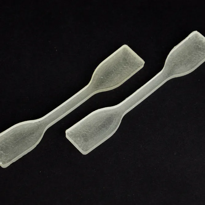

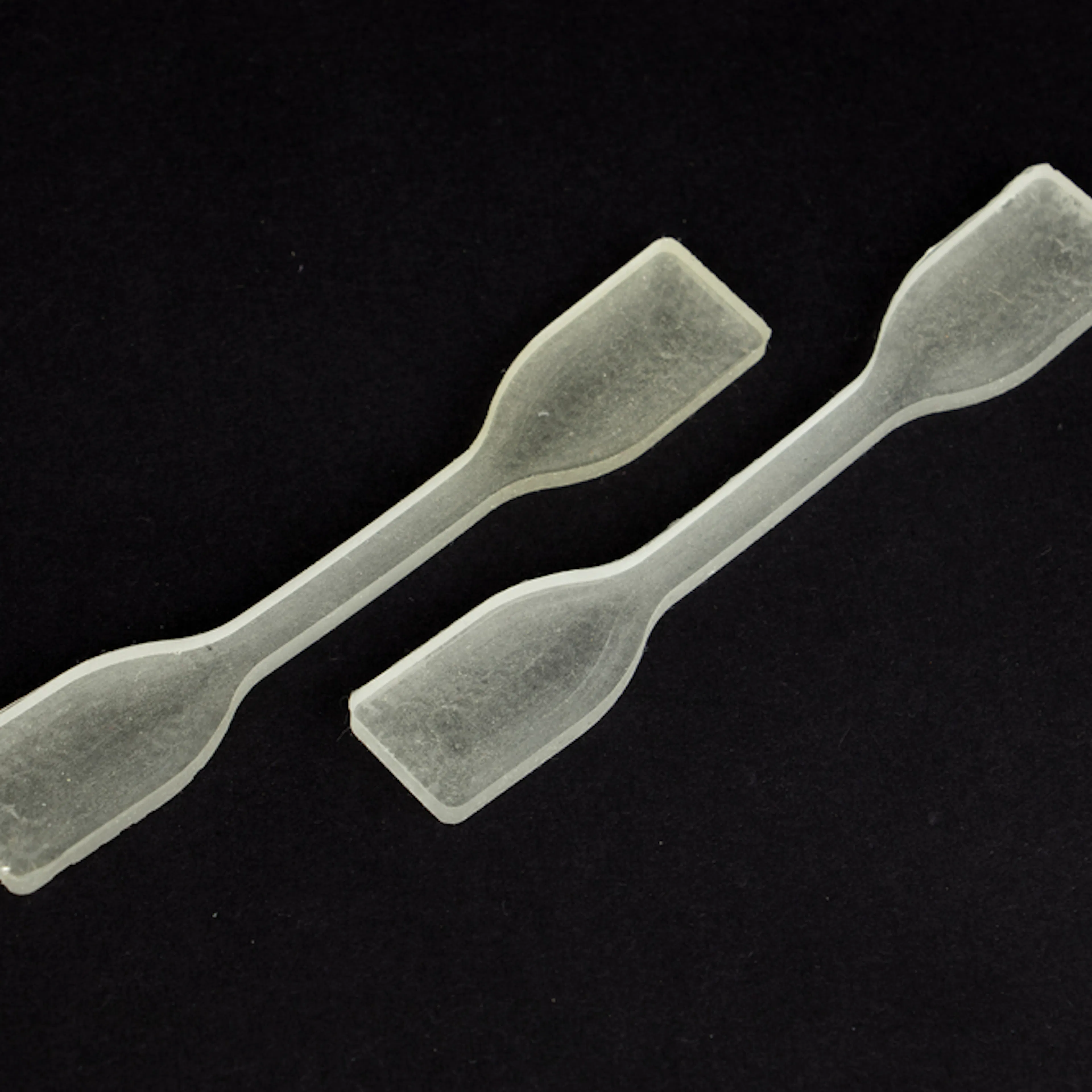

Polymer sample. Image Credit: Shutterstock.com/bartu
