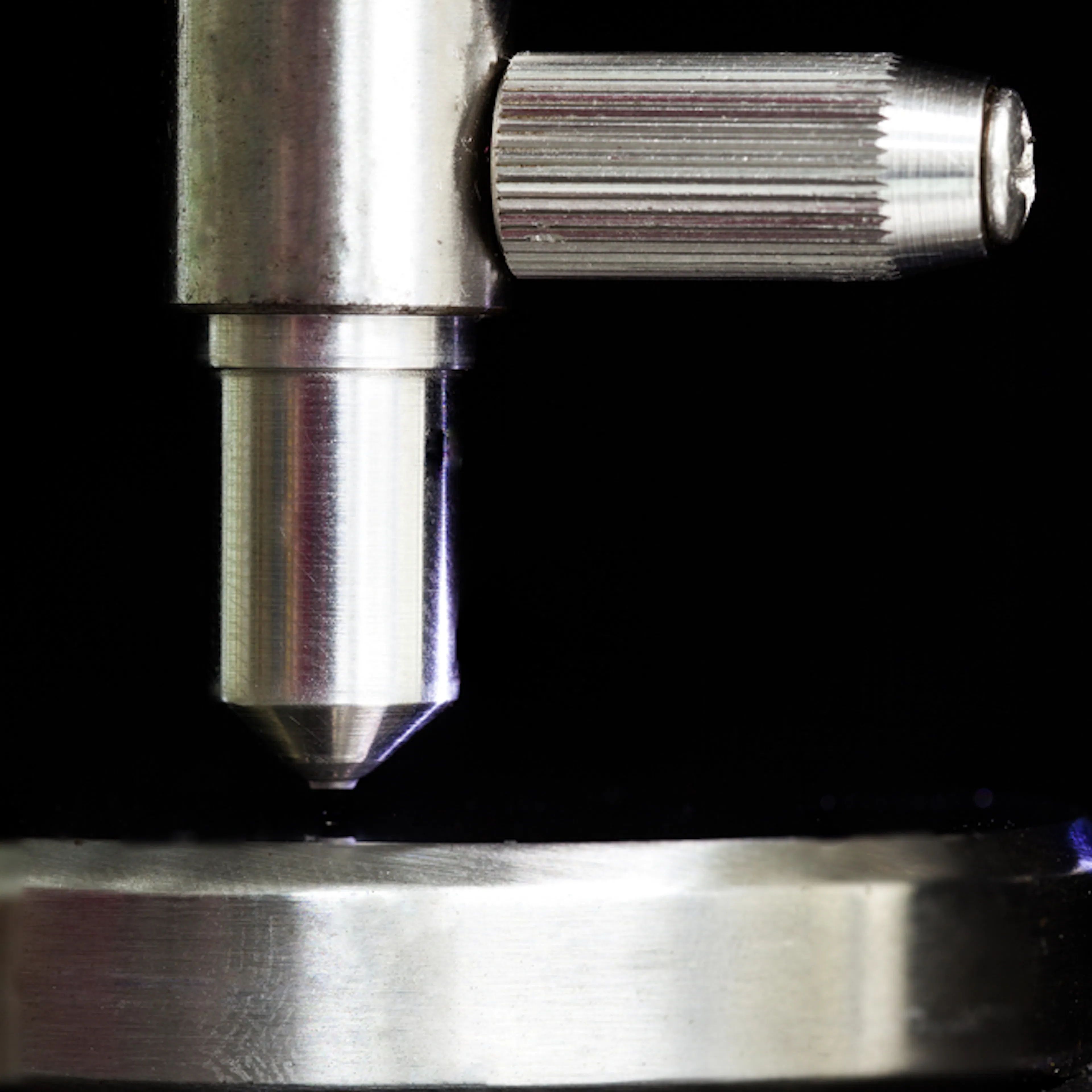

Hardness testing works by pressing a standardized, hard instrument into the material that is being tested. The instrument, called an indenter, is pressed into the sample for a standardized length of time (a number of seconds), and with a specific load (force) behind it. When the indenter is pressed into the material, it deforms the surface of the material by a measurable amount. This deformation is then measured, and the measurement is used to assign a hardness value to the material according to the test’s specific scale.

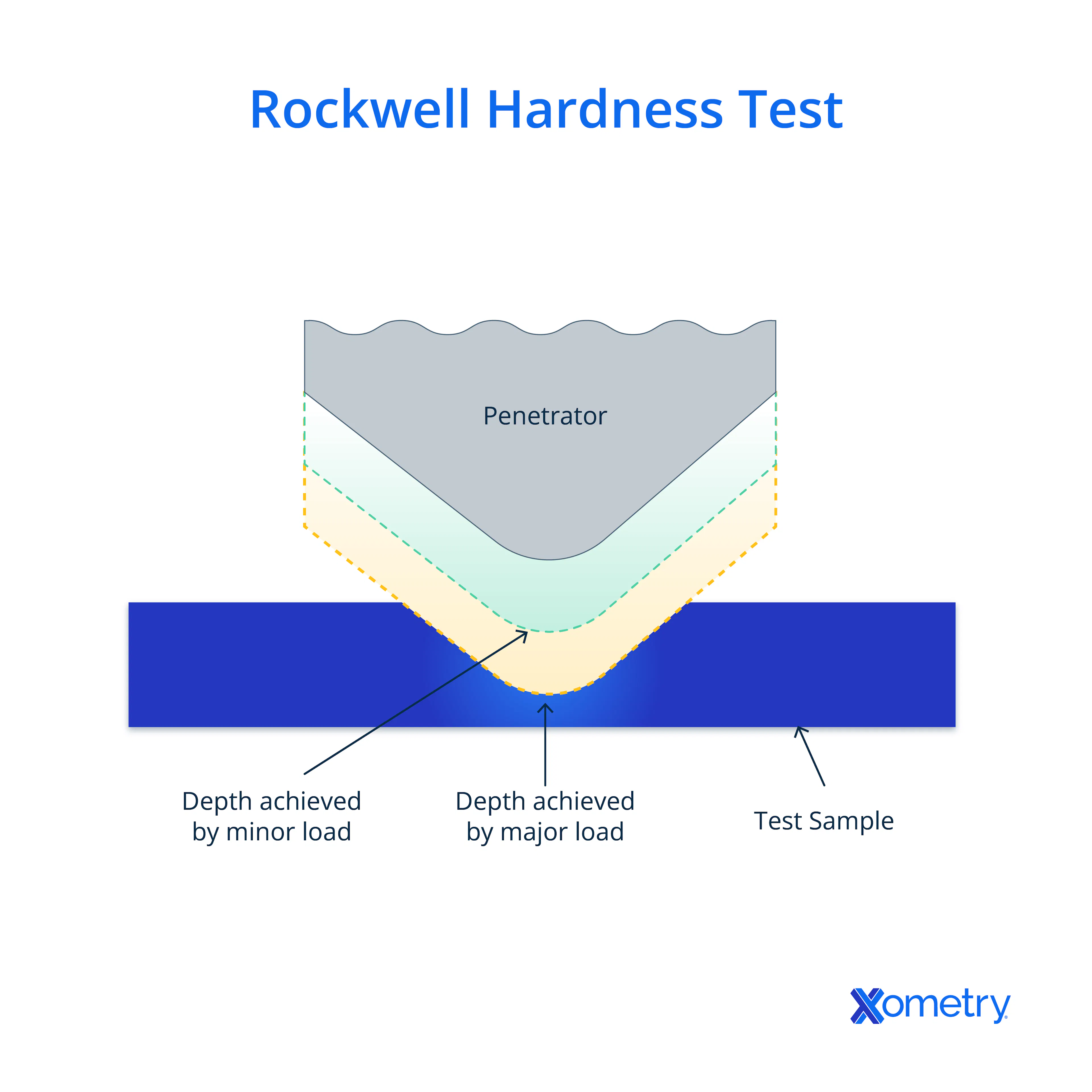

  1. Rockwell: Developed to give a quick reading, mainly for metallic samples. The depth of the deformation made by the indenter is measured, and a deeper indentation is assigned a lower number, indicating a softer material. Two broad types of tests are used: the Rockwell superficial hardness and the Rockwell regular hardness tests.

Rockwell hardness test image
Rockwell hardness test, a type of hardness test
