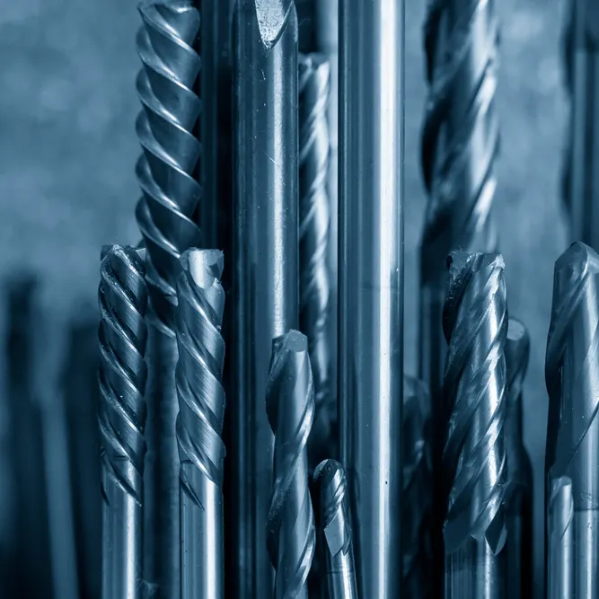

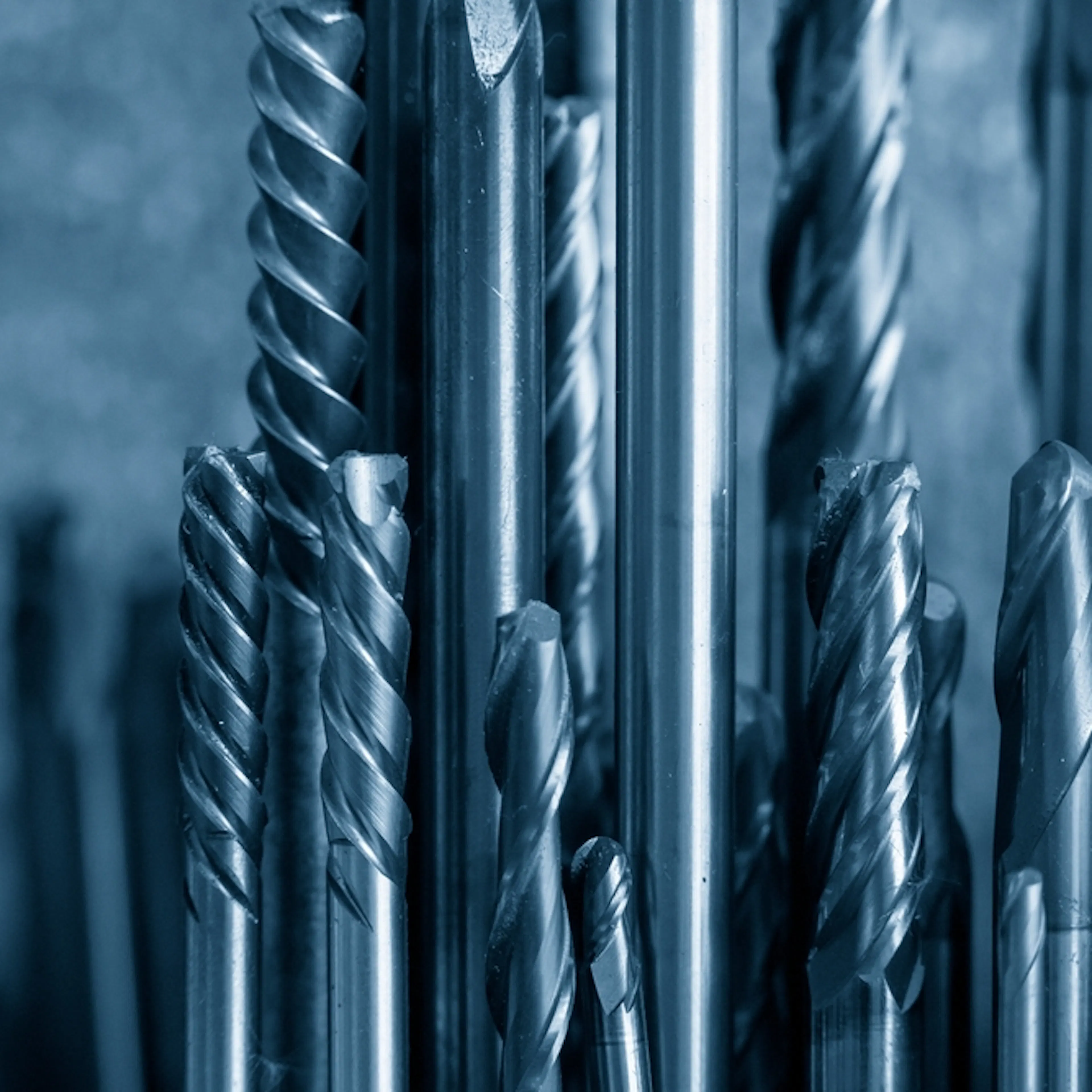

High speed steel drill bits. Image Credit: Shutterstock.com/Pixel B
