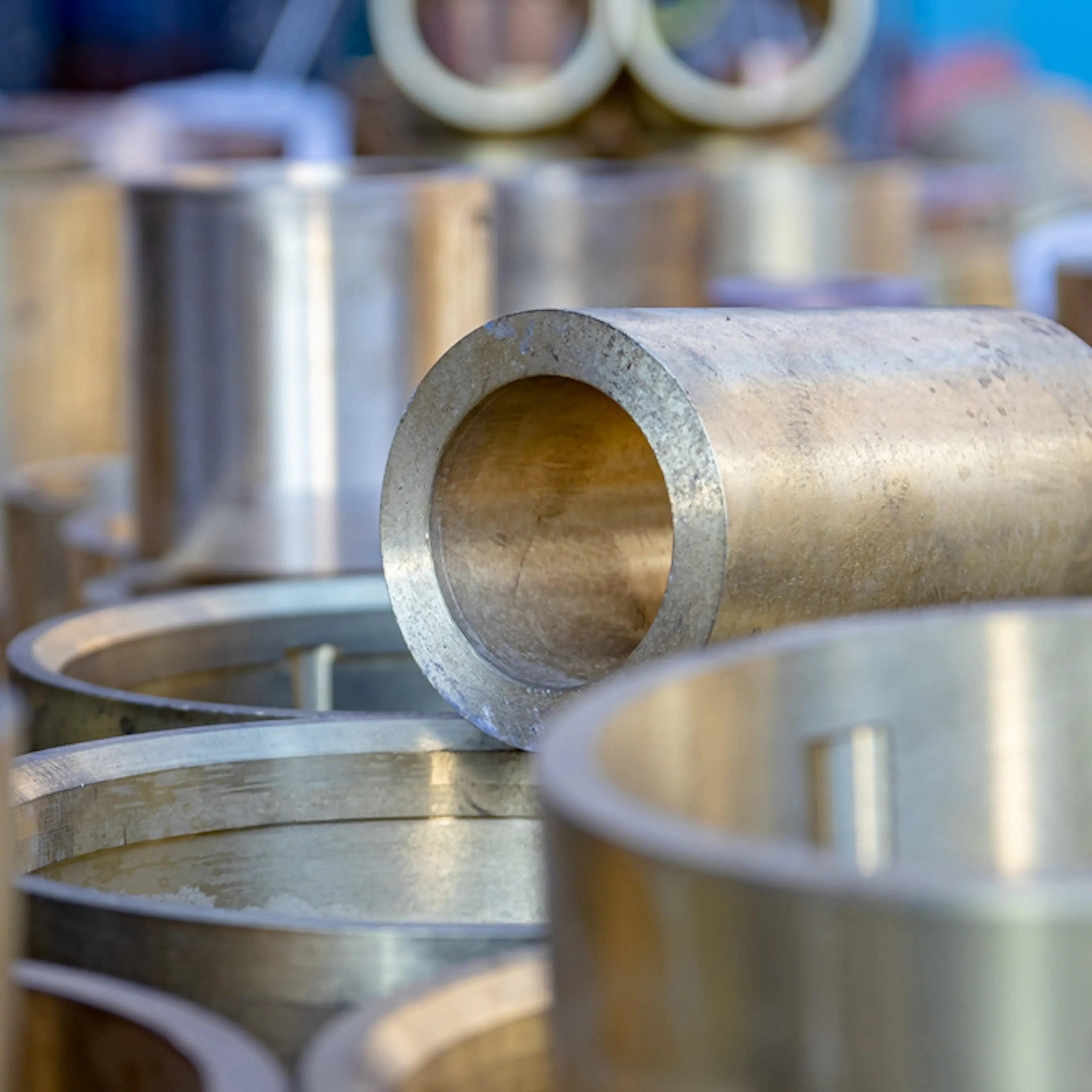

Nickel-aluminum bronze bushing. Image Credit: Shutterstock.com/Alexei A65
