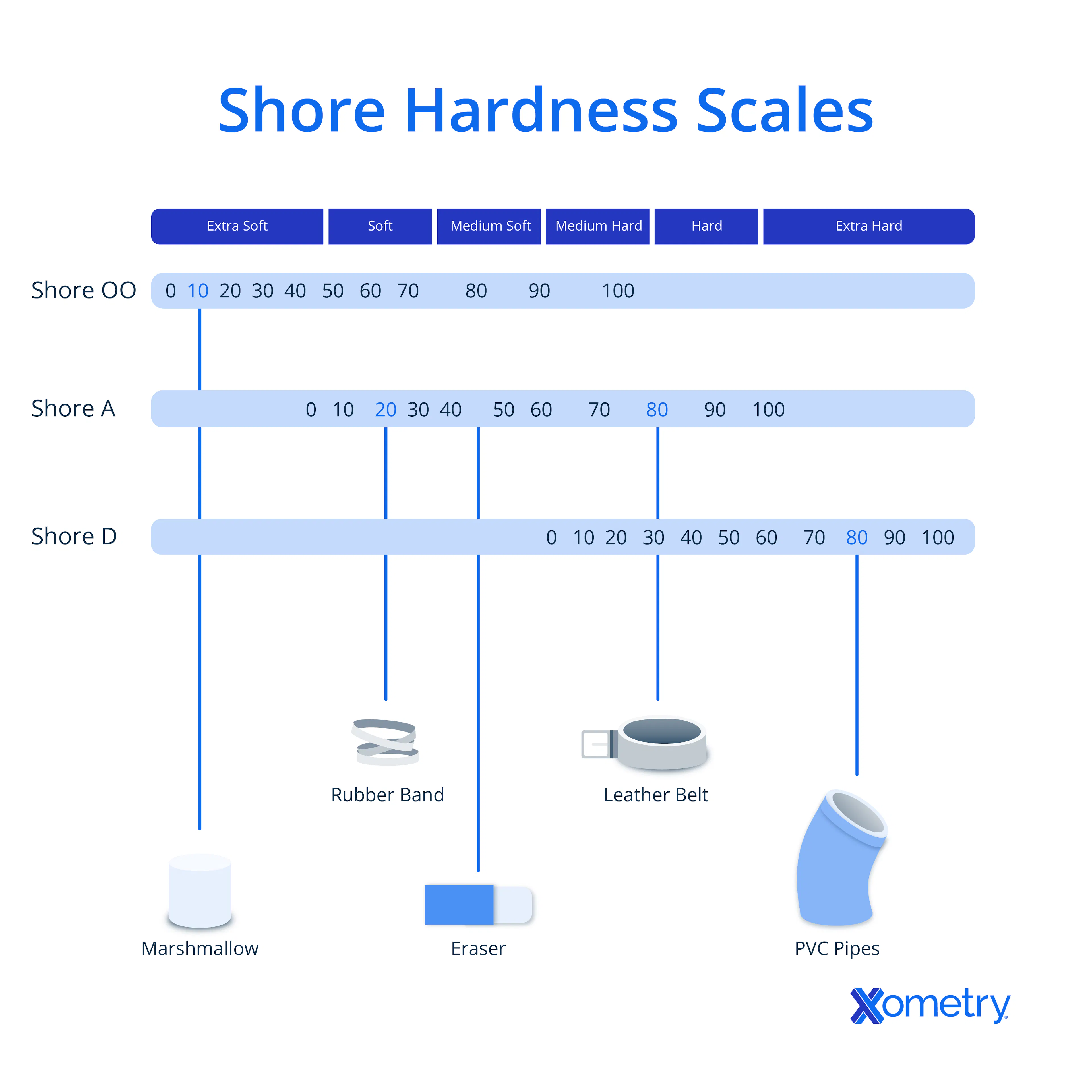

The Shore A scale and Shore D scale overlap at higher values of the Shore A scale and lower values for the Shore D scale. Lower values of the Shore A scale overlap with the Shore 00 scale. The Shore D scale starts at approximately 60 A while the Shore 00 scale maxes at about 70A.
Shore A - Shore D Hardness Scale
It is important to note that hardness values should only be used as a point of reference if being compared on the same scale. Do not compare Shore A values with Shore D values to make material selections, as the slope of hardness values from 0 to 100 differ greatly between the two scales. For instance, Shore A 50 is not the same as Shore D 50. Some examples of materials whose hardness can be expressed with either the Shore A and Shore D scales are listed below:
  1. A tire tread can have a hardness of 70 A(~10 D).
  2. A leather belt can have a hardness of about 80 A (~40 D).
  3. A golf ball can have a hardness of 90 A(~50 D).
