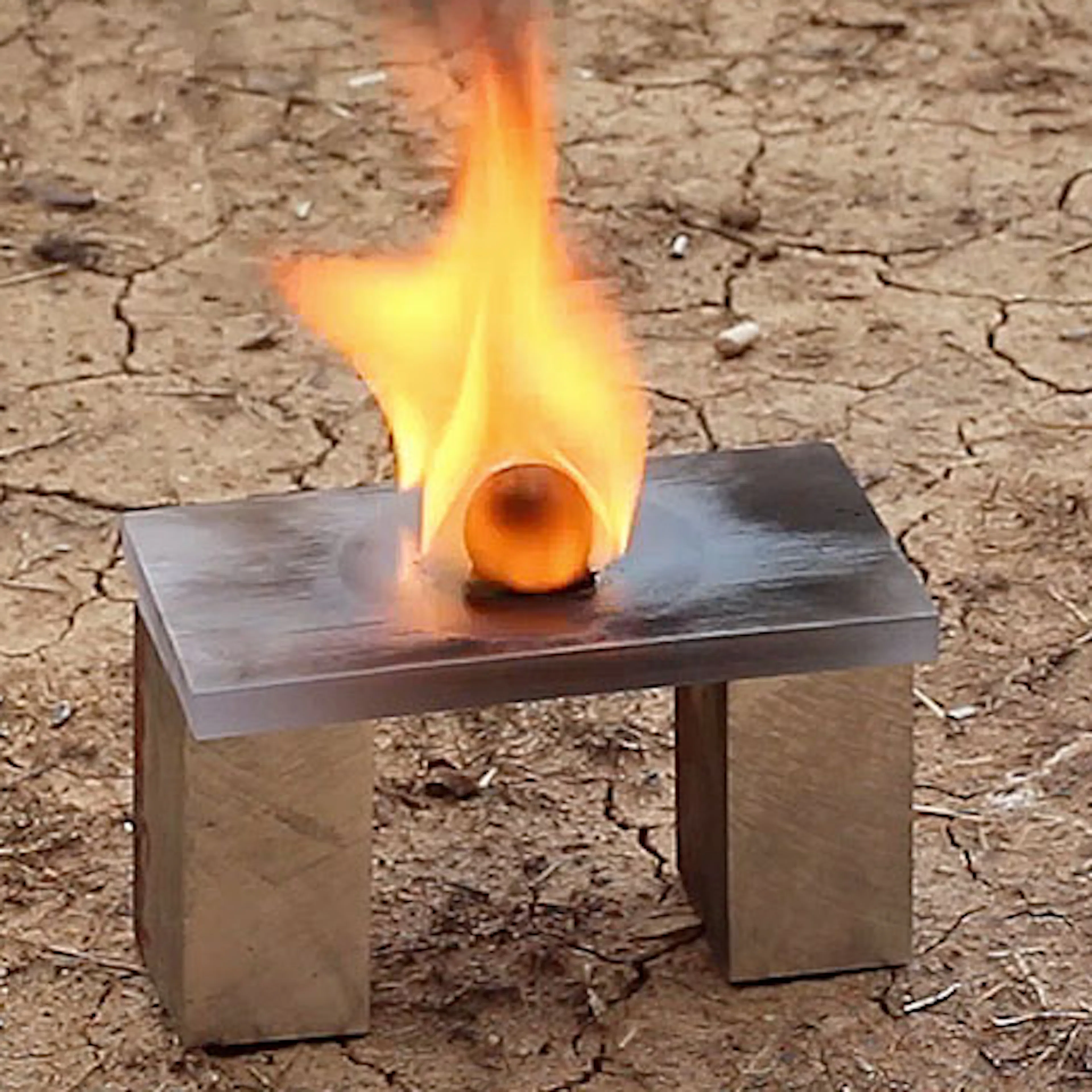

What it is, how it works, and why it’s important
PolyJet is not flame retardant and will catch fire
Thermal resistance is an essential parameter in engineering, physics, thermodynamics, and even manufacturing. It plays an important role in the design and optimization of thermal systems, like electronic devices, insulation materials, and building envelopes. Here’s everything you need to know, including how to calculate it in every material.

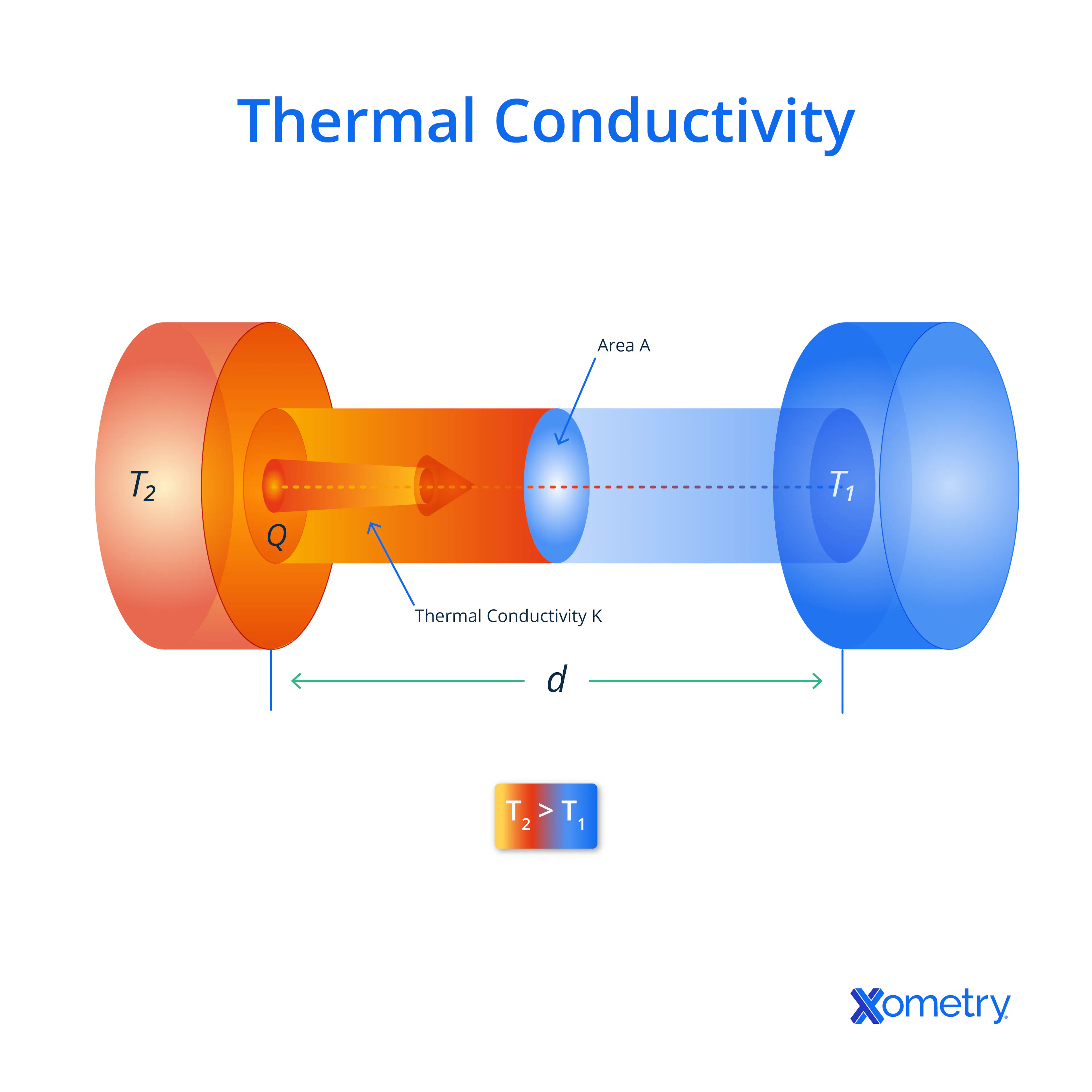

Thickness: Thicker materials generally resist heat transfer better than thin ones. The precise relationship between thickness and thermal resistance ultimately depends on the material’s characteristics and the mode of heat transfer.
thermal conductivity
Thermal conductivity
How Does Thermal Resistance Work?
A material's thermal resistance is a measure of how difficult it is for heat to pass through it. It is determined by the thermal conductivity and thickness of the material. Highly resistive materials, like insulators, slow the transfer of heat while those with low thermal resistance, like metals, facilitate it.

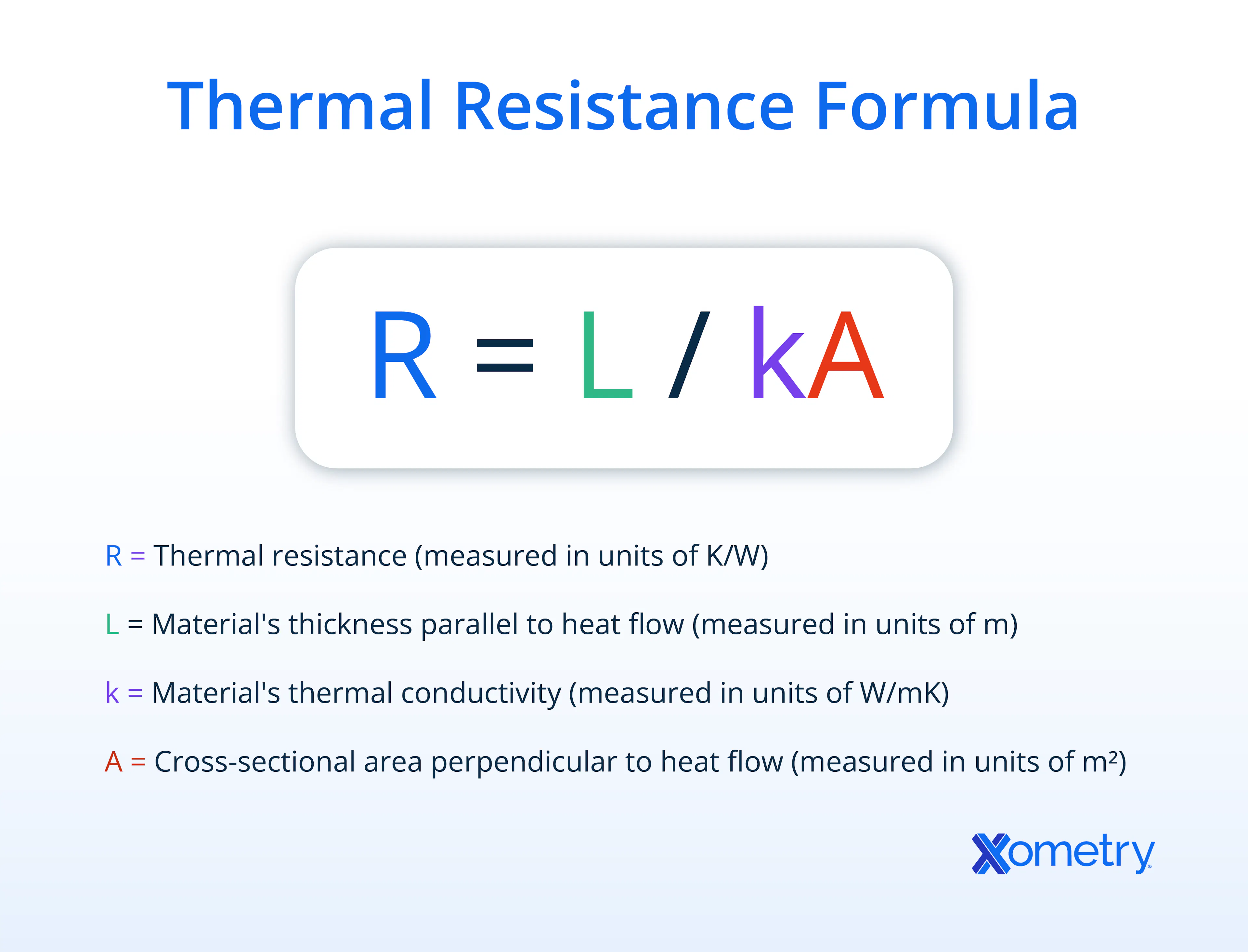

What Is the Formula for Thermal Resistance?
Here’s the technical bit. To calculate the thermal resistance in a material, you’ll first need to know the keys:
R = Thermal resistance (degrees Kelvin per watt (K/W) or Celsius per watt (°C/W))
L = Thickness of the material (m) perpendicular to the heat flow
k = Thermal conductivity (W/mK) (how well the material conducts heat)
A = Cross-sectional area perpendicular to heat flow (m²)
The thermal resistance of a flat object and some popular 3D printing materials can be determined by the following equation for steady-state heat transfer, which basically translates to “thermal resistance = thickness / (area x thermal conductivity):
R = L / kA
So, as you can see, to figure out the thermal resistance of a material, you’ll need to know its thickness, cross-sectional area, and thermal conductivity. Measuring the thickness and cross-sectional area is pretty straightforward and can be done with a ruler or caliper. You’ll need to refer to the Material Safety Data Sheet to find its thermal conductivity. Once you’ve got all that info, you can go ahead and do the equation.
The thermal resistance formula for conductive heat transfer is a rearranged version of Fourier’s Law of Heat Conduction:
Q = kAΔT / L
Q = Heat transfer rate (W)
ΔT = Temperature difference across the material (K or °C)
Thermal resistance formula
