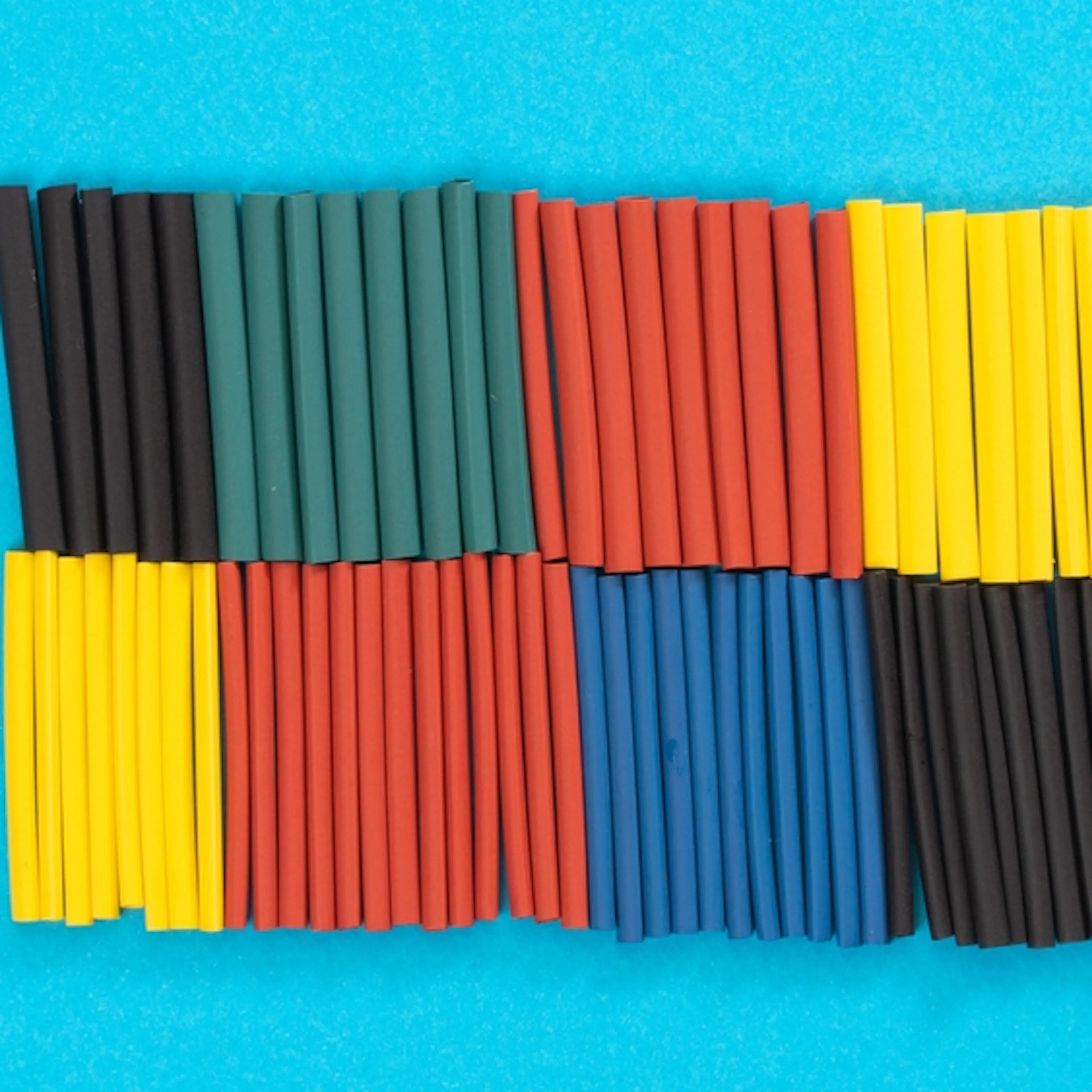

Thermoplastic rubber charging wire braids. Image Credit: Shutterstock.com/voktybre
