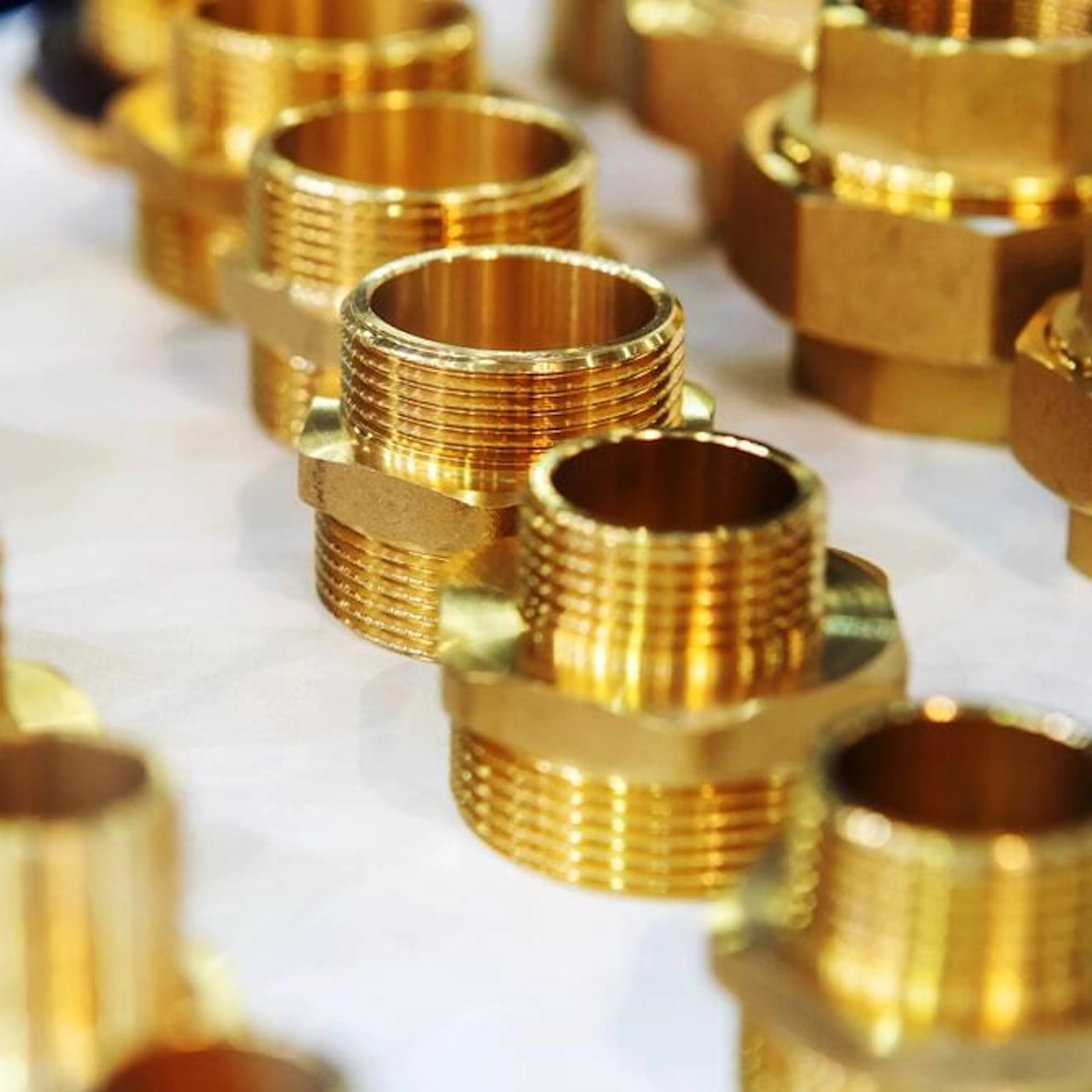

Brass pipe fittings. Image Credit: Shutterstock.com/Dmitry Markov152

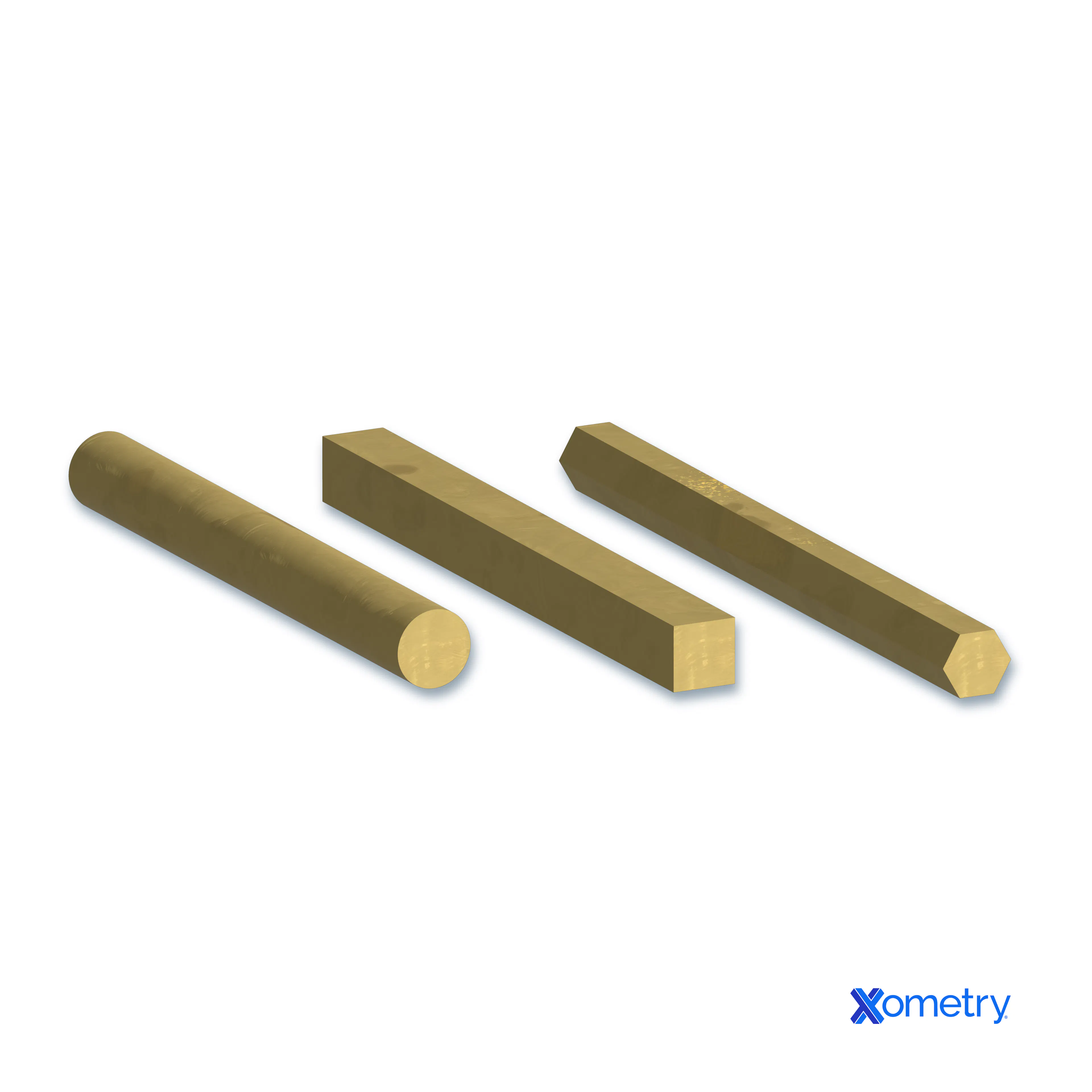

This article will discuss what brass is and the various types of brass, as well as their mechanical and chemical properties. Figure 1 below shows some brass bars:
brass bars
Brass bars
