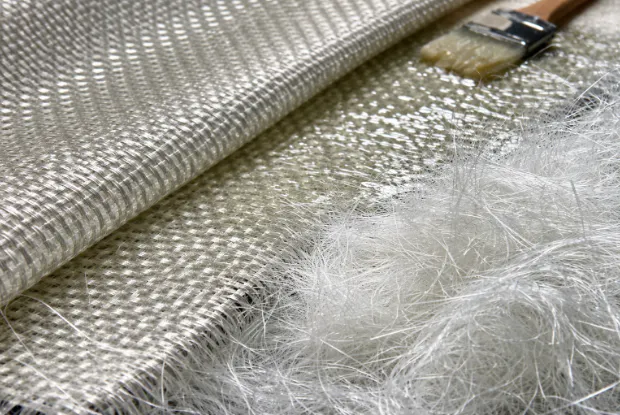

Fiberglass. Image Credit: Shutterstock.com/MAKUYI
Fiberglass, also known as fibreglass, glass fiber, or fiber glass, is a versatile composite material made from fine glass fibers combined with a resin matrix. Fiberglass is widely used in industries such as construction, automotive, aerospace, marine, and consumer goods due to its high strength-to-weight ratio, corrosion resistance, and moldability. It is crucial in modern manufacturing because it provides a lightweight, durable, and cost-effective solution for producing a variety of parts and products that require both strength and resistance to environmental elements.
The material’s ability to be molded into complex shapes and its performance in harsh environments make it essential for industries that demand both structural integrity and ease of processing. Fiberglass is used in applications ranging from boat hulls and swimming pools to car bodies, aerospace components, and insulation materials.
Below is an introductory visual showing the texture of fiberglass and its reinforcement material, often woven or layered to provide additional strength and flexibility. The characteristic structure makes fiberglass ideal for reinforcing materials like plastics or creating standalone products that require robust performance under stress.

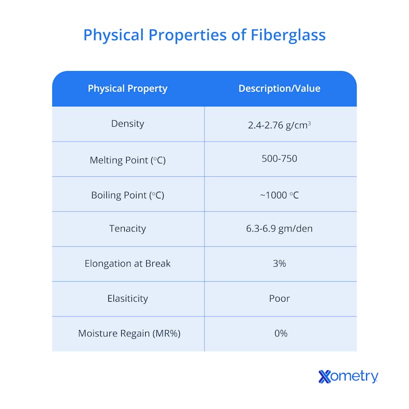

fiberglass physical properties chart
The physical properties of fiberglass.

What Are the Physical Properties of Fiberglass?
The physical properties of some common fiberglass types are given in Table 2:
Physical PropertyDescription/Value
Physical Property
Density
Description/Value
2.44 to 2.60 g/cm³
Physical Property
Melting Point (°C)
Description/Value
840-870
Physical Property
Boiling Point (°C)
Description/Value
~2000 °C
Physical Property
Tenacity
Description/Value
5.5–7.5 g/den
Physical Property
Elongation at Break
Description/Value
5%
Physical Property
Elasticity
Description/Value
Brittle
Physical Property
Moisture Regain (MR%)
Description/Value
0%
Table 2: Physical Properties of Fiberglass
