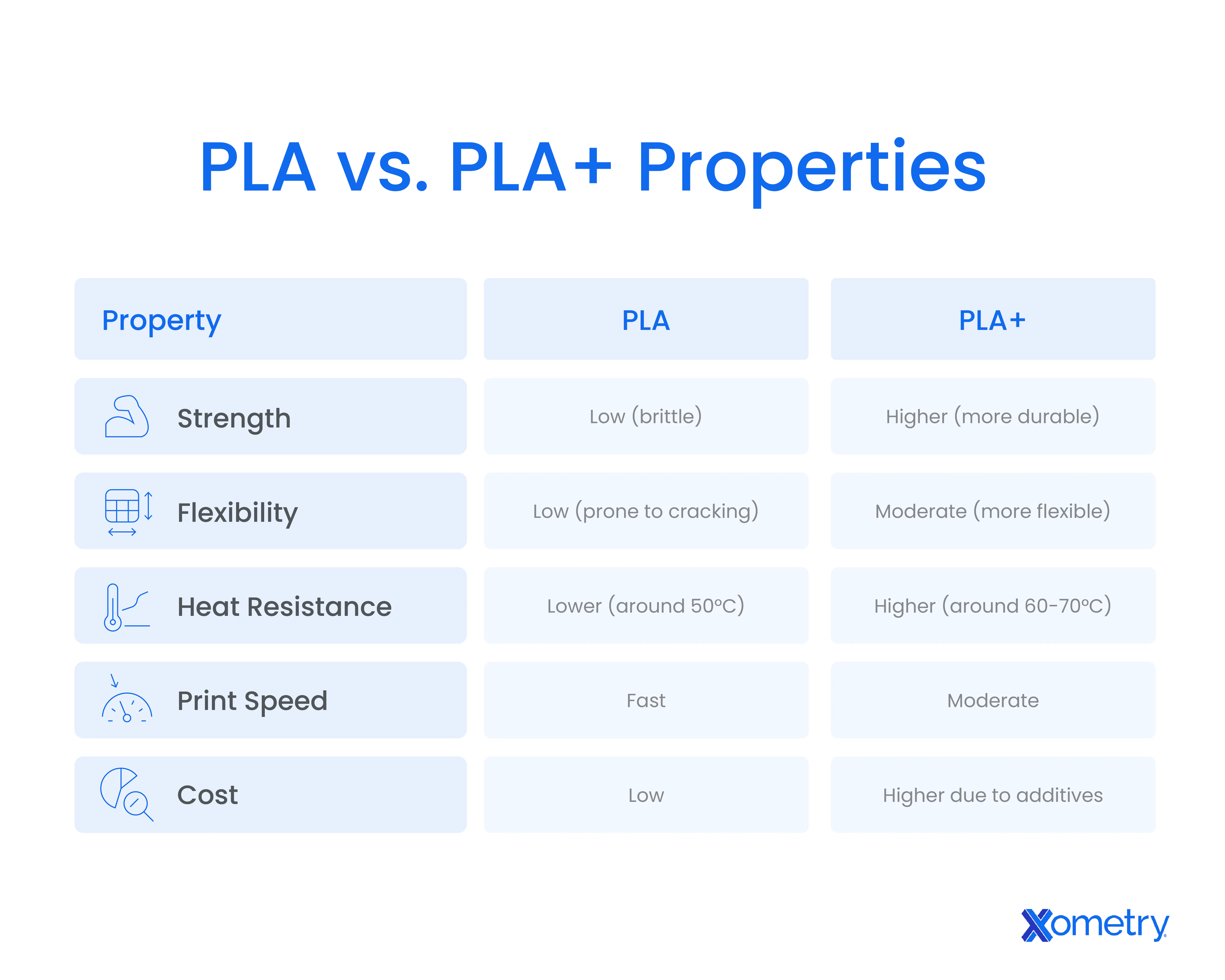

PLA vs. PLA+ Properties
What Are the Disadvantages of PLA Compared to PLA+?
The Disadvantages of PLA compared to PLA+ are listed below.
  • Brittleness: PLA is more brittle compared to PLA+, which results in cracks or breaks under stress or impact. PLA's lack of flexibility makes it unsuitable for parts that need to withstand mechanical stress. PLA+ overcomes limitations by increasing toughness and strength, offering better impact resistance and durability for more demanding applications. The added PLA+ strength makes PLA+ a better choice for parts requiring more resilience.
  • Low Heat Resistance: PLA softens at relatively low temperatures around 60°C (140°F), which is problematic for items exposed to heat. PLA+ addresses the issue by offering higher heat resistance, making it more suitable for functional parts exposed to warmer environments. The answer to the question, ‘What temperature does PLA soften? PLA softens at a lower temperature compared to PLA+, which withstands higher temperatures due to its improved thermal stability.

PLA vs. PLA+: Heat Resistance Comparison
The PLA vs. PLA+ heat resistance comparison highlights that PLA has relatively low heat resistance and begins to soften near its glass transition temperature of approximately 55–60 °C. PLA+ withstands higher temperatures, making it more suitable for applications exposed to heat. PLA+ formulations have better heat resistance than PLA. It is because PLA+ contains additives that allow it to maintain its mechanical properties at higher temperatures than standard PLA. However, not every PLA+ material has better heat resistance than PLA. Some PLA+ materials have equivalent heat resistance to standard PLA.

PLA vs. PLA+: Cost Comparison
The PLA vs. PLA+ cost comparison shows that PLA is more affordable due to its simpler composition. PLA+ tends to be more expensive due to the additives that enhance its strength and durability. Standard PLA costs [$15 to 20] per kg of filament. PLA+ starts at $25/kg and can reach $35/kg.
