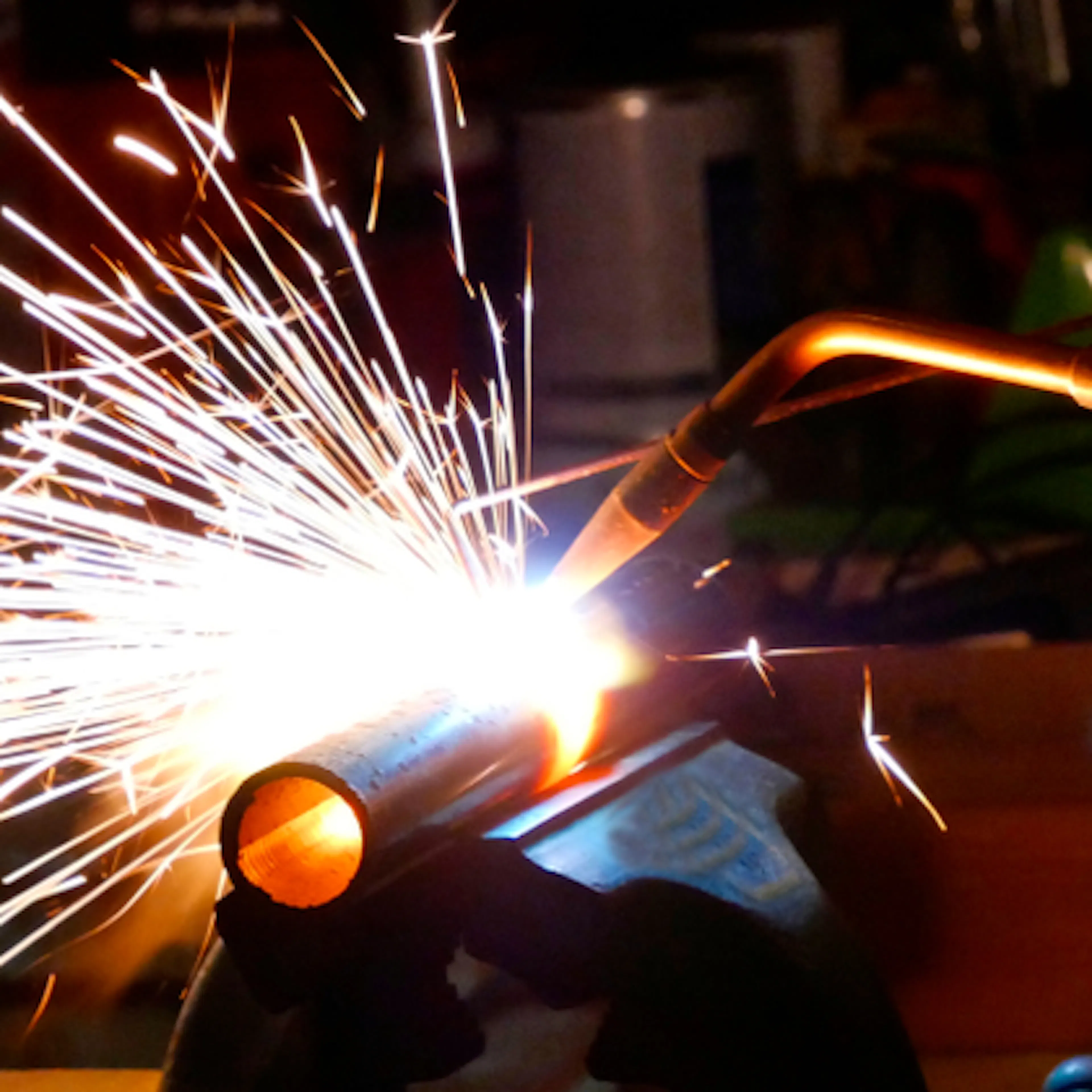

3. Oxy-Acetylene Welding
Oxy-acetylene welding is the most common type of gas welding. A mixture of oxygen and acetylene is burned to create a high-temperature flame, which then heats and melts the metals to be welded. Two pressurized gas cylinders must be provided, one of oxygen, and the other of acetylene. The ratio of the two gases in the mixture changes the characteristic of the flame created by the gas torch. As a result, the flame can be lean in acetylene fuel, rich, or balanced. This method can be applied to a range of ferrous and non-ferrous metals and is commonly used for copper, brass, and bronze.

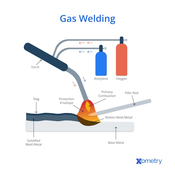

Gas welding uses the heat source from the combustion of flammable gas to melt and weld metal. Typically two pressurized gas cylinders are required: one for the flammable gas (fuel) and the second for oxygen. A gas torch is used to control the mixture of the fuel with oxygen and to control the resulting flame. The flame of the gas torch is applied manually to a metal surface to heat it and melt it for welding. Gas welding includes some variations, particularly in the fuel gas that is used. Acetylene is the most common, but hydrogen and LPG can also be used depending on the application.
How Does Gas Welding Work?
Gas welding works by creating a hot flame through the combustion of a flammable gas mixture. Two pressurized gases—fuel and oxygen—are fed to a handheld gas torch. The flow of each gas is adjusted at the torch handle. A nozzle is fitted at the outlet of the torch, where the gas mixture is ignited. The torch is also equipped with flashback arrestors.
Depending on the fuel being burned, and the oxygen:fuel ratio, the flame at the torch nozzle has slightly different characteristics. For the most common example of oxy-acetylene welding, a neutral flame is achieved when the ratio allows complete combustion. The flame has a hot (white) inner zone and a cooler (blue) outer zone. A reducing flame is achieved when the oxygen is cut back, and an oxidizing flame is achieved when the oxygen is increased past the neutral point.
The flame is directed at the metal to be welded to heat it. The combustion gases from the flame (such as carbon dioxide) provide a shield around the weld pool. Fusion between the metal components can take place without a filler material, but generally, a filler material is used. This may be in the form of a consumable wire that is fed continuously and melted into the weld pool to provide material to build up the weld. The flame is then moved on, and the metal can cool and solidify.
