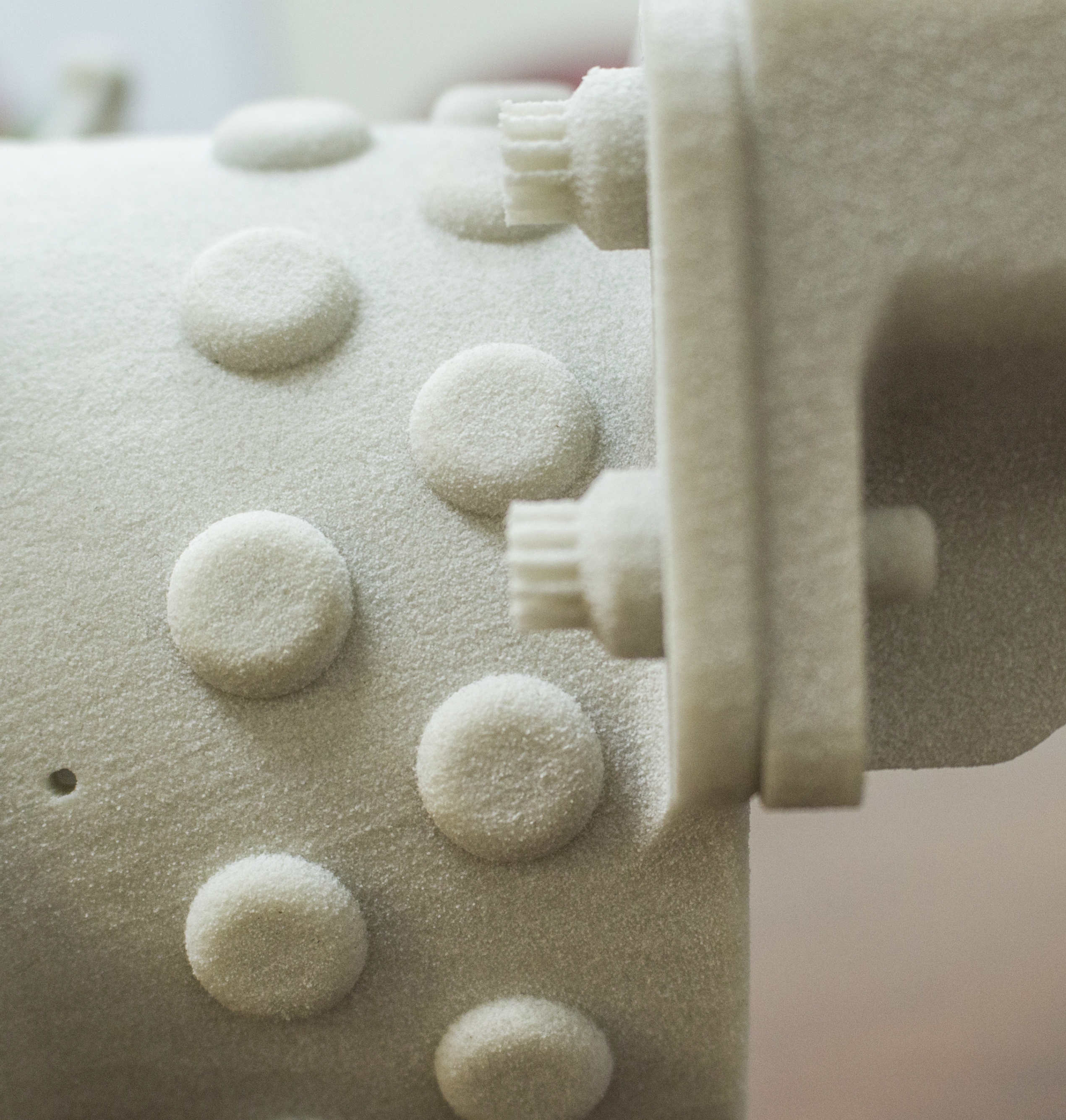

Binder Jetting is a powder bed-based additive manufacturing technology that creates parts by selectively depositing a binding agent onto a thin layer of powdered material. The process begins as the printer lays down a uniform layer of powder, typically plastic, metal, sand, or ceramic, on the build platform. A recoating blade is used to ensure that a precise layer of powder is distributed on the build platform. This is typically done by the recoater blade, transferring material from a powder storage bin next to the print area. The material in the storage bin is lifted, and the recoater blade sweeps the powder from the storage bin across the build platform at the required layer height. Next, an inkjet head moves over the powder and dispenses a binding agent over the powder in the shape of the part cross-section for the current layer. For full-color plastic parts, the binding agent also contains a colorant to create multiple-color parts.
The print bed then moves down by one layer height. The recoating blade distributes another layer of powder on top of the previous one, and the process continues. When binder jetting metals, the part must be sintered after printing to eliminate porosity and improve the mechanical strength. Alternatively, a low-melting-temperature metal powder like bronze can be mixed with the primary material. When the printed part is heated, the bronze will melt and fill the spaces between the primary metal alloy powder particles.

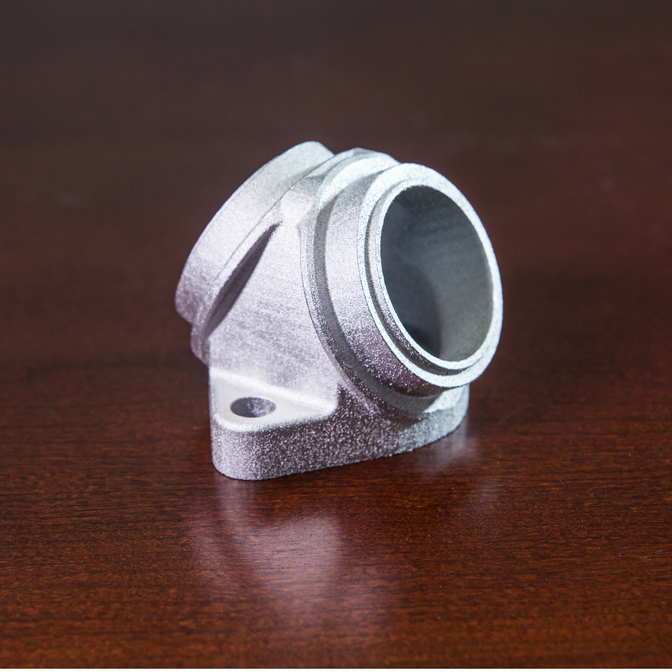

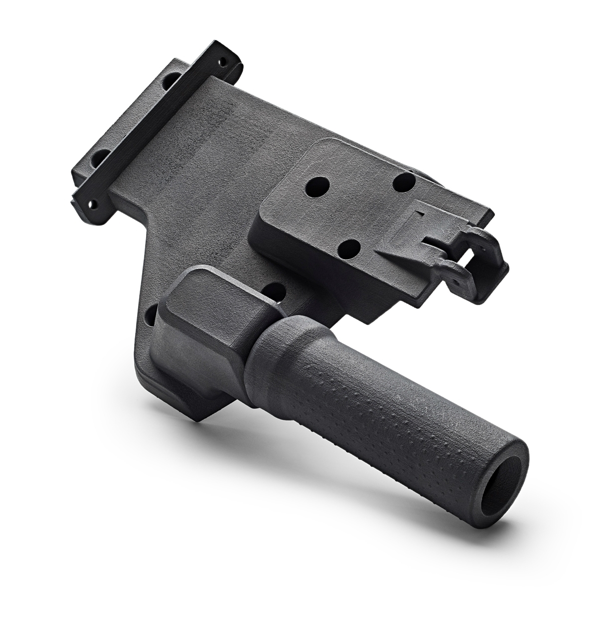

Powder bed fusion (PBF) refers to a range of additive manufacturing technologies that fuse powders using a high-powered focused energy source. The energy source can be a laser (SLM or DMLS) or an electron beam (EBM). Both metal and plastic powders can be used with PBF. The process works by first placing a thin layer of powder (often pre-heated) onto the build platform. This is achieved with a recoater blade to ensure layer height consistency. A focused energy beam then melts the powder particles to form the current cross-sectional layer of the part. The build platform then moves down by one layer. Another layer of powder is added, and the process repeats.
Higher-power energy beams are needed for metals, and an inert atmosphere is required for DMLS and SLM printing. For EBM, the build volume must be kept under a vacuum. PBF machines can print quickly, particularly if multiple-beam printers are used. EMB uses only one beam, but the beam can be redirected extremely rapidly, thereby simulating multi-beam functionality.

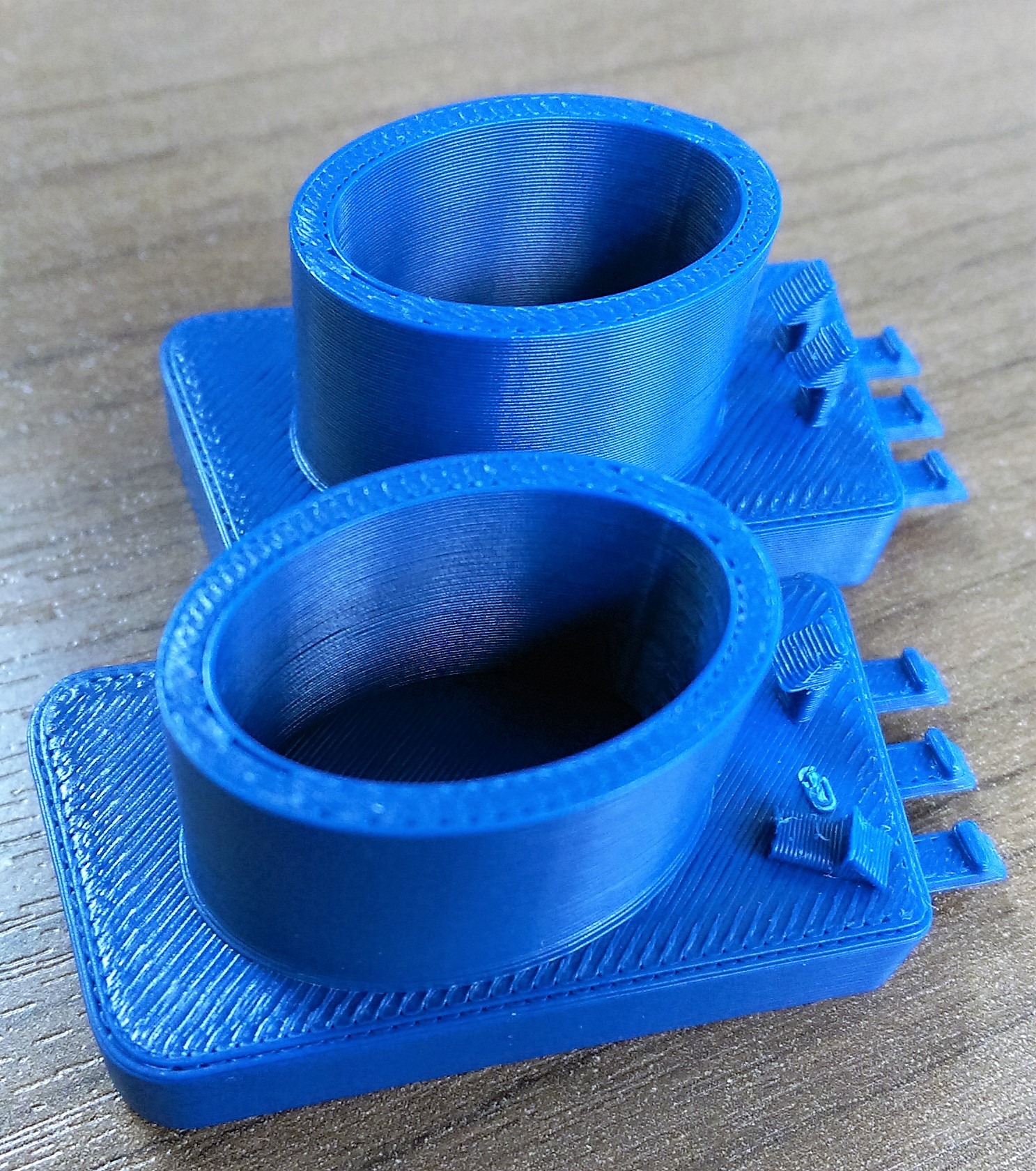

Material extrusion is one of the most well-known types of additive manufacturing, mainly due to its adoption by the consumer market. Material extrusion is often referred to as FDM (Fused Deposition Modeling), or FFF (Fused Filament Fabrication). The process works by directing a plastic filament from a supply spool, passing it through a heated chamber, and then out of a print nozzle. As the material exits the nozzle, it is deposited in the form of the current part cross-section on the build platform. Once a layer is complete, the print heads move up by one layer thickness. The process is repeated until the part is complete.
Thermoplastics and filled thermoplastics are the most typical raw materials used with this technology. However, metallic powder/polymer matrix materials can be used to create metal parts. They must be post-processed in a furnace to develop their final mechanical properties.
