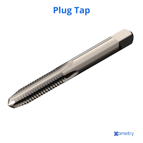

Plug Tap
A plug tap has a five-thread cutting chamfer that slowly cuts away material to create the thread, starting with the smaller diameter. They’re used when there is enough space at a blind hole’s bottom part, or to make through-holes. They make a more complete set of threads compared to taper taps, but aren’t as well suited to finishing threads in blind-holes as bottoming taps.

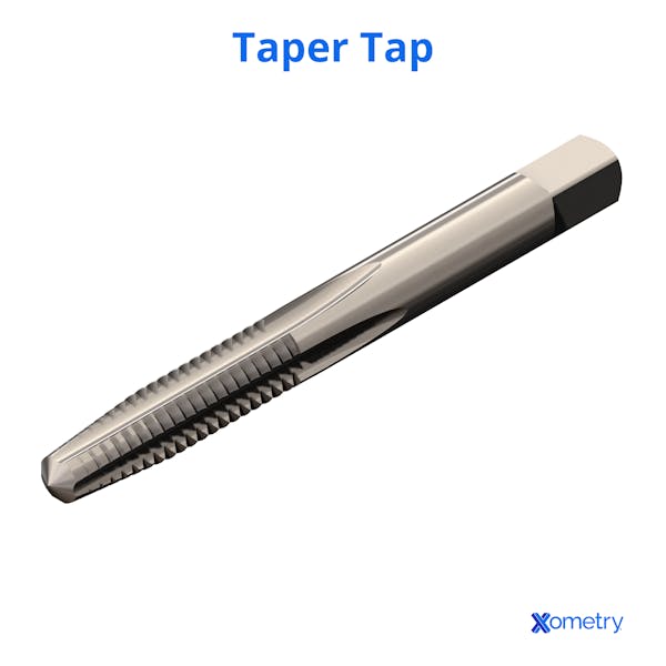

Taper Tap
These have nine-thread chamfers and the smallest diameter of any hand taps. Taper taps are typically the starting point for blind- or through-hole applications. One of their biggest advantages is they clear out most of the material early in the process. They shouldn’t be used for finishing the bottom of blind holes since they can leave incomplete threads.

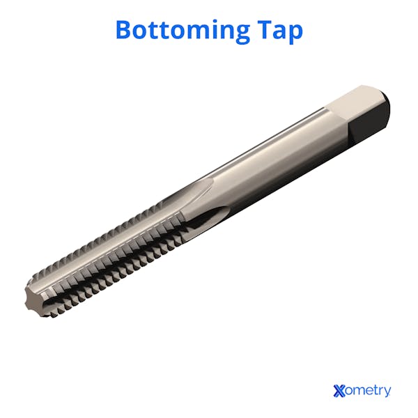

Bottoming Tap
A bottoming tap has the smallest thread chamfer (1.5 inches). It’s used to finish the end of a blind hole since it can get all the way to the bottom (unlike plug and taper), but isn’t good at removing most of the material from the hole (that’s what the other two are for).
A bottoming tap.
A bottoming tap.

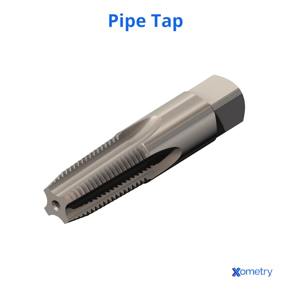

2. Pipe Tap
Pipe taps carve threads for pipes internally for pressure-tight joints. Some pipe taps are made for hydraulic and gas purposes, and others for mechanical joints and hose couplings. They have to be done more carefully than other types because they’re designed to mechanically seal a joint to add pressure and prevent leaks.
An NPT pipe tap.
An NPT pipe tap.

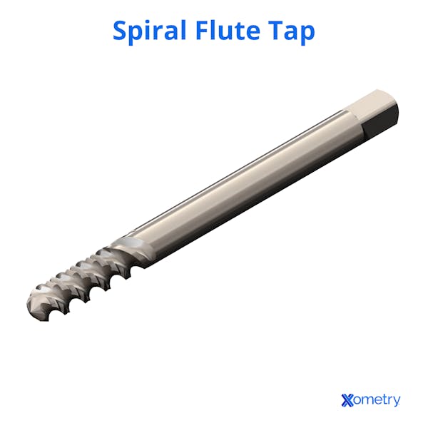

3. Spiral Flute Tap
The spiral flute tap has flutes wrapped around the axis in a spiral (helical) formation, making their cutting edge weaker than a hand tap’s. They’re most often used to tap thread into blind-holes and then pull the chippings back out of the hole.

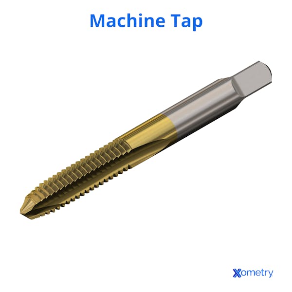

5. Machine Tap
The growing use of machinery in manufacturing has meant an increase in machine taps, too. These have to be durable and particularly resistant to wear. Automated machining processes (like CNC) use these taps to create both blind holes and through holes on hard materials, where spiral flute taps won’t be strong enough. Sometimes their cutting end is coated with titanium nitride (shown in the below image) to give it more wear resistance and increase its lifespan.

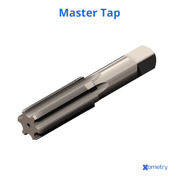

7. Master Tap
A master tap is used in many industries. They’re known for their universal ability and are typically used to cut clean threads in hard, strong materials. They’re not that dissimilar to taper taps but have 7–10 flutes (as opposed to a taper tap’s 3–7) and more cutting faces.

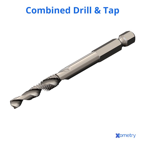

8. Combined Drill and Tap
A combined drill and tap lets the user drill the hole and tap threads all at once without having to switch tools. This saves both time and money on production drilling jobs. It’s helical flute-shaped and works on a host of materials and metals, like iron and brass.
A combined drill and tap.

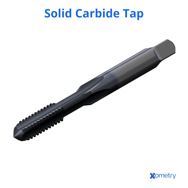

9. Solid Carbide Tap
Solid carbide taps are made of composite material and last a long time in all sorts of environments. They’re very hard and wear-resistant so are used on harder materials, including sintered, ultra-fine tungsten carbides.
A solid carbide tap.

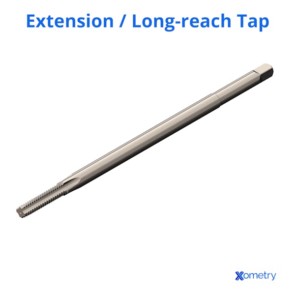

10. Extension Tap
Extension taps are similar to hand taps. Their long shanks make them useful for accessing hard-to-reach holes, like a pulley hub.

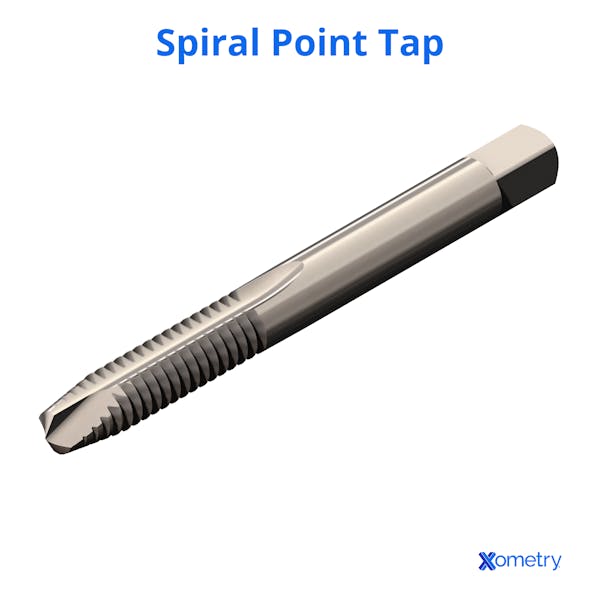

13. Spiral Point Tap
These taps are strong and made to work faster than regular taps on hard materials, and don’t need as much power, either. They make shallow grooves that can remove more metal in one go. Some feel they are similar to straight flute taps since they share the same general shape, but they have different cutting faces.
A spiral point tap.
A spiral point tap.

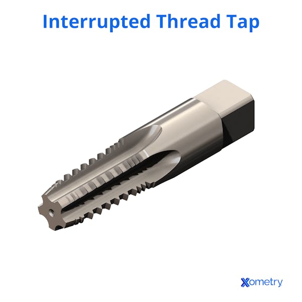

15. Interrupted Thread Tap
This type of tap only has a tooth for every other thread. It’s designed to provide better chip extraction. Removing every other tooth helps with breaking up the chips. It also gives more room, both for the chip to clear out and the lubricant to enter.
An interrupted thread tap.
