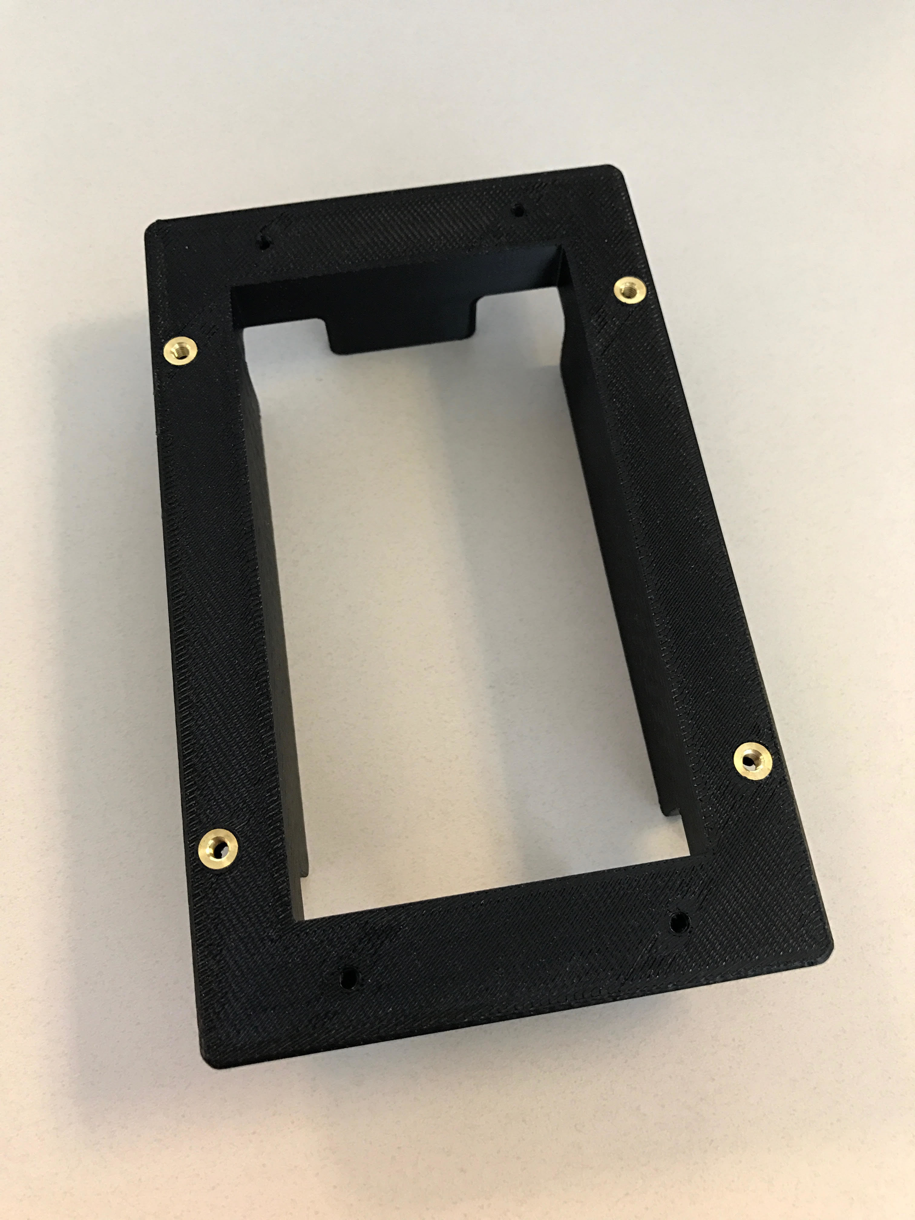

The company’s transition to additive manufacturing began with one project when they were curious to see how a 3D printed part would look and perform on the production floor. The part tested was a small fused deposition modeling (FDM) connector, which to this day is still performing as desired.

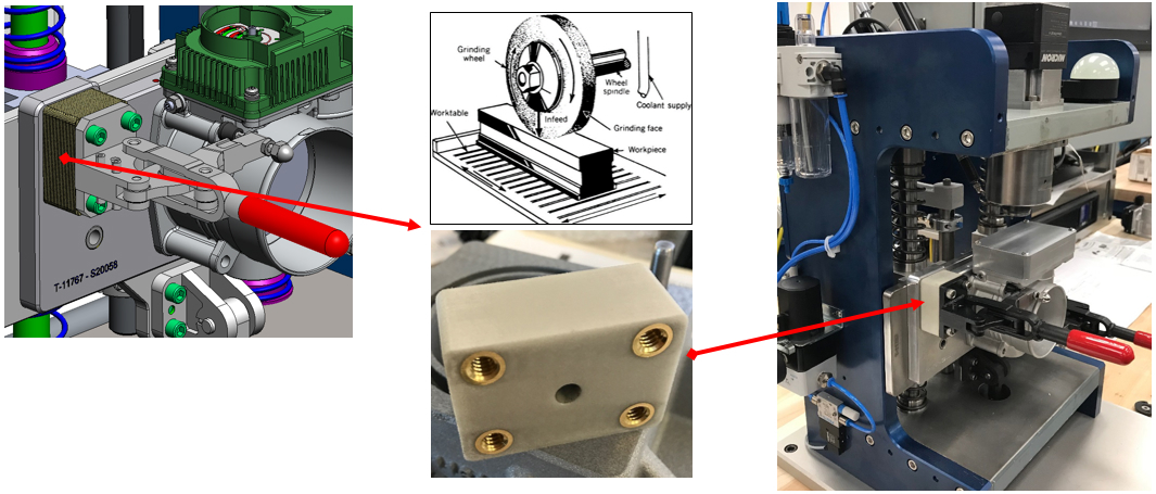

The company operates with cost as a large driving factor. They have to consider: are we willing to redesign this part that’s been on the production floor for many years, and then interrupt production to replace it? With additive manufacturing, the answer becomes much simpler.
Gianluca has noted that their biggest breakthrough is the fact that additive manufacturing gives them the freedom to design innovative, ergonomic and highly customized jigs and fixtures for a variety of uses. He then leverages Topology Optimization and simulation software to explore new geometries within the design space to ultimately increase part performance while reducing its cost and lead time.
“Additive manufacturing is not just for prototyping. These tools are used on a busy and demanding automotive production floor and last 3+ years while being used over 200 times a day. It’s a beautiful scenario.”

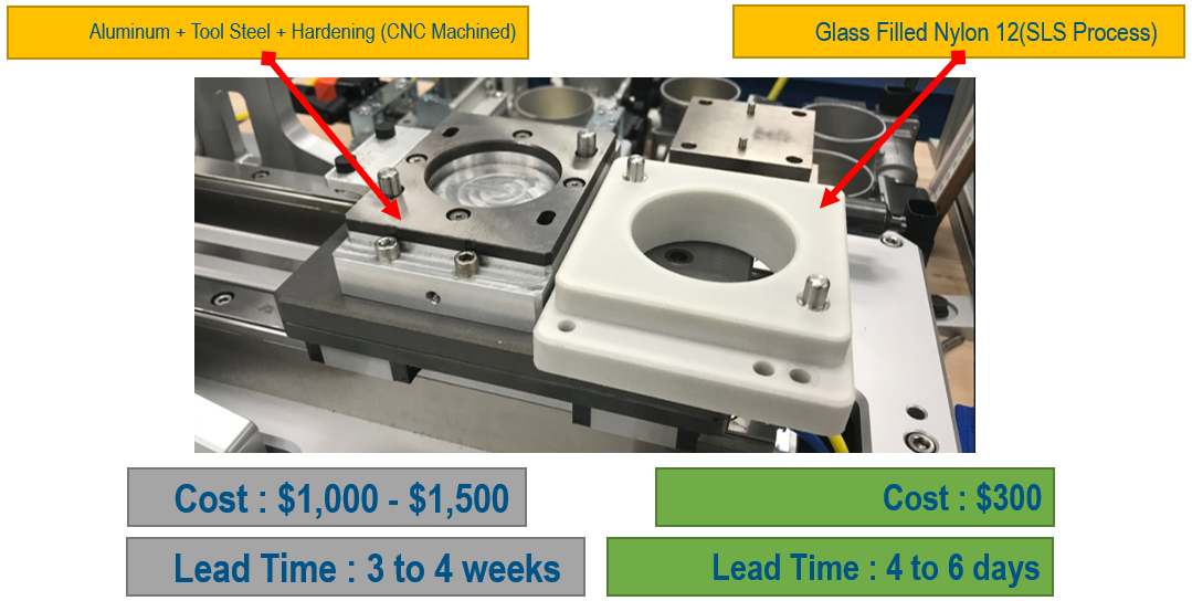

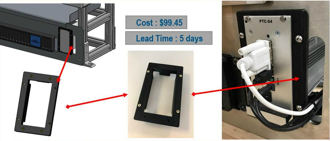

The company previously relied on in-house CNC Machining which could cost upwards of $1,500 per unit. With additive manufacturing, they can reduce the cost to $200 per unit and within 10 days it can be quoted, ordered, delivered, and on their shop floor. The cost of each part is reduced by 50-85% after switching from CNC Machining to additive manufacturing, and the lead time of their parts by 60-80%.
