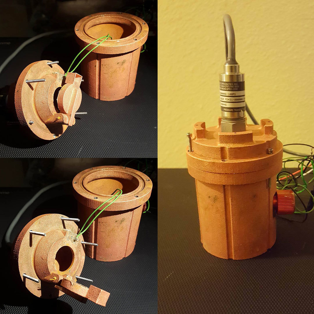

So Team Original Gravity got to work. Funded by a grant from Qualcomm, they began designing and engineering prototypes of their moon brewer. There were certainly a number of obstacles they needed overcome before making such an instrument work. “Our biggest challenge was coming up with our valve design,” said Ashari. “We have a valve between two chambers to separate the wort and the yeast, and basically once the valve opens, the yeast and the wort mix, and the yeast consumes the sugars and then the CO2 will come out, which is beer.” While the moon’s lower gravity would have a minimal impact, the team was most worried about the wide variation in temperatures the yeast would be subjected to. “We had to calculate the ideal ratio of food to canister volume such that the beer we’d incorporate would have the perfect amount of carbonation, which would reduce the possibility of exploding.”
Team Original Gravity turned to Xometry to complete the prototyping process. “We used it to fabricate our canister design out of nylon and plated it with copper and nickel to ensure air tightness,” said Ashari. “In school we’ve all learned how to use 3D printing, but we always use plastics or acrylics, basic materials. Working with Xometry really expanded our horizons when it came to using materials like nylon, copper plating, and nickel. These are materials we’d never worked with before, and that was really cool to see.”
