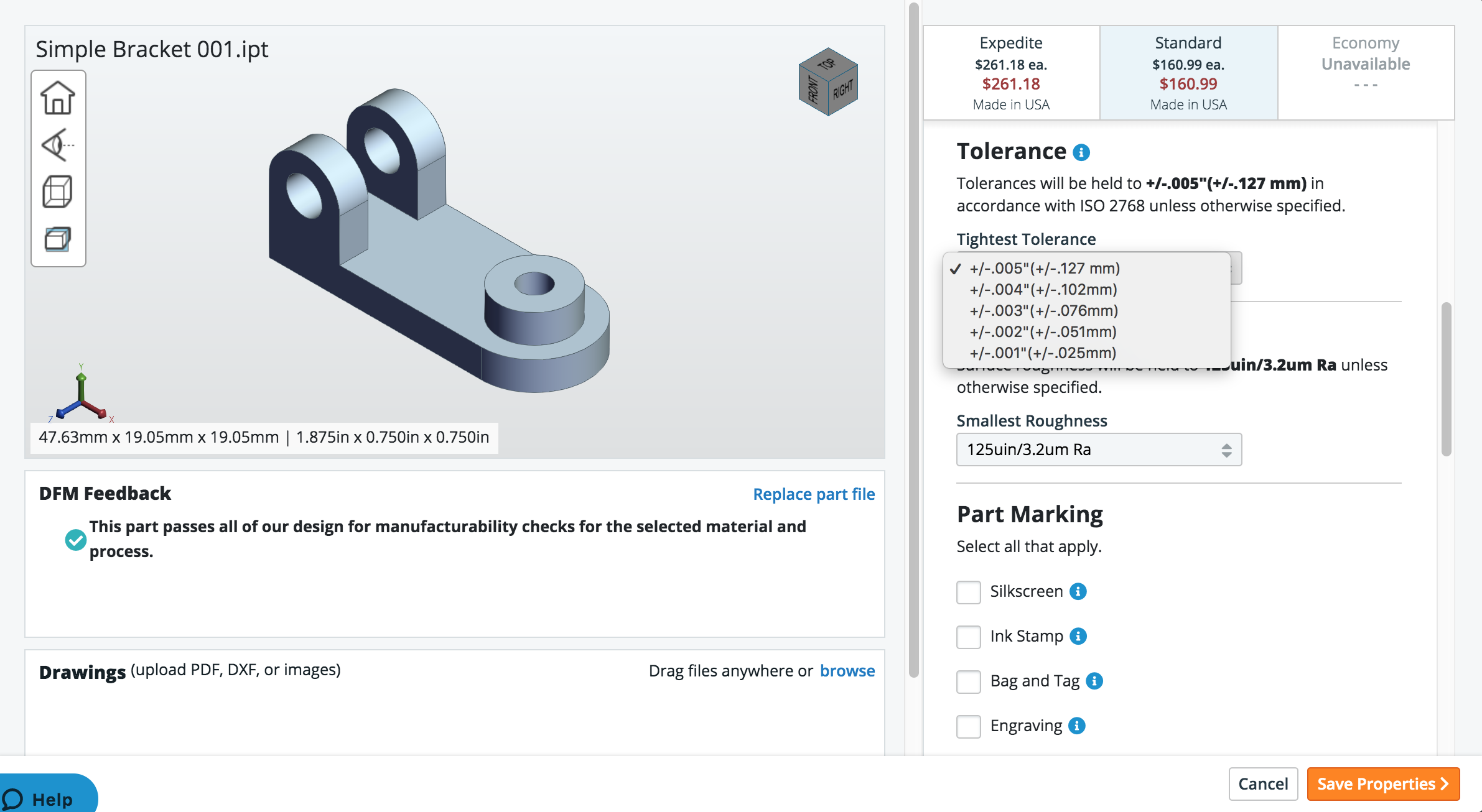

Tolerance is the acceptable range for a dimension which is determined by the designer based on the form, fit and function of a part. Unless specifically called out by the designer, the standard tolerance used by Xometry for CNC machining is +/- .005” for metal parts and +/- .010” for plastic parts.

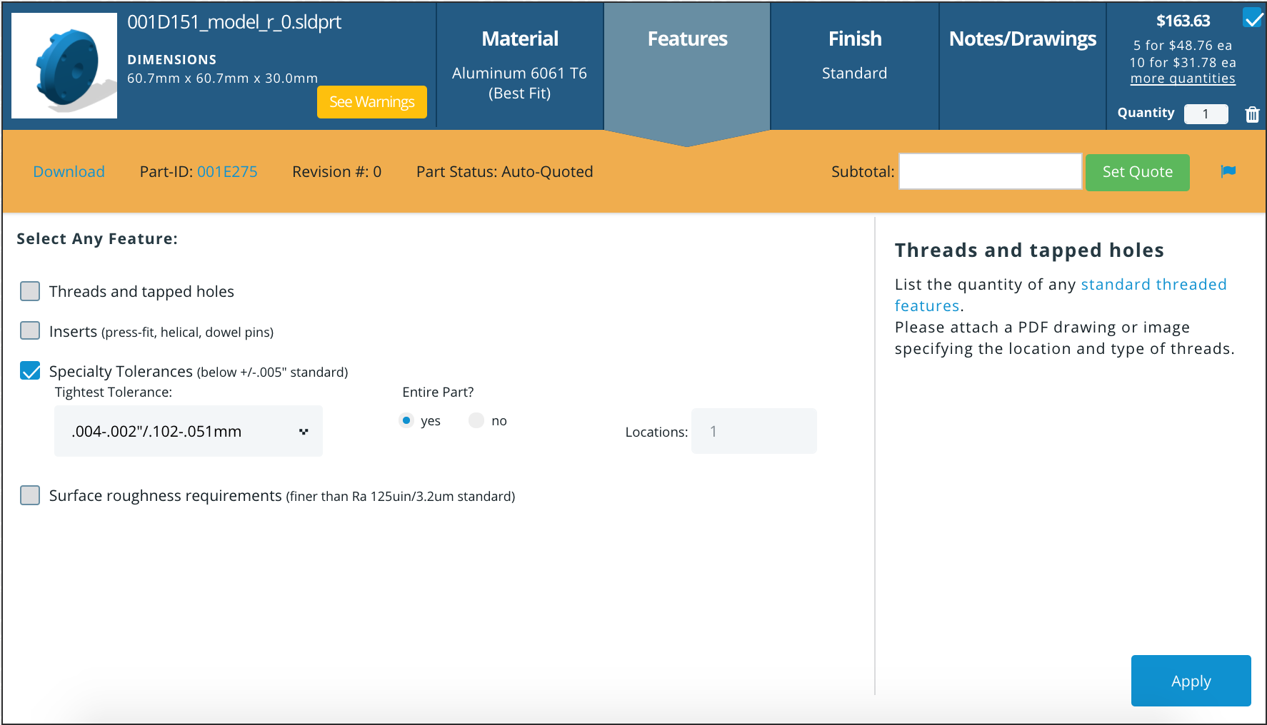

If tighter tolerances (less than the standard, e.g. +/- .002”) are required, the information must be communicated as to which dimensions require a more narrow range. This can be specified at the part modification level in our instant quoting platform. As a point of reference, a piece of paper is about 0.003” thick.

You can toggle between different tolerances in the Xometry Instant Quoting Engine
