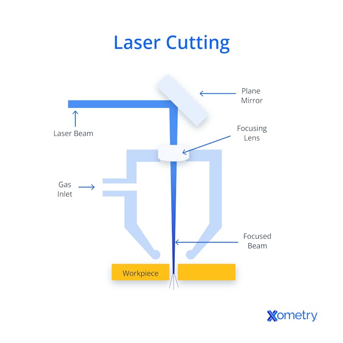

Laser Cutting Process: How Laser Cutting Works
A laser cutter works by directing a very small-diameter, high-energy light beam vertically down onto a sheet or plate of material to cut it into a 2-dimensional profile by moving the laser in the X and Y directions along the machine bed. This beam melts or burns through the material in a pattern determined by a set of computer-generated instructions called G-code. A high-pressure stream of gas is sometimes used to blow the molten material out of the bottom of the material being cut. This process is done so that the waste material does not remain in the cut area and solidifies after the beam has moved on. In other cases, the laser beam simply vaporizes the material. The method of generating the laser beam differs between technologies, but in principle, they all follow the steps listed below:
laser cutting diagram
The laser cutting process.

Step 4: Beam Direction and Focusing
As the beam exits the laser medium after amplification, it is directed either through a fiber optic cable (in the case of a fiber laser) or via a series of mirrors (for CO2 and Nd:YAG lasers). The beam is directed down into the sheet material through a lens that focuses the laser energy into a very small diameter to create a localized high-energy point. Note that the laser only has a single focus point of high intensity; the entire beam does not have the same cutting intensity. The difference in intensity is the reason why laser cutters are limited in the thickness of material they can cut, as the laser intensity drops off above and below the focus point.
Step 5: Material Cutting
Once the beam has been focused, it will begin to melt or vaporize the material. In the case of non-melting materials, like wood, the laser will burn through the material. With metals, the laser beam will melt the material, and a high-pressure jet of gas will blow the molten material away from the cut. The gas can either be inert nitrogen or argon or it can be oxygen which is used to accelerate the cutting process of steel.
