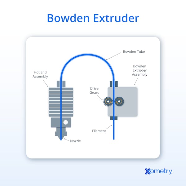

How Does a Bowden Extruder Work?
The drive mechanisms vary, using either a gear or pinch wheel to convert the rotation of the feed or drive motor into a linear progression of the filament. As the filament is pushed through the feed mechanism, it is delivered under compression into the Bowden tube. That pressure is countered by the resistance at the hot end, where it is melted and dispensed.
The Bowden tube guides the filament while minimizing buckling. The filament feeds through since the tube is longitudinally rigid. Although the tube provides lateral support, flexible filaments may still experience buckling due to insufficient constraint. The filament feeds through since the tube is longitudinally rigid. It is normal for the filament to want to curve because of the compressive force applied to it. This causes the filament to press against the inside of the tube, causing extra friction.
An illustration of a Bowden extruder and its components.
