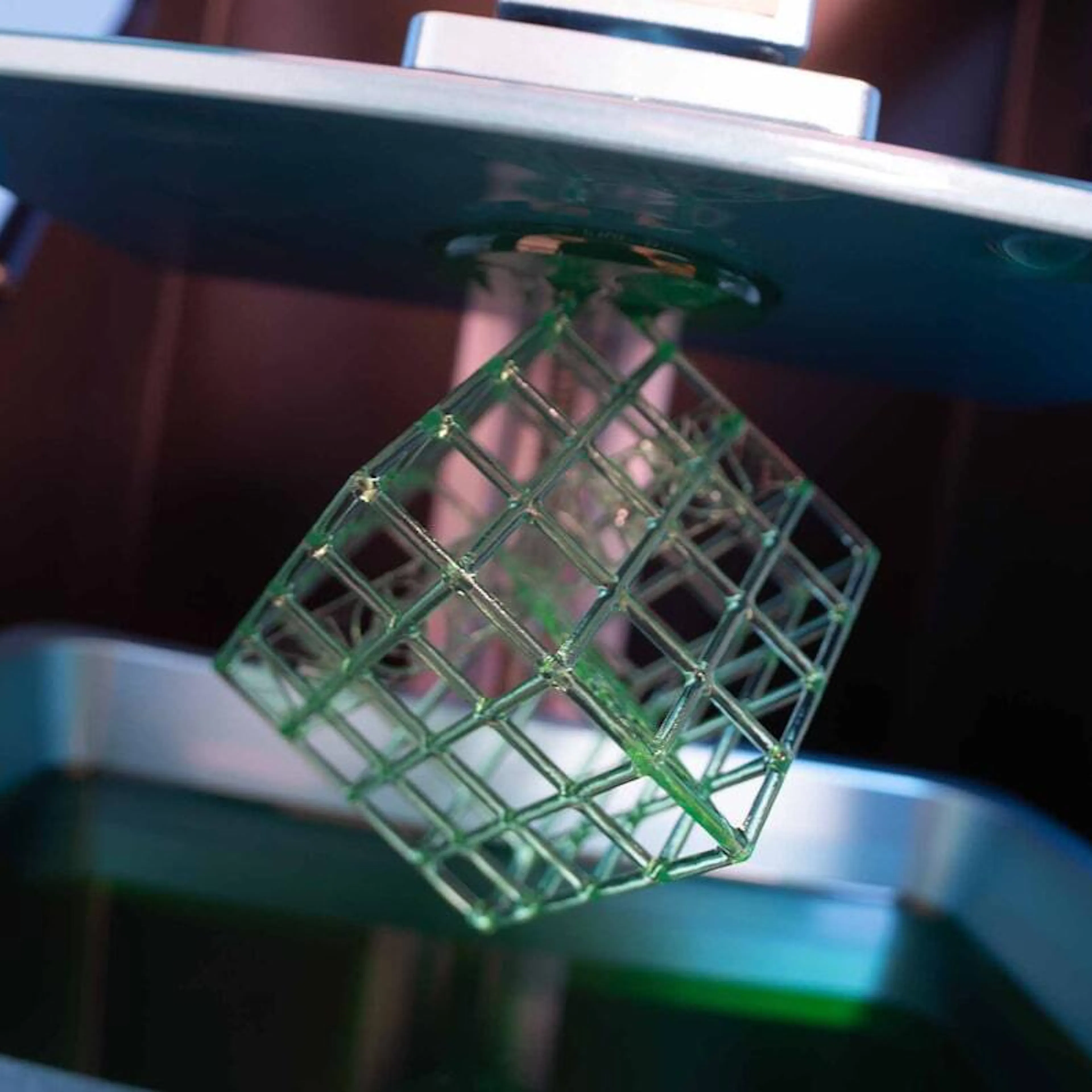

DLP (Digital Light Processing) and LCD (Liquid Crystal Display) printers are resin-based (or vat-polymerization) 3D printing technologies. Both processes work thanks to a photosensitive resin that is stored in a tank and cured by a light source. This light source is used to solidify the resin. It creates a printed product layer-by-layer on a construction platform that slowly rises from the tank as the part forms. The main difference when comparing DLP vs. LCD is the type of light source. DLP uses a digital projector to cure the resin while LCD uses UV LEDs that shine through an LCD screen.
These technologies also differ in terms of printing speed and accuracy. On average, DLP machines print faster because their lights are more intense. They also perform well in terms of small-scale accuracy. High-end LCD printers, on the other hand, are generally more accurate when printing larger models.
