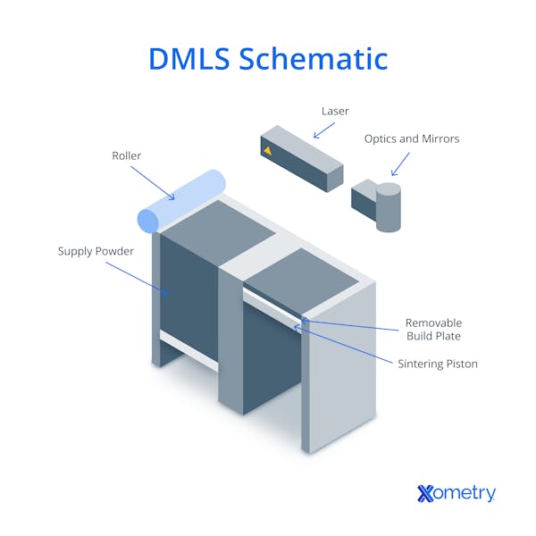

DMLS is a powder bed fusion 3D printing technology used to manufacture metal parts. EOS first commercialized the technology in 1995 and is the owner of the DMLS trademark. DMLS works by selectively melting a metal or metal alloy powder with a high-powered laser beam, which is typically referred to as a fiber laser. The laser beam traces out the cross-section of a part layer. It then melts the metal particles together. The print bed then moves down, and another layer of metal powder is applied. Inert gas occupies the build chamber to prevent oxidation during printing. EBM printers also need an oxidation-free environment, but they achieve this with a vacuum chamber instead. To learn more, see our full guide on DMLS.
A diagram of DMLS
A diagram of DMLS

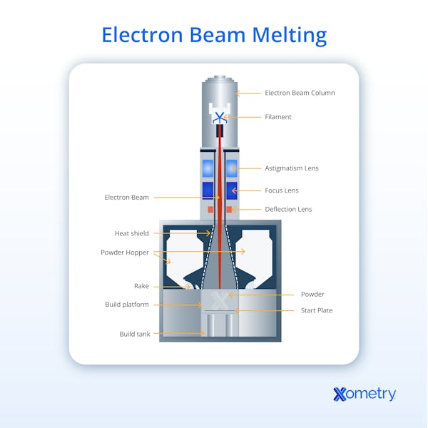

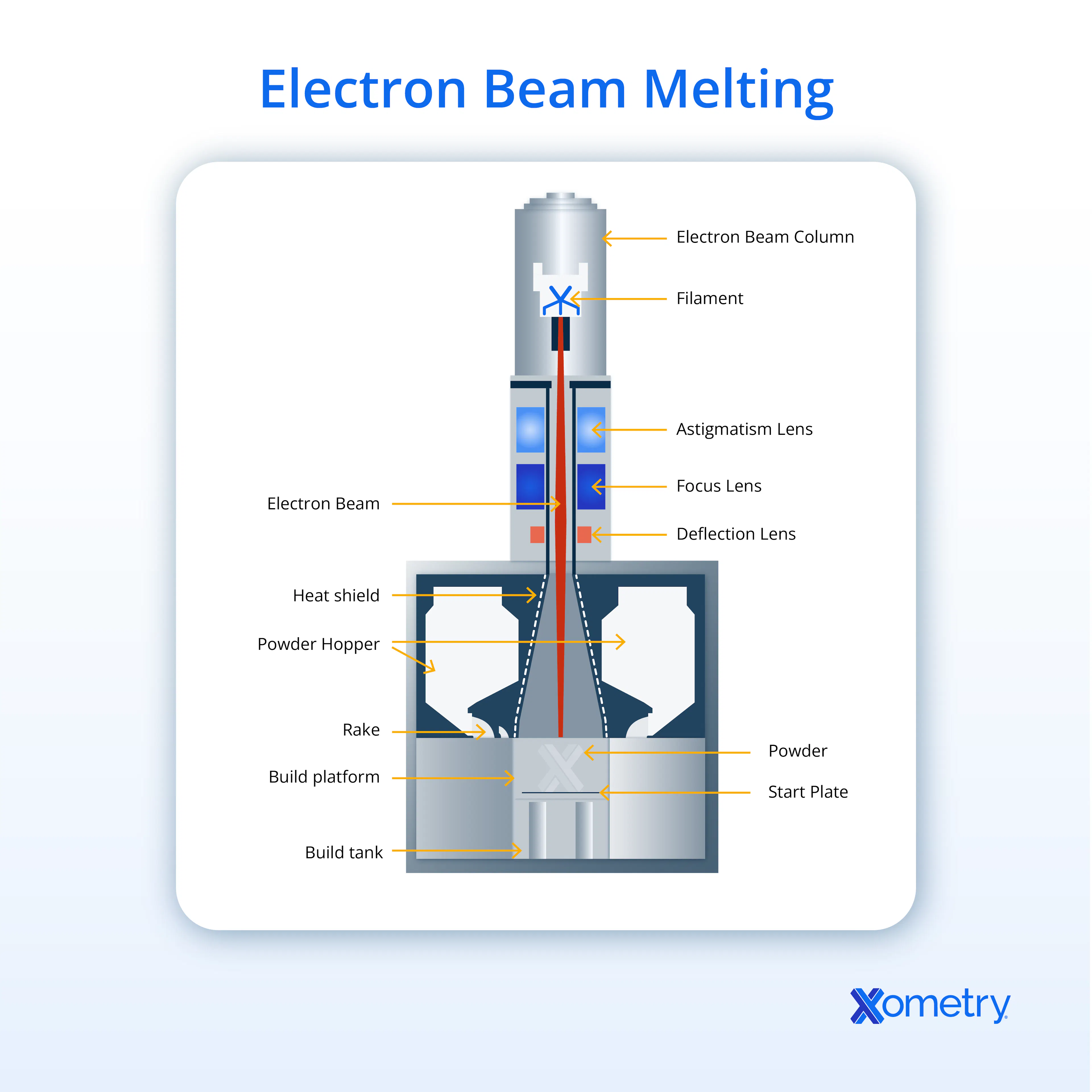

EBM works by selectively melting a metal or metal alloy powder with a focused beam of high-energy electrons. That is, instead of energized photons like those in a laser, EBM makes use of energized electrons. The electron beam traces out the cross-section of a part layer and melts the metal particles together. After each layer is formed, the print bed moves down and another layer of metal powder is applied. EBM must take place within a vacuum to prevent oxidation due to the extremely high temperatures generated by EBM.
Electron beam melting diagram
