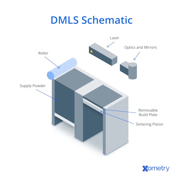

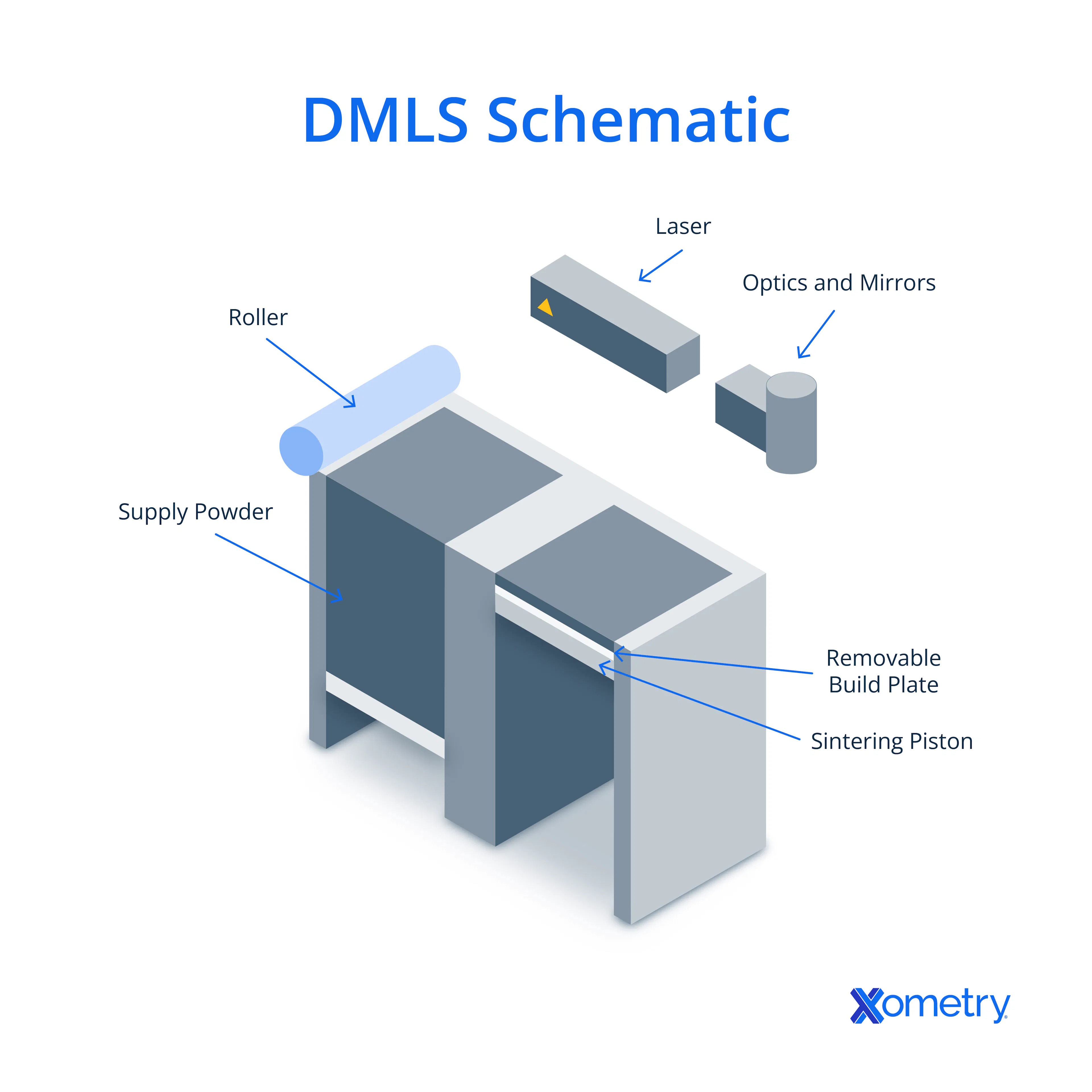

It usually uses a high-powered fiber laser beam that traces each layer’s cross-section and melts the particles of metal together. When each layer is printed, the bed moves down so power can be applied to a new layer on top, and then it starts again. During the process, the build chamber is filled with inert gas to stop any oxidation. The following image breaks down what a DMLS printer typically looks like:
DMLS Schematic
DMLS Schematic

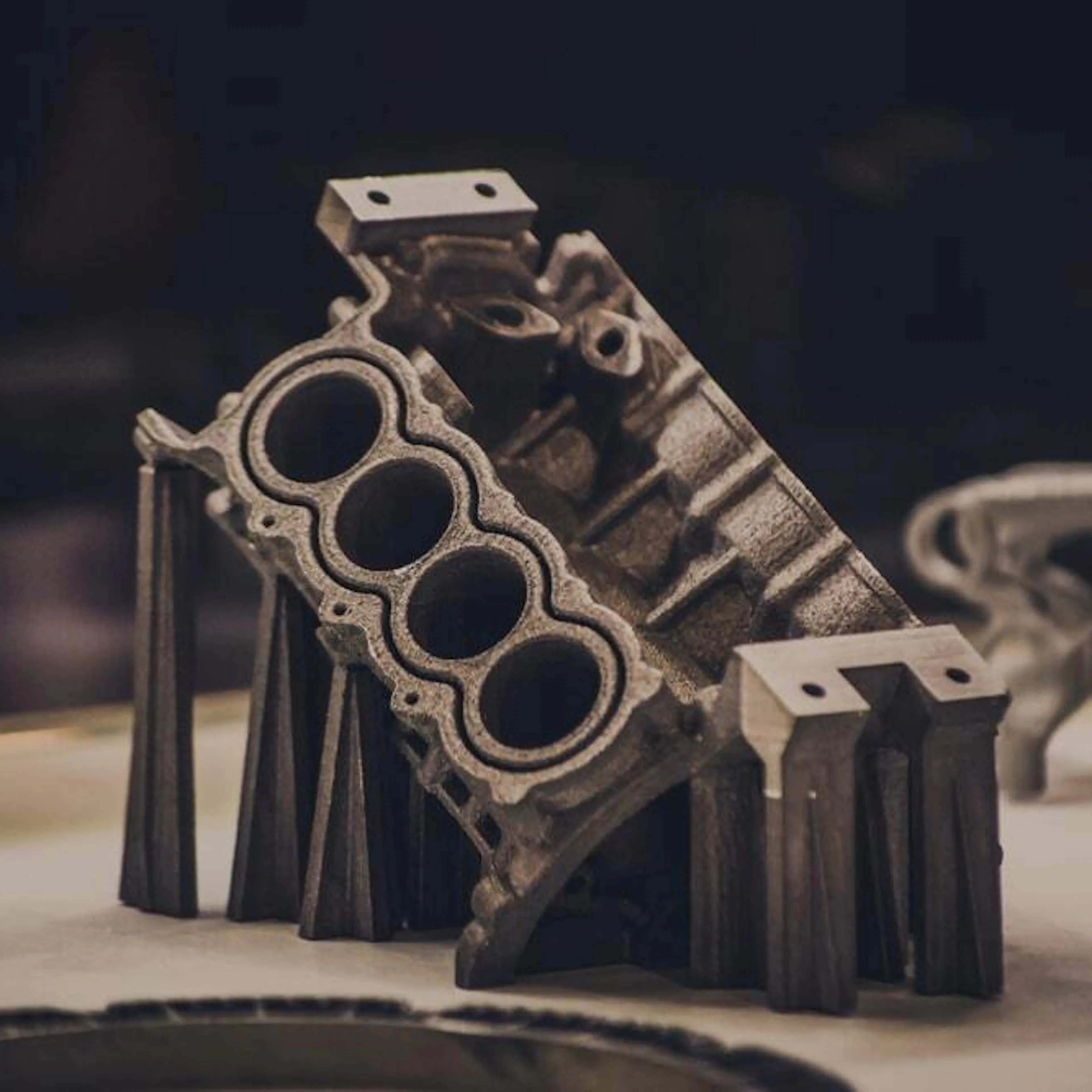

This 3D printing method has some awesome benefits, including the fact it makes very accurate and detailed parts and is compatible with a huge range of materials, even more than SLM, the method we’ll consider later on. The downsides to using DMLS, though, are that it can be rather slow because it uses less power and fewer lasers than SLM, and it can only create small melt pools, so it can’t print very thick layers. The following image shows you what parts being made in a DMLS machine look like:
